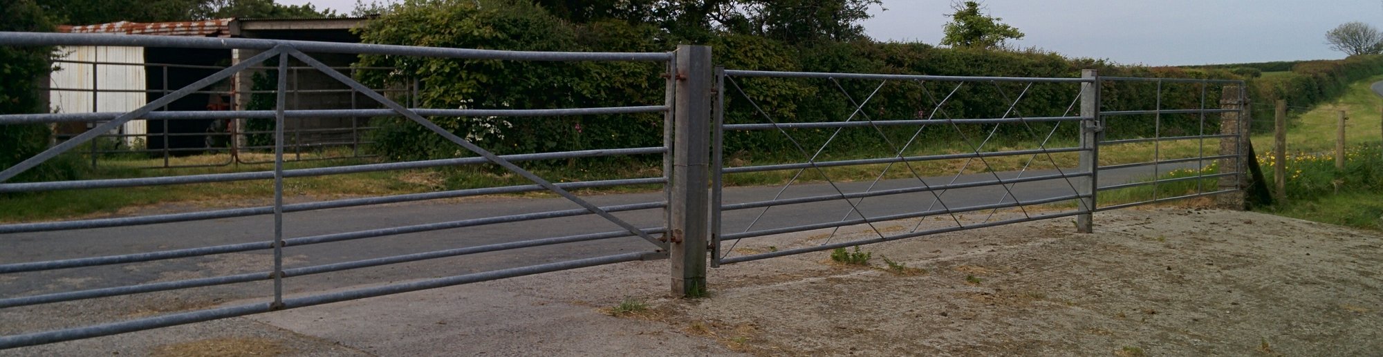

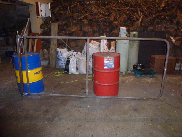

I'm making a gate as above. The heel is 50x50x2.5 rhs & the outer hoop is dia 42x2.5 tube (an old gate frame). The middle upright will be replaced with 25x25x2 rhs & there will be a horizontal bar half way up, again in 25x25x2 rhs.
This will be sheeted in light gauge box profile & hung on a girder. I'm worried about the gate drooping over time so I'm adding diagonal braces in 25x25x2 rhs but not sure of the best way.
There are 4 options I can think of ie like v or ^ or / / or \ \ .
The gate is 110" long & 48" high.
