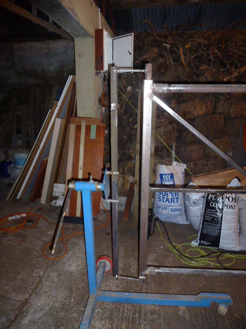

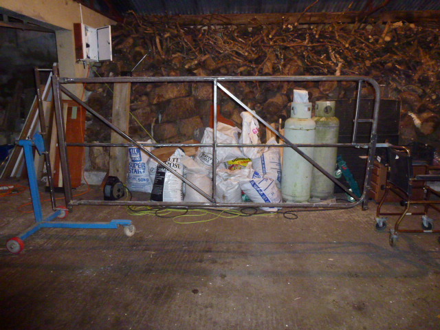

You’re adding the brace in to triangulate the frame to minimise the frame being able to distort out of square when hung. I can’t see how it makes any difference which way you put the brace. If the load is great enough to buckle it one way, then it will buckle it the other just the same if you changed the brace position. Where you put the brace will make no difference to the loads on the hinges.
