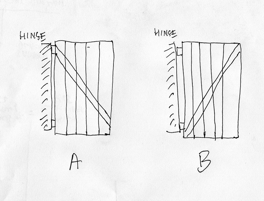

High at latch side to low at hinge side
Been done like that on ledge and brace doors for a very long time for good reason.
On wood doors yes to keep the joints in compression.
So the pressure is on the face not the fixing nail, pin, dowel.
High at the hinge keeps the joints in compression - post #13 ???
No if it's high on the hinge end the brace is under tension not compression
Low at the hinge keeps the wood joints in compression.
B is the stronger way with wood. Or steel.View attachment 180001
The force on the boards is downwards, under their own weight.
Low at the hinge (b) the brace will try to become horizontal, thus tending to force the boards apart.
High at the hinge (a) the brace will try to become vertical, forcing the boards together (in compression)
B is the stonger. If you look at a fully boarded gate they are done with a midrail and the bottom brace is into the hinge up to the latch. The top section is likewise and the braces are v cut to nessle firmly into the corners of the E framingView attachment 180001
