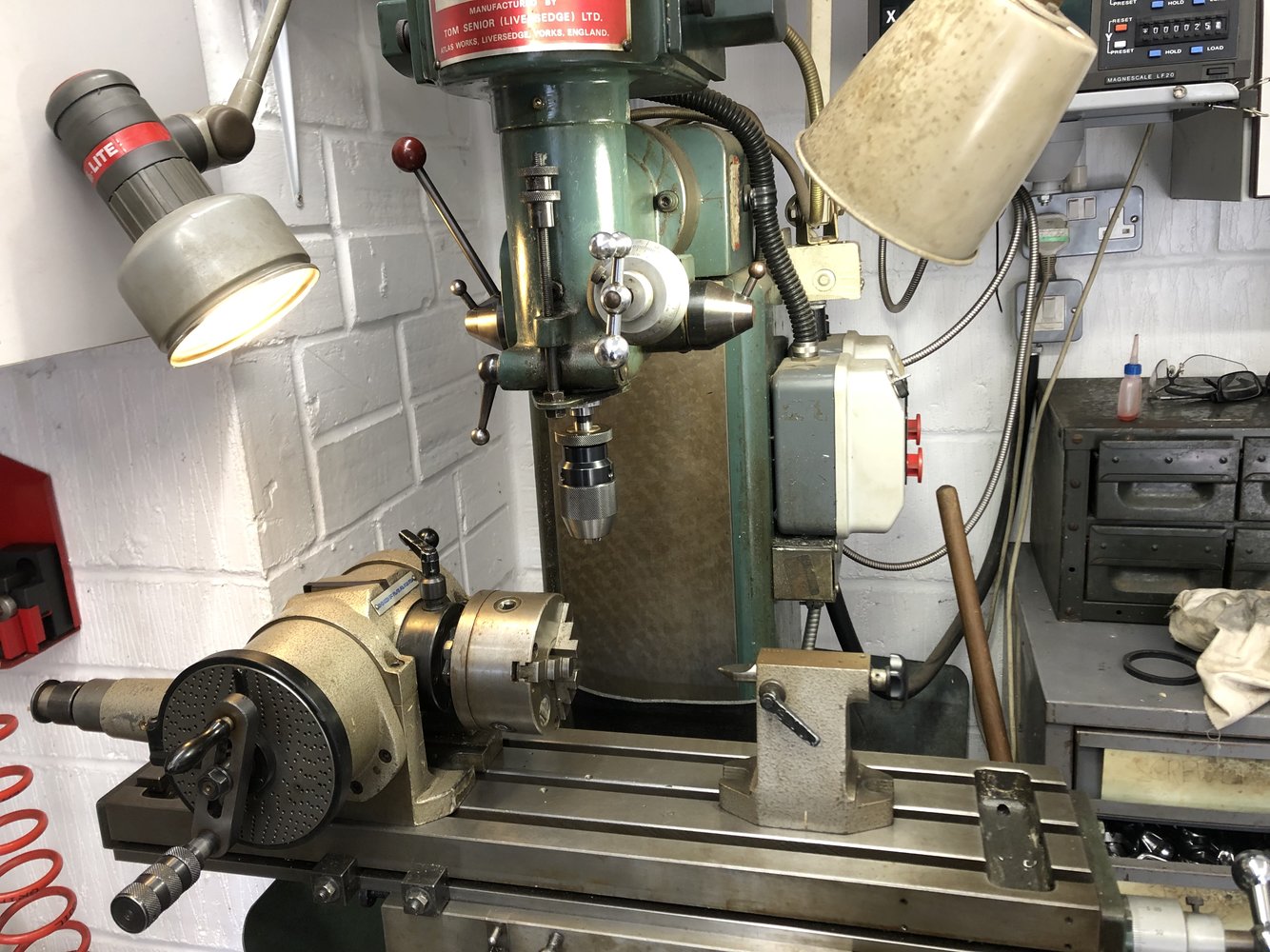

I would be using a 4 jaw independent chuck for gear cutting.

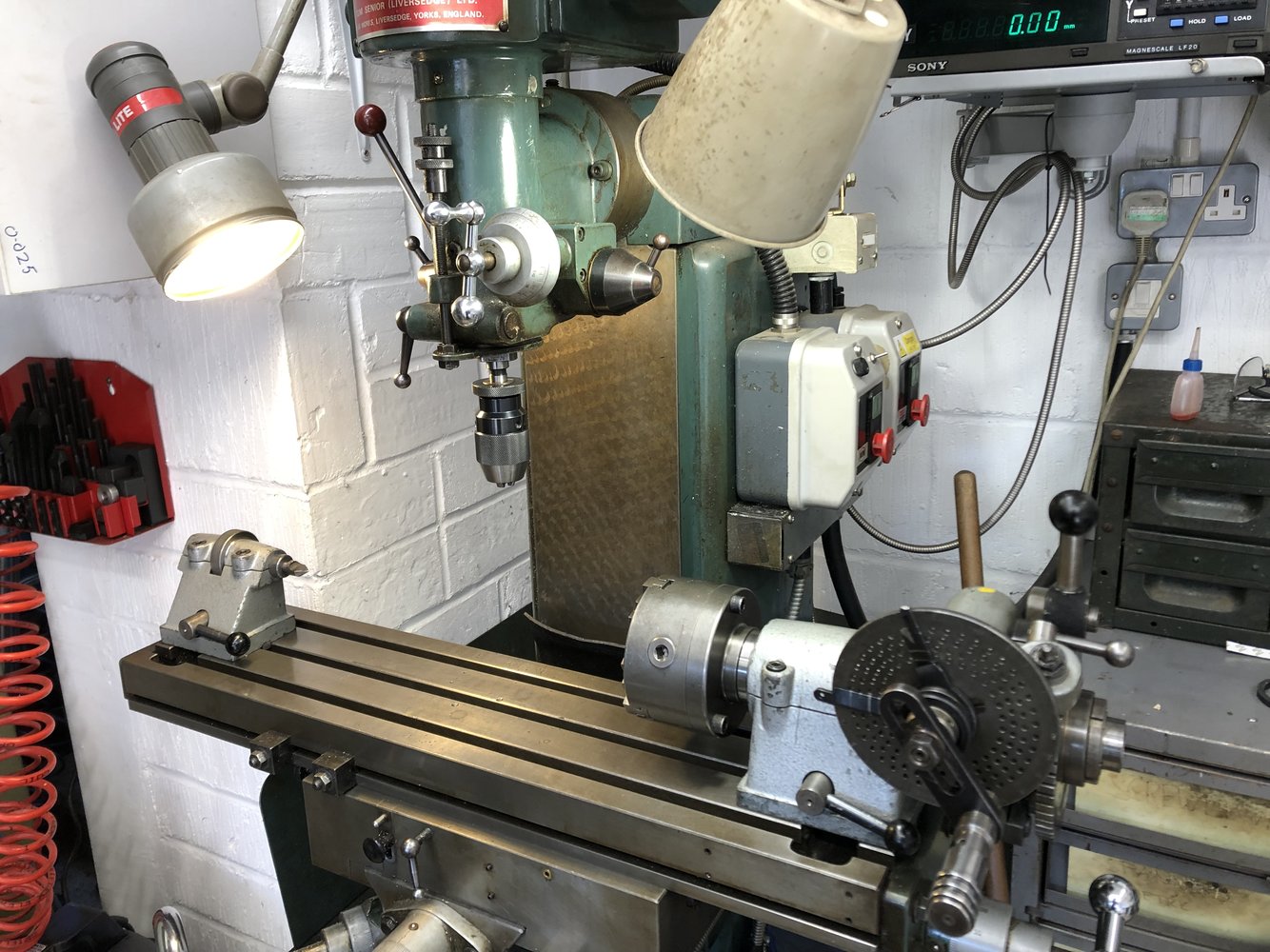

Thanks for that Graham, I suspect I will do similar.A nice table, and compete too. I have the same setup and it's worked well for me. I used a 2MT to Boxford adaptor, but you do lose about 3/4" height that way.

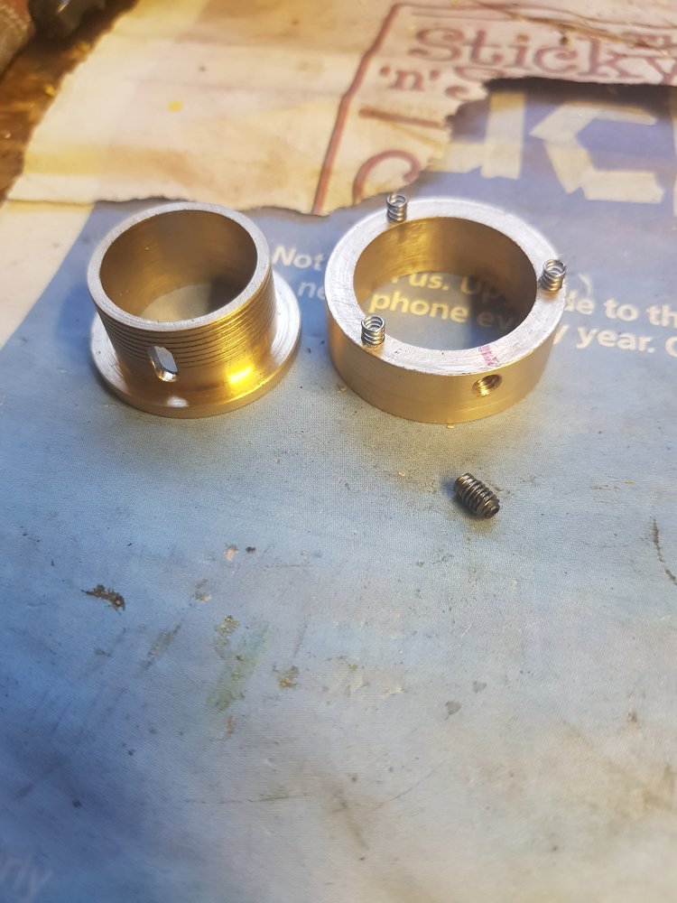

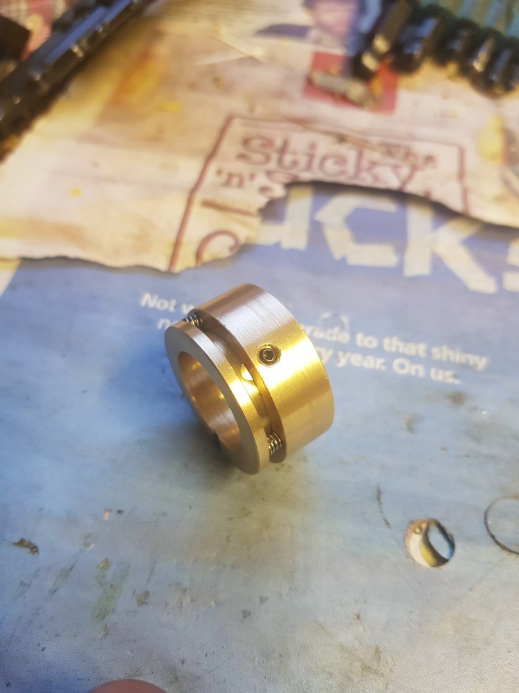

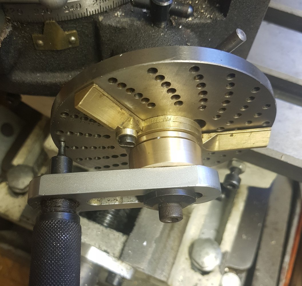

The wavy washer for the sector arms didn't work very well for me. I came up with a completely over- designed remedy for that

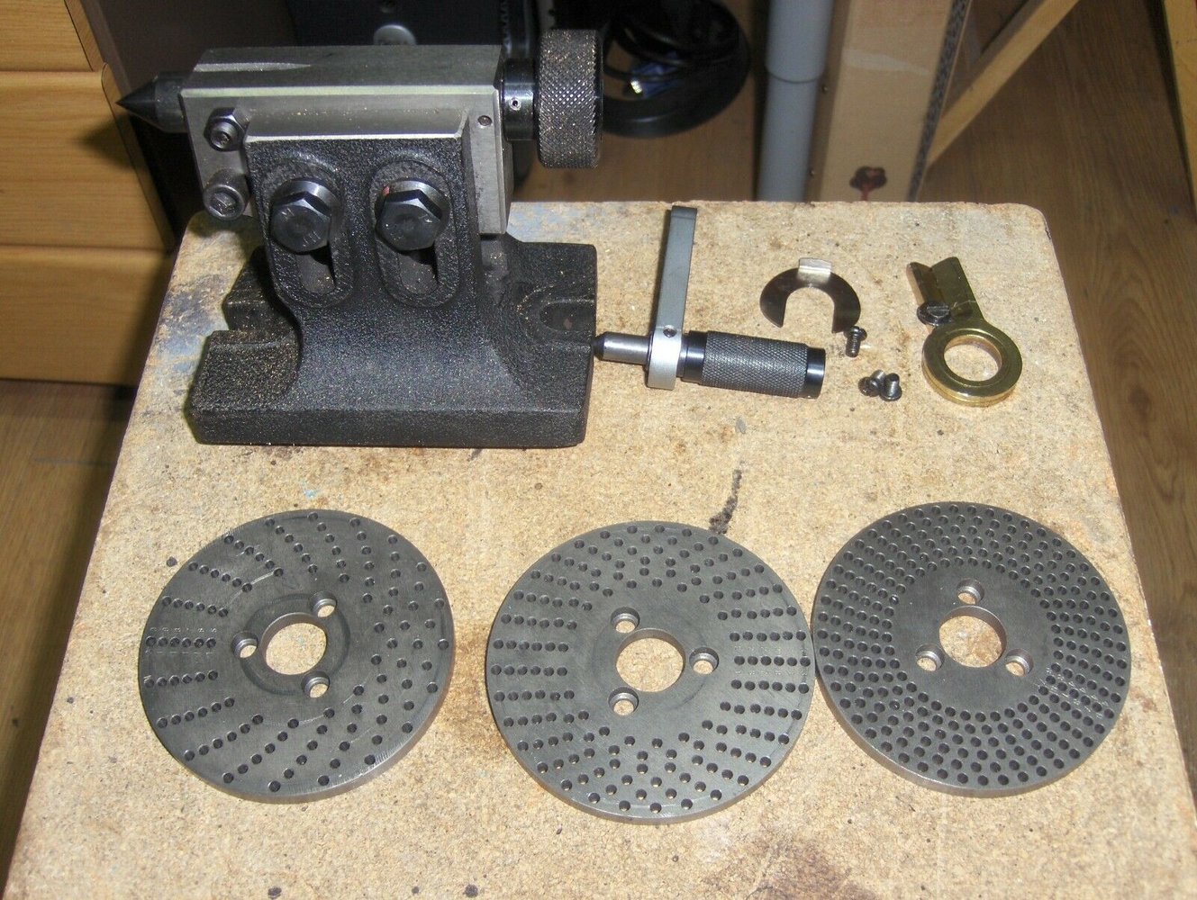

View attachment 339024View attachment 339025View attachment 339026

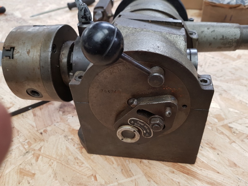

I stripped and cleaned it as well. There was, I seem to recall, some traces of casting sand inside. Mine wasn't new, but had sat in someone's shed for a few years with minimal or no work. Also played around with an O arrangement to seal the shaft.

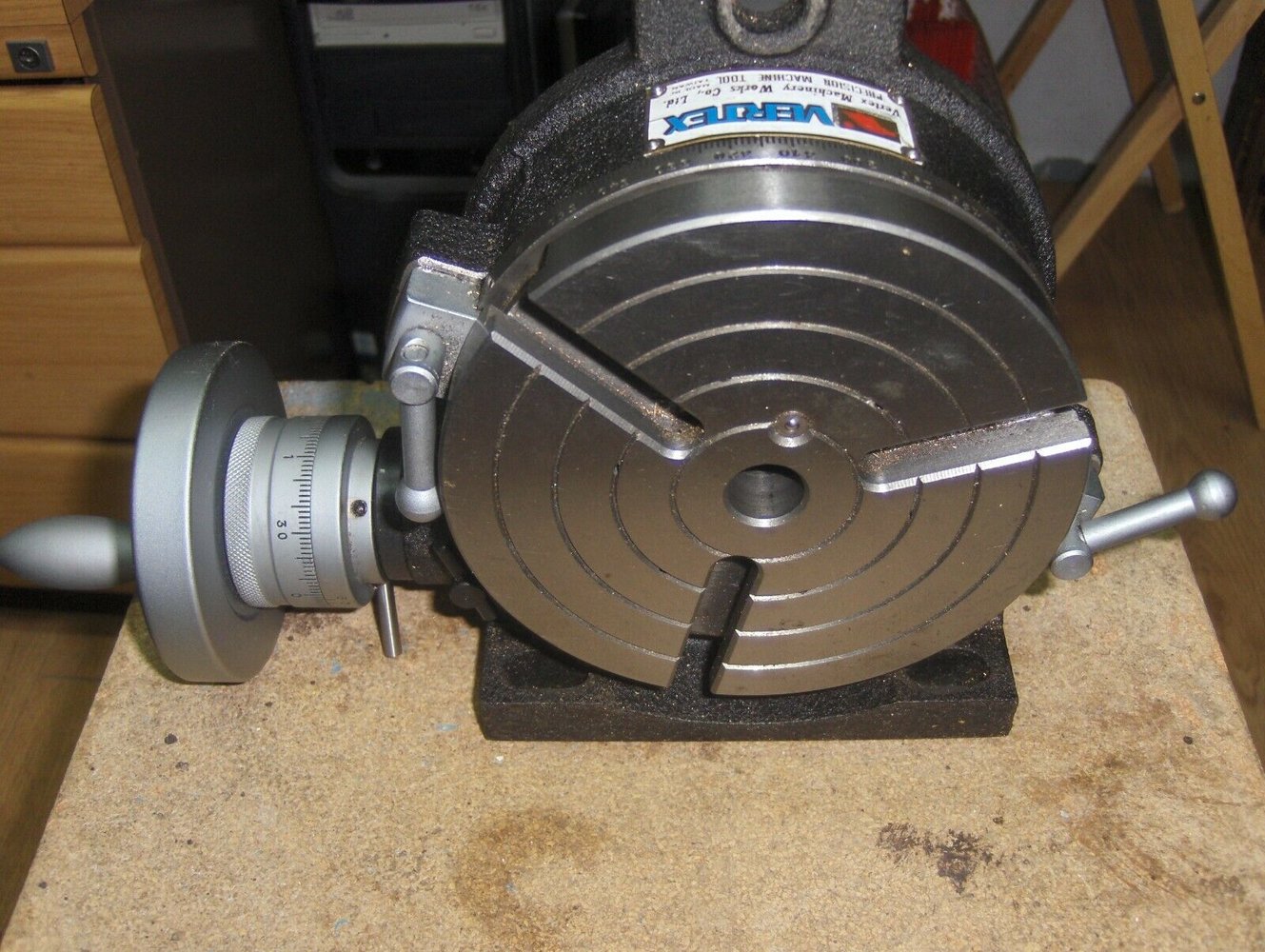

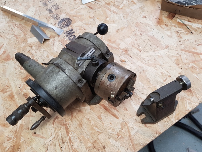

It is labelled made in Taiwan, so I may be lucky.It will likely be better if the tag indicates made in Taiwan rather than China. They are the older ones.
Both mine were made in Taiwan, one with three T-slots and the other with four.
I still don’t use mine for heavy circular milling duties - they are not as robust as some much older European variants - so I do most machining by plunge cuts whenever possible.

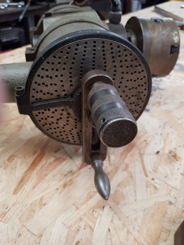

Do not trust the table of settings. Some contained the odd fault - and it would likely be something important when you eventually find out! I calculate all my increments - it is a mathematical doddle, once you realise how easy it is.
I have fitted one of mine to a base plate because they don‘t fit my table slot-spacing.

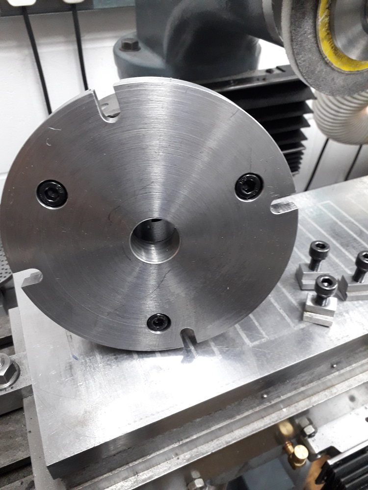

I think a 125mm (5") chuck will suit.
Funny, I was looking at http://www.rotagriponline.com/index...tegory_id=235&option=com_virtuemart&Itemid=293 jaw - Just put a front mounting chuck on, eg:
4 jaw will need a plate making most likely.
