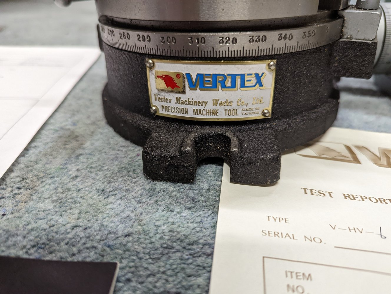

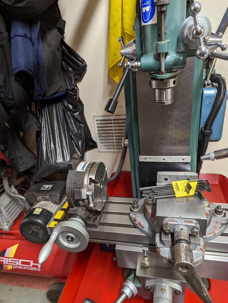

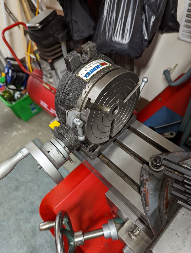

Also make sure you wear your reading glasses when setting it all up. Trust me when I say a 29 tooth wheel and a 28 one look very similar. And you dont realise until your finished.My bed only has two T-slots (the Centec), so the spacing was not close enough. Taiwanese was considered less good, compared to British engineering and Japanese offerings - at that time. Of course, China has since taken over a lot of the supply. Taiwanese is definitely considered better than chinese.
