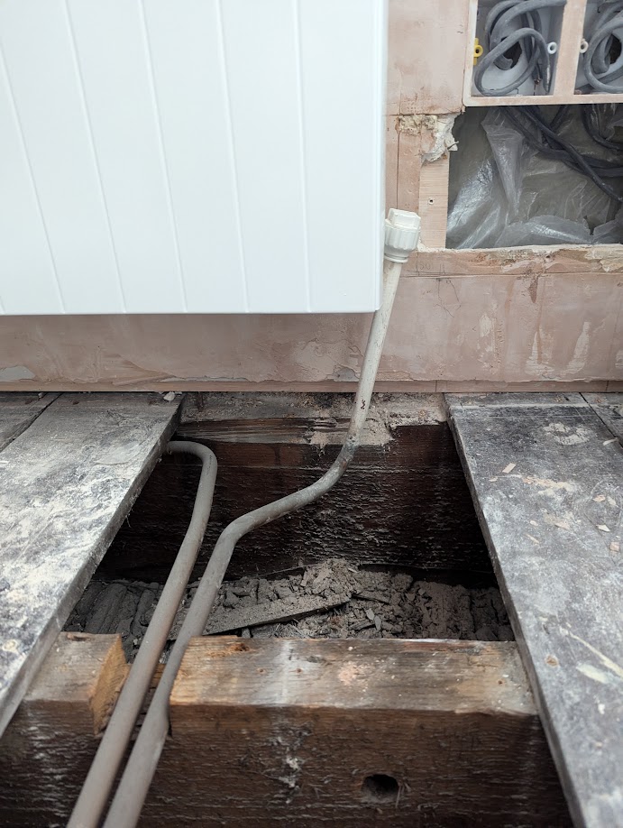

YesI agree, cut and re solder with bendsBetter off cutting adding made bends if you don't want to buy a bender and solder new in if you pull it about when the system is running your lighlty to get nocking noises with the pipes under stress

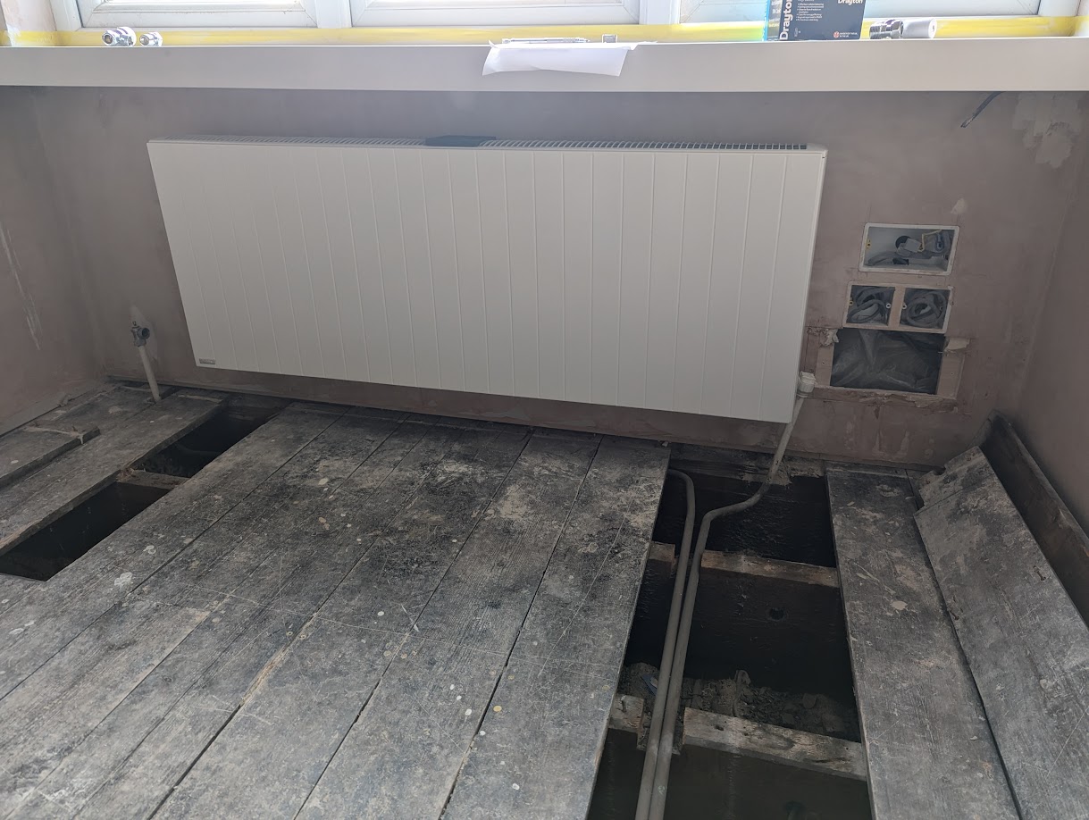

I think what that means is if you try to pull or bend in to shape the existing you run the risk of distorting the pipe, (while unlikely but not unknown ), and the pipe knocking on the underside of the floorboard or joist.What do you mean?

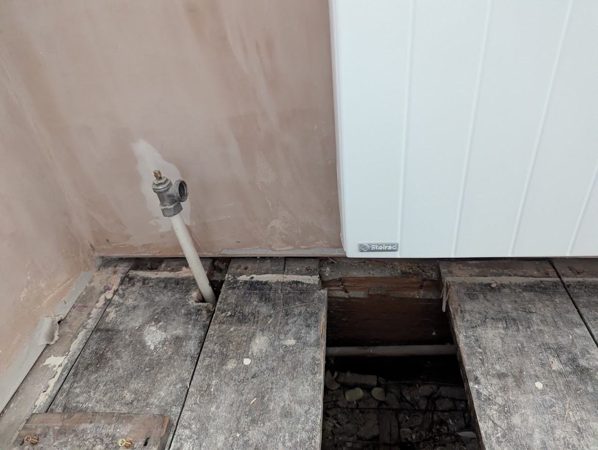

Well, yeah. This is new territory for me. I don't have any plumbing experience or specific tools. I don't know best practice, I can only go off what I see. Everything here looks like it's bent, so I can only assume bending new pipe is the way forward. I didn't even know a bending spring existed for copper pipe, so forgive me for my lack of knowledge. I want to make a good job of it, so I can only act on it when someone pipes up and tells me what I need to do.jeesus a spring for a fiver at screwfix a few couplings and an elbow and a bit of pipe is it worth pondering and farting about![]()
Ok thanks, that makes sense. There are a few knocks and bangs from the floor at times when the heating is on, I've always wondered what causes that.I think what that means is if you try to pull or bend in to shape the existing you run the risk of distorting the pipe, (while unlikely but not unknown ), and the pipe knocking on the underside of the floorboard or joist.

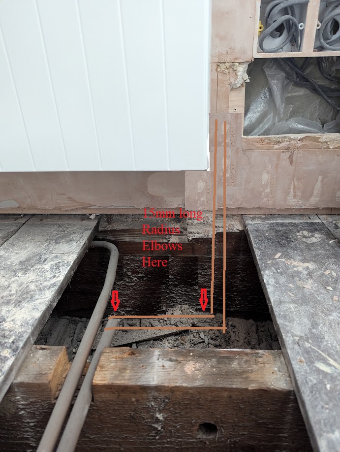

I altered your image, forgive my cutting and pasting, the simplest method would be to cut pipe where indicated, 3 elbows, problem sorted, but not short elbows, long radius ones, it's a lot of elbows on the pipe, it shouldn't be an issue but a lot of elbows.
Another method if you don't want to buy a spring is to fashion a sweeping bend from one of these, and better.
