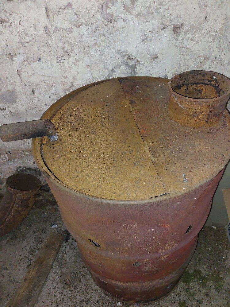

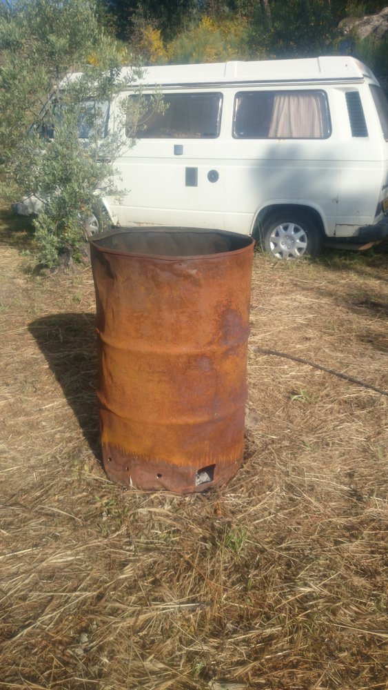

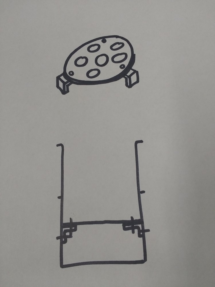

The lid will soon warp or burn through. Here's one I made earlier, more than a little agricultural but can kick out some flame, should have put some baffle plates in to slow the heat down and stop it disappearing up the chimney.For a raised grid, if I drilled the cut out lid with a hole saw to make like a big mesh, then anchored it to the side of the drum with cleats/angle brackets, would it still warp?
grid no good
angle iron will even bend with hot ashes but it will last longer
cutting bottom off no base to think about as its all hot ashes

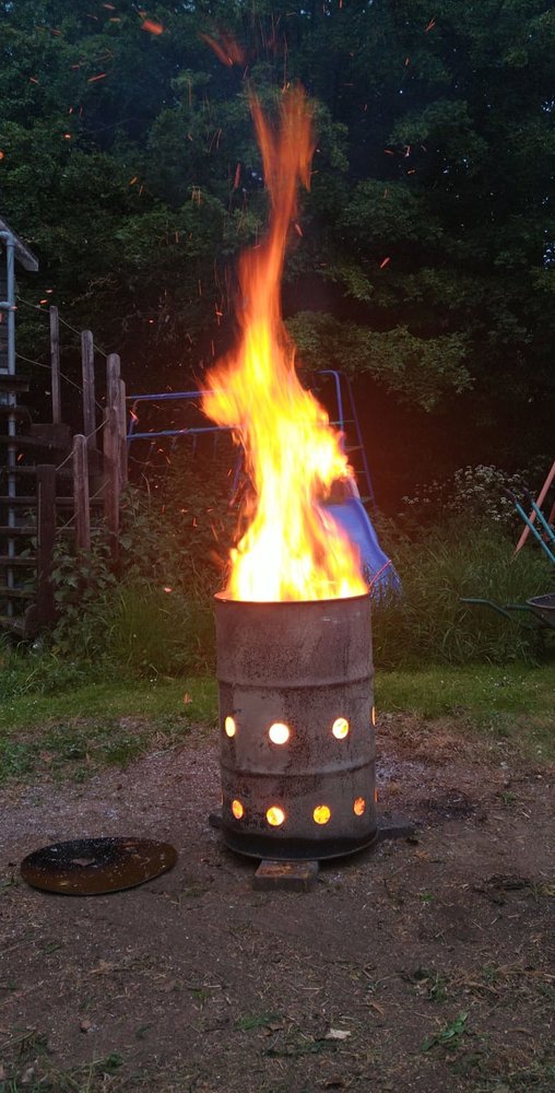

No need to overthink this, free old washer drum or drier with some more holes punched in it, set on handful of bricks for grate, good to go. Replace with another from always available thrown out machine if gets too tatty, one beer job to extract with a little electric impact gun.
