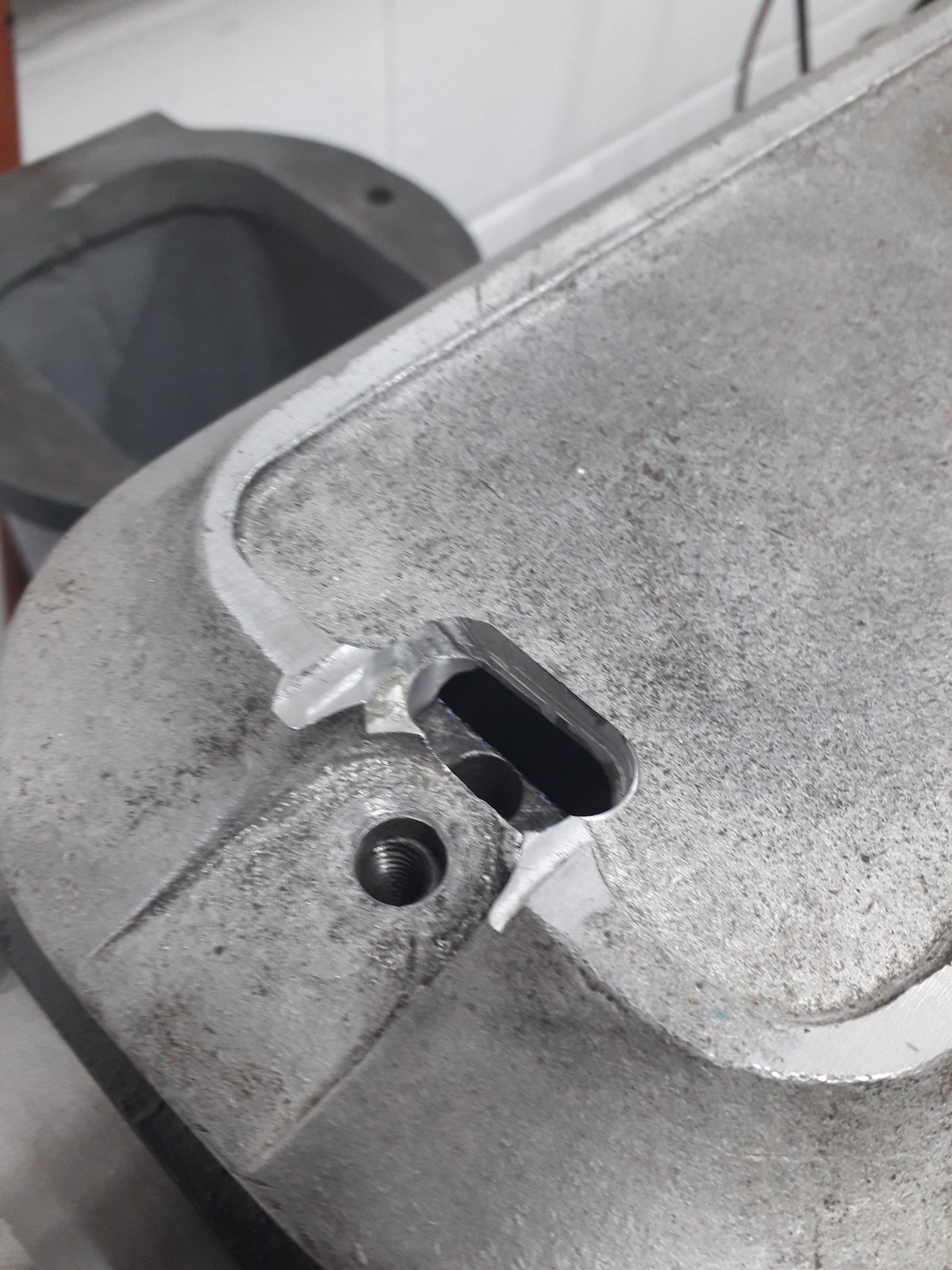

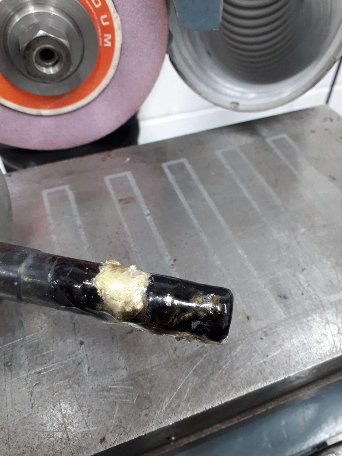

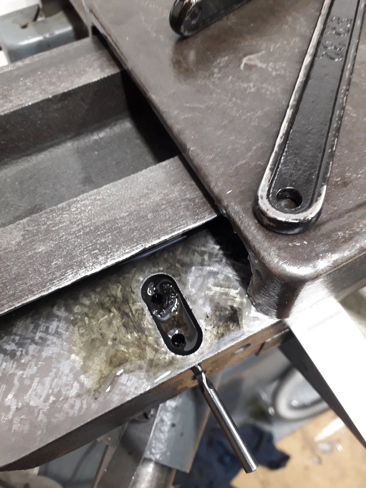

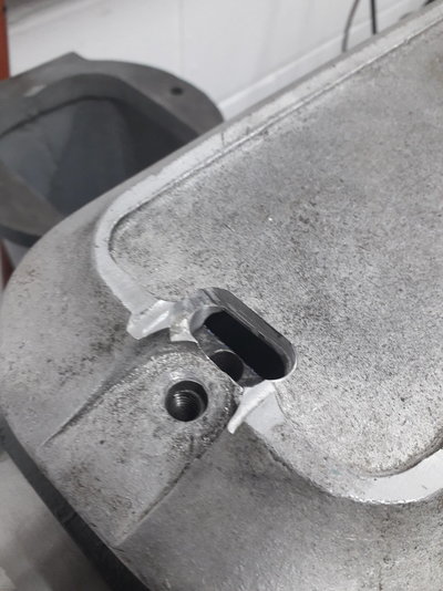

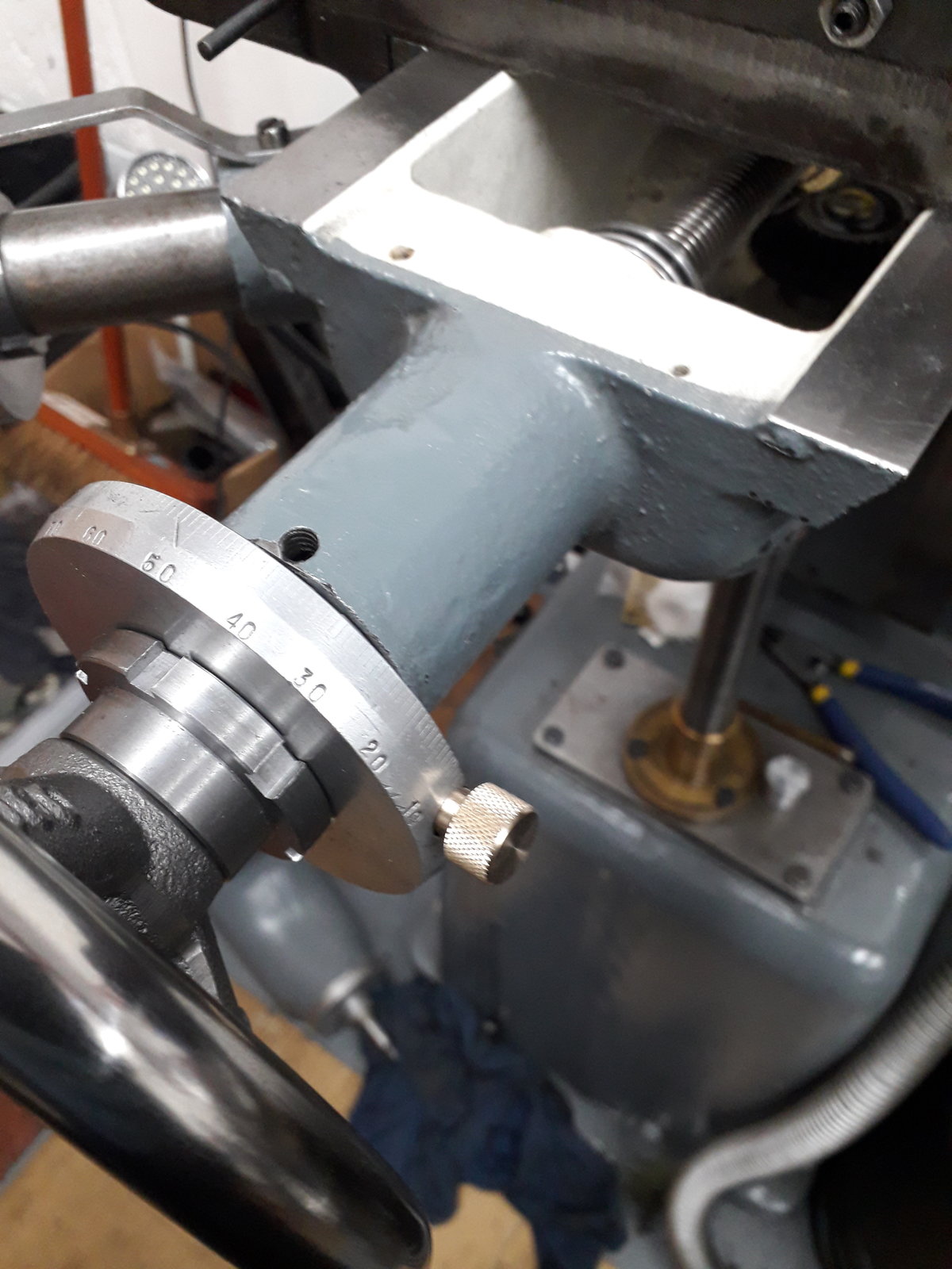

With the controls built I've started cleaning up and fixing other bits on the saddle and handwheel. First the oil passages in the saddle. These were full of black crud, s a combination of mechanical means, WD40 aerosol and flushing with way oil has them better.

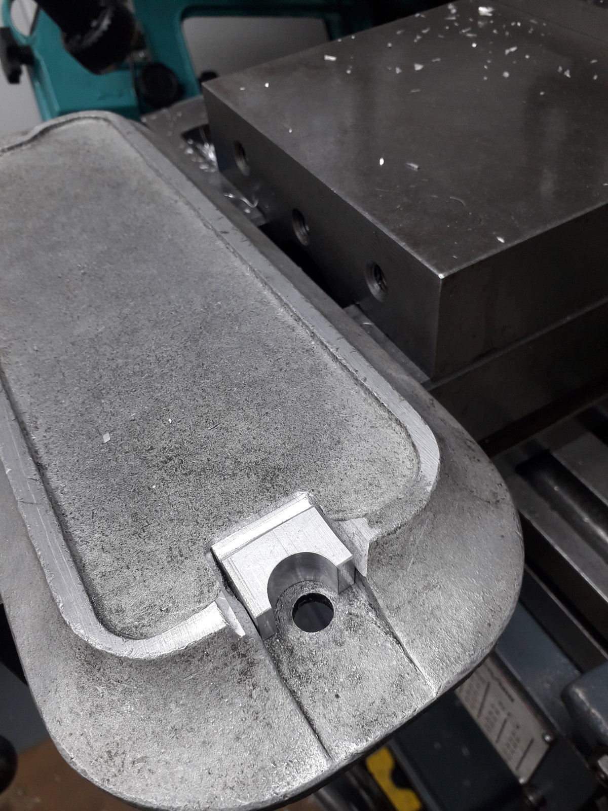

The saddle has these little pockets front and rear at each end which I'll eventually put some felt in. The hole on the front (that the drill bit is stuck in) is threaded... M6, so probably not original. I'll need to either source some suitable oilers or I'll make some little reservoirs.

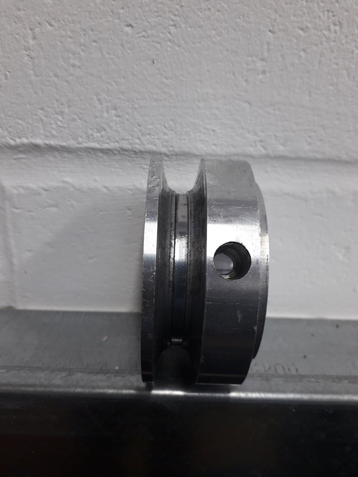

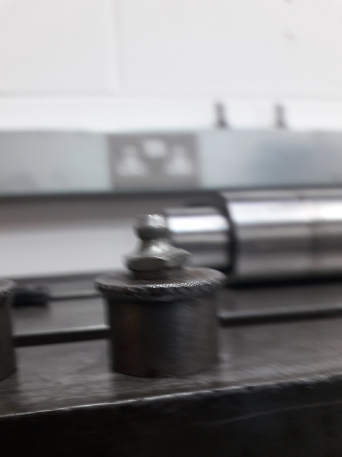

I replaced the SHCS acting as the locking mech for the saddle feed dial with one that matches the knee height dial locking screw:

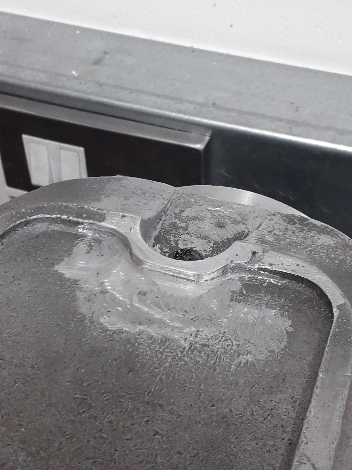

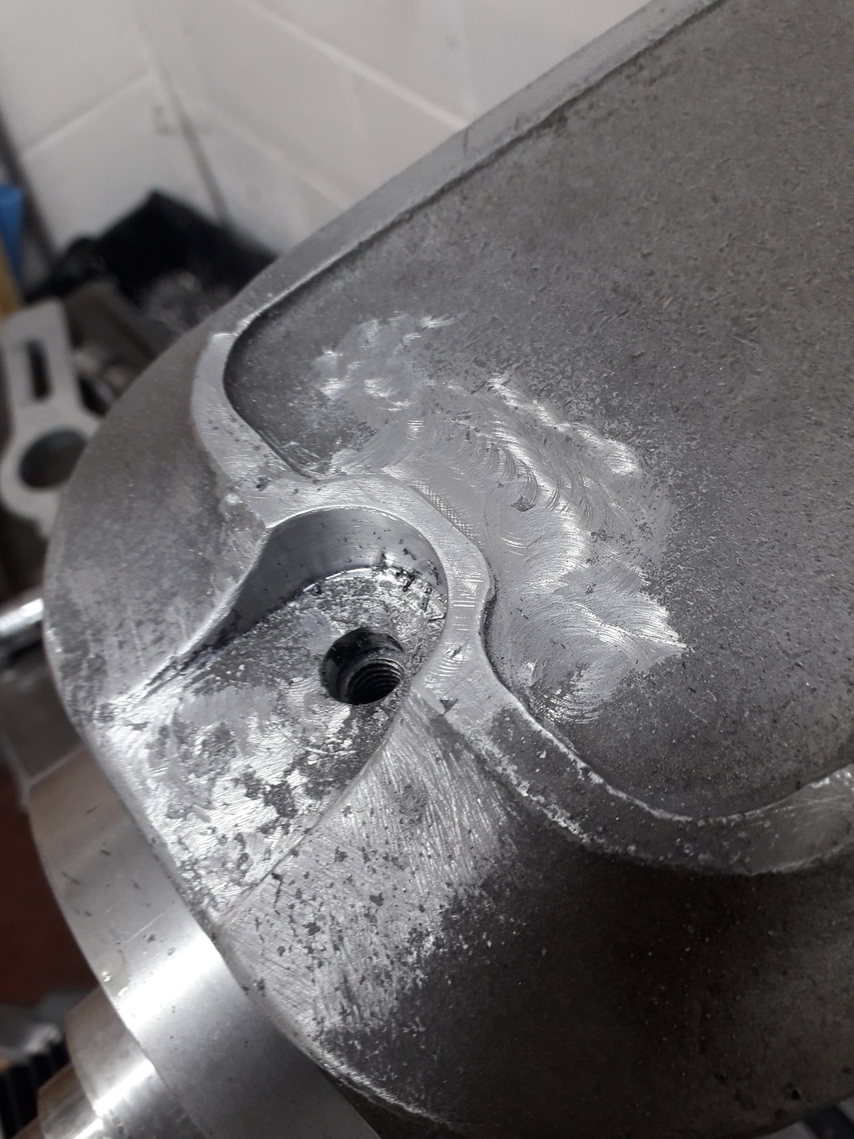

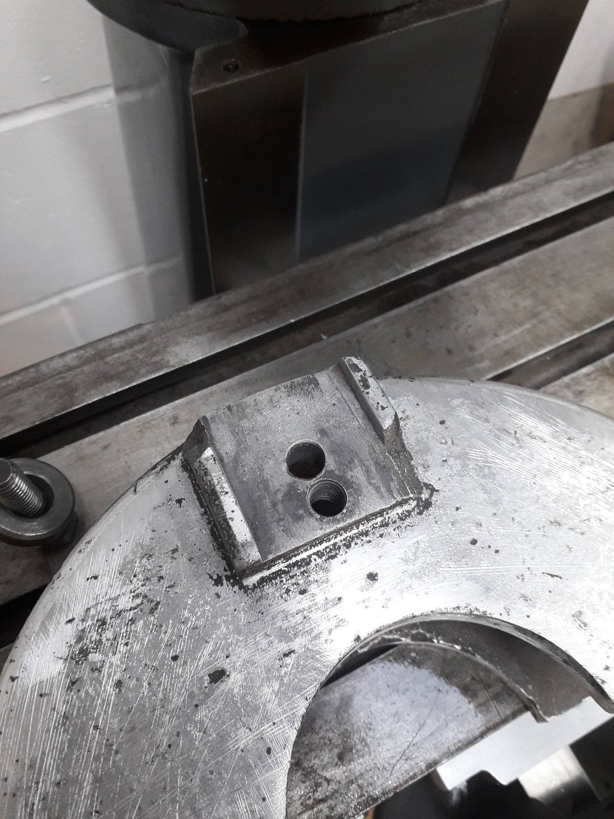

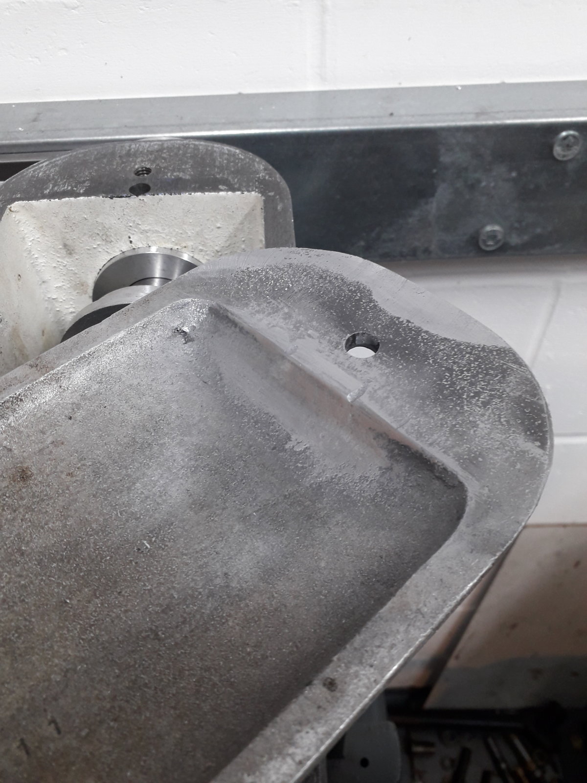

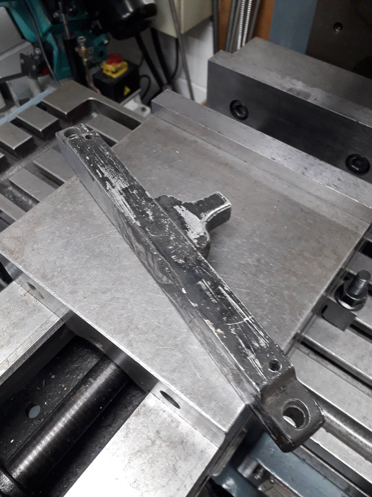

And on to the table travel limiting block. This is a piece of cast ally thats seen better days and is covered in chipped paint:

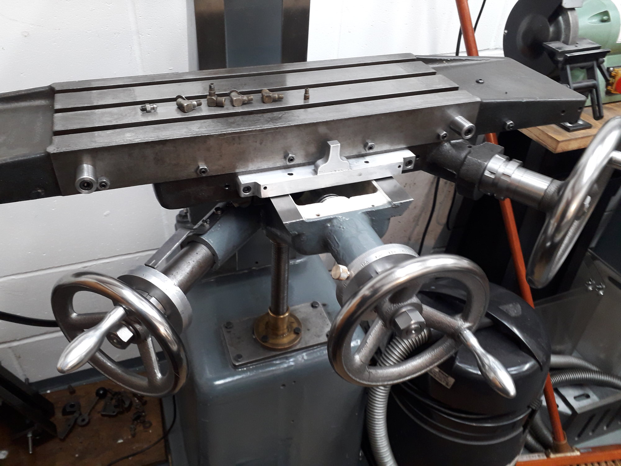

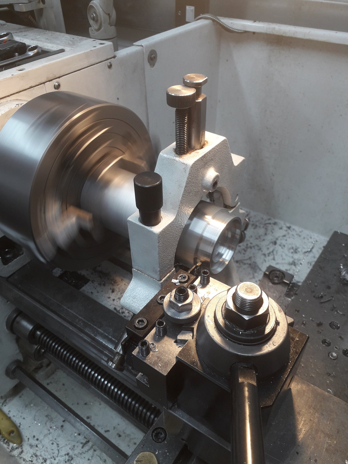

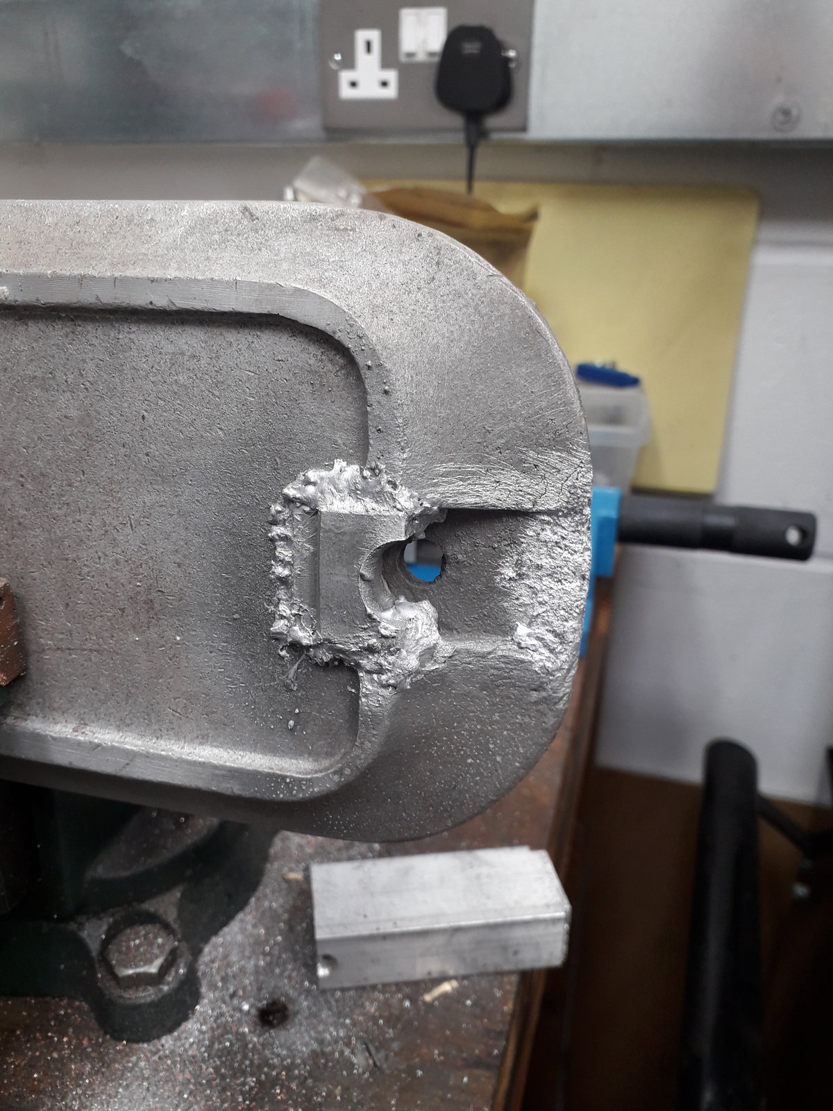

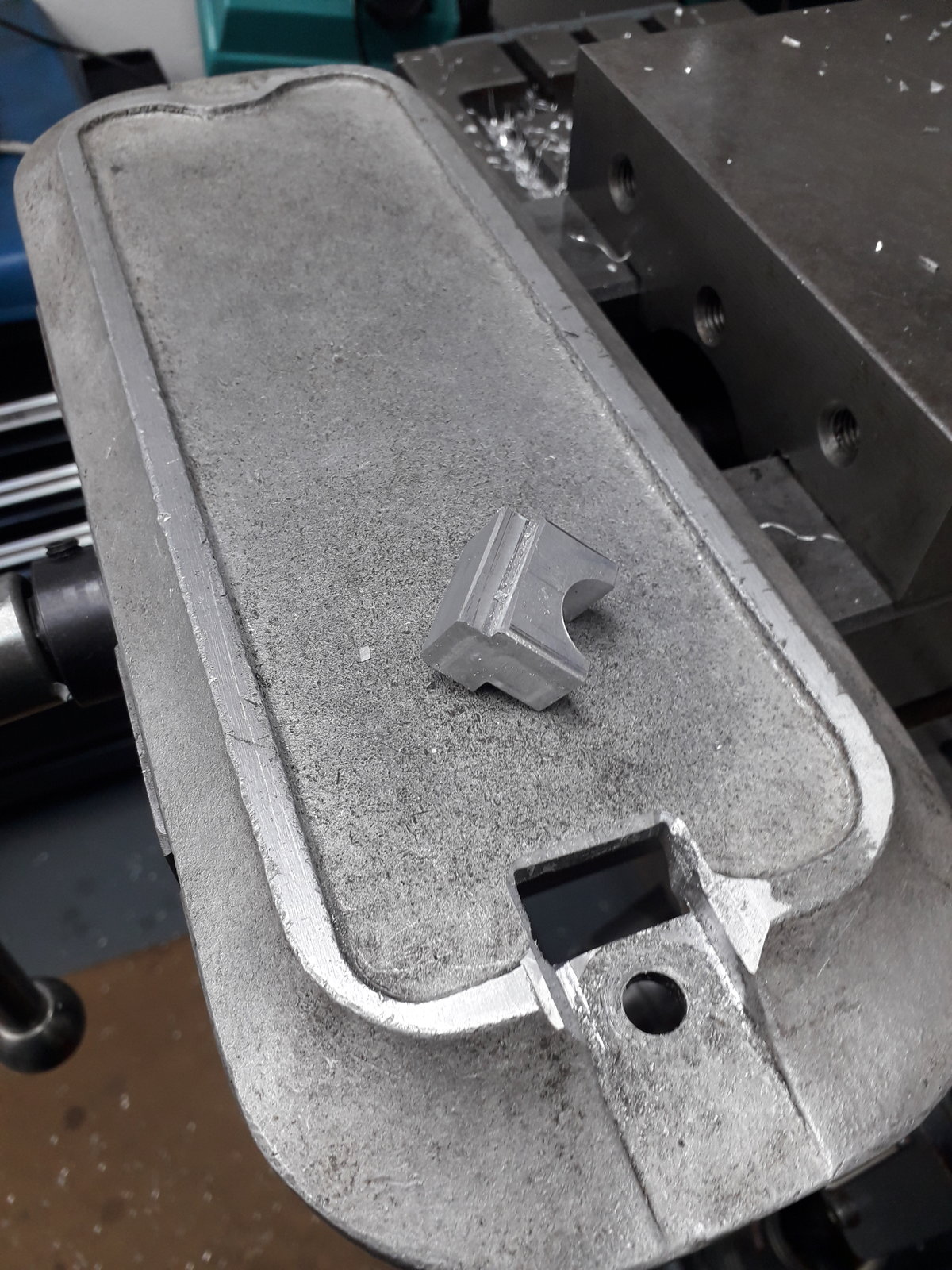

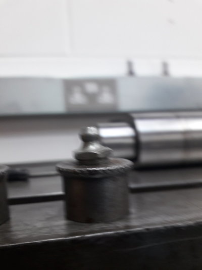

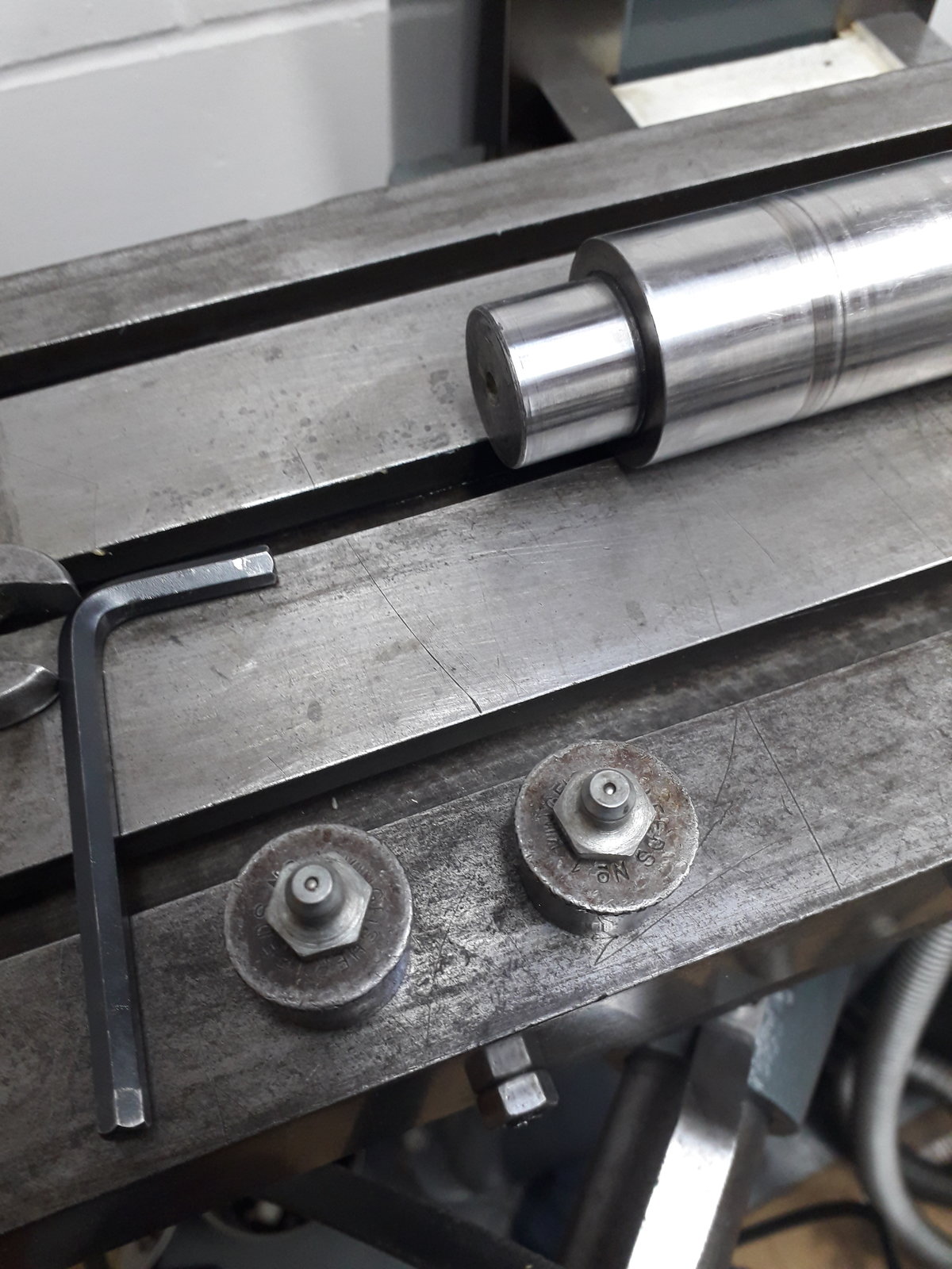

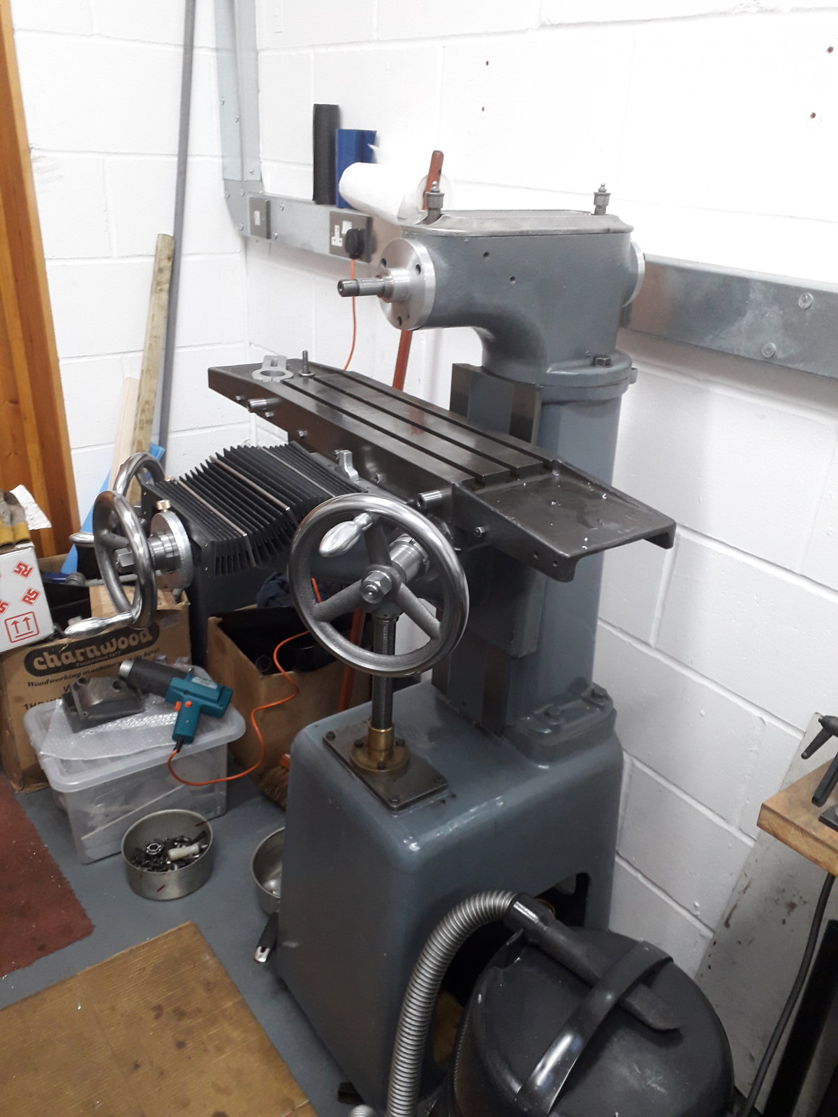

After a bit of flycutting, filing and sanding it's now got flat faces and is devoid of paint. I turned two spacers to at as the travel stops and fitted them with some 5/16 UNC SHCS to the two holes in the table. Here's the table assembly now in all it's glory:
I now need to sort out the machine protection - the knee screw cover and some bellows for the knee and column ways.
