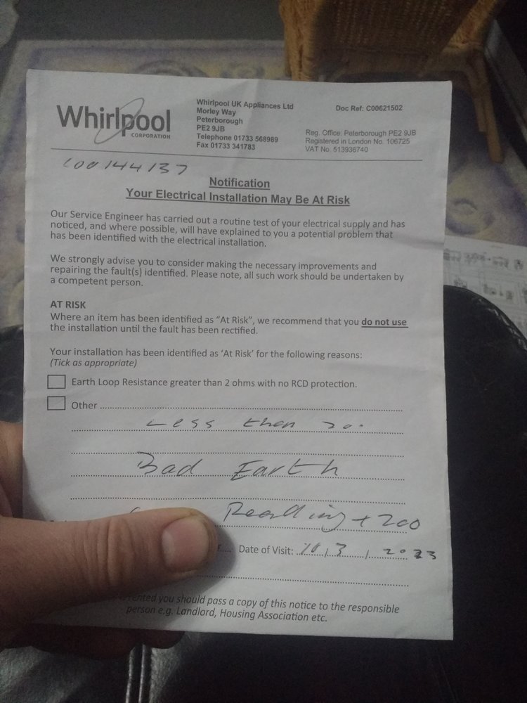

This time the guy took one look and said he needed to do an electrical test. Plugged in something with pass/fail lights, not much more than a socket 'n see and said "I can't do anything as the reading is over 200 Ohms" and promptly left.
Sod's Law my MFT batteries were dead. Something didn't seem quite right. This is the form he left:
Correct me if I'm wrong but it's Ohms not "ohms". Then, the install does have RCD protection! I reckon he just didn't want to do it.
He said it's over "200" but his writing is illegible in part, "less than 2??". No idea what that means.
Where do they get 2 ohms from as well?
Bottom line is I don't think they wanted to do the job. I've told SWMBO to cancel the contract and put the £240 pa towards a new machine every couple of years.
Of course she "likes" the bloody thing. I can get the half drum kit for around the £100 mark.
As it stands, with the rod work, I'm measuring around 7 or 8A pfc. So that's what 28 to 32 Ohms.
Cheeky b'stards sent an email too saying how they were glad to have been able to fix the machine!![]()
