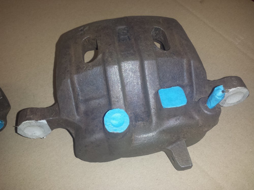

Need to replace anodes too, these started life as 3mm plate but are now like a sieve!
When I was electro-stripping several weeks back, I bought and used this:
http://www.ebay.co.uk/itm/171670341948?_trksid=p2060353.m1438.l2649&ssPageName=STRK:MEBIDX:IT
This was after my battery charger went up in smoke (My own fault really), so thought to get a proper supply.
Yes its Chineseie..... It arrived with a dodgy fan but I continued to use it until a buy a new fan for it (a round tuit moment). The fan did die eventually!
When I realised I hadn't heard the fan for a while I checked the machine...damn hot! even to touch . Let it cool and ordered a new fan for £10.
To be fair, I thought it was fried for sure, but after fitting new fan it fired up and still continues as if nothing had happened. It was great for the job, although I regret not going for a higher model for the extra juice.
In the meantime I bought a Fusion FS-PS200ADJ 5-15v 15A power supply which is cheaper and has been very reliable so far for plating and electrolytic rust removal, seems better suited to the task compared to the PSU.
No. It will give you 0 volts at 0 amps if you put rectified power into a welder (well, some inverters will handle a rectified input, but not like the 'wrong' voltage).
What 'might' work is to put 110v AC into a buzzbox and rectify the output, which might give you 24v ish, or it might just melt the step down unit
Remember, current is drawn not pushed (ok, if you up the voltage you'll draw more current, but still) and a buzzbox shunt only limits the current - so you could hook up a half-voltage rectified buzzbox and it'd only supply what it's asked to by the load, in this case the electrolytic reaction.
I had an 8 amp battery charger running a tub, and due to the electrode area it was only drawing about 5 amps - adding more electrodes drew more current - so using a welder as a power supply would just allow you to use far more electrodes (it'd probably please your electricity supplier too )
You can use an electronic charger, you just need to use an old battery in the circuit to fool the charger into staying on the charge cycle. Unfortunately the chargers are not suitable for continuous running on the charge cycle and they will eventually start messing about and will sometimes not want to start charging a normal battery. (Guess how I know this).
