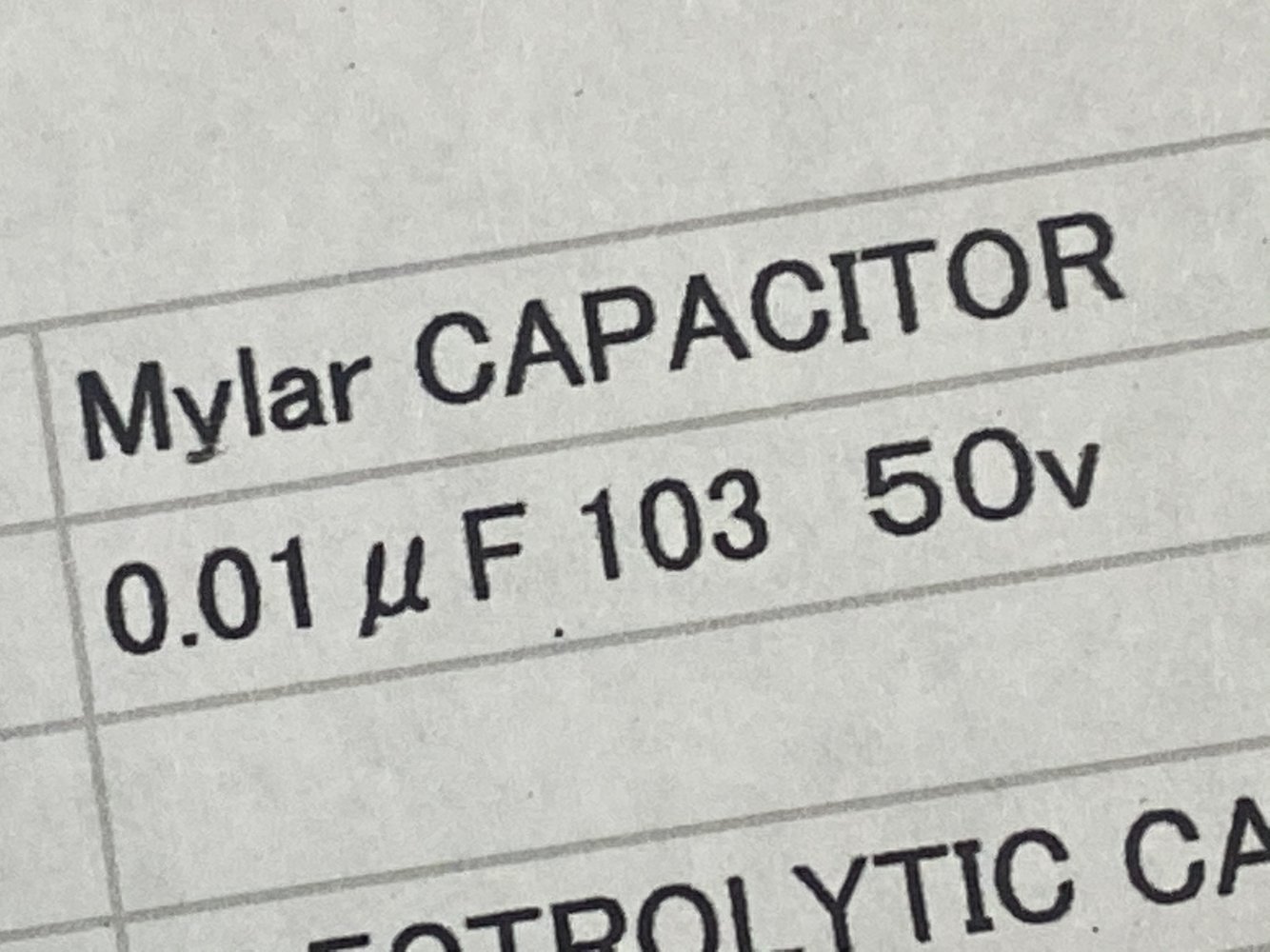

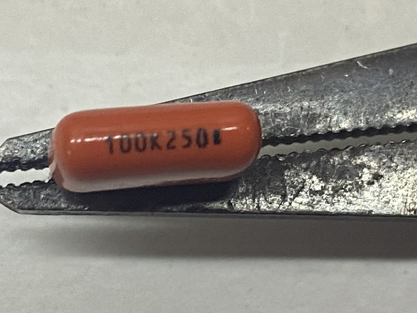

10pF +/- 10%
250 volt probably.

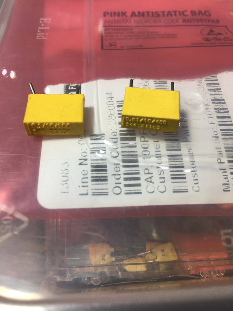

now the problems start, I need 2 but can only buy in packs of 10 but won’t be here till the new year

I’ve only got 2The cap in the original picture is 100nF (100 x 1000 pF), 250V, whilst the parts list cap is 10nF. You could string 10 off 100nF caps in series to get 10nF ;-)
