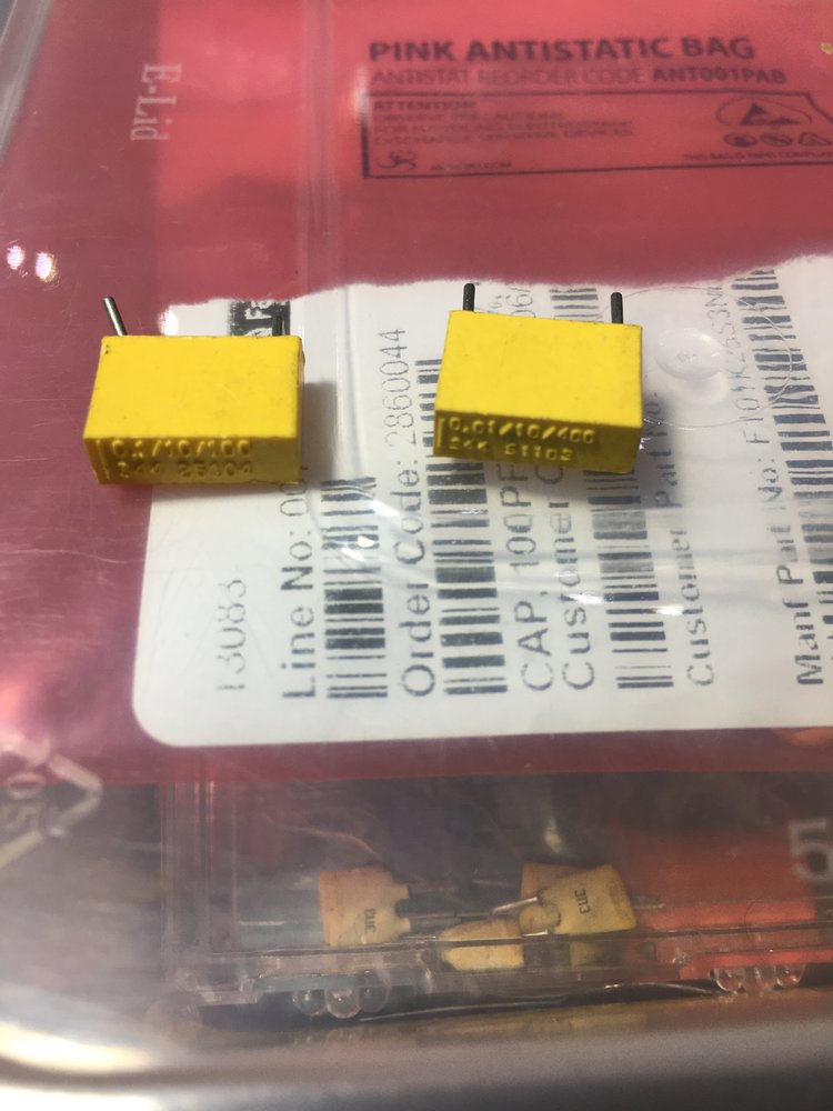

i thought I had all the parts, but clearly not
upon Reflection it would have been cheaper and easier to buy one of the kits with all the parts. It cost about 50 quid, ive spent way more than that, tryi g to save a few quid

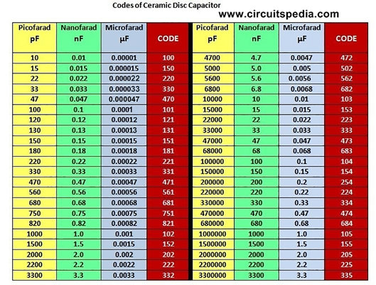

100K is 0.1uF / 100nF /
