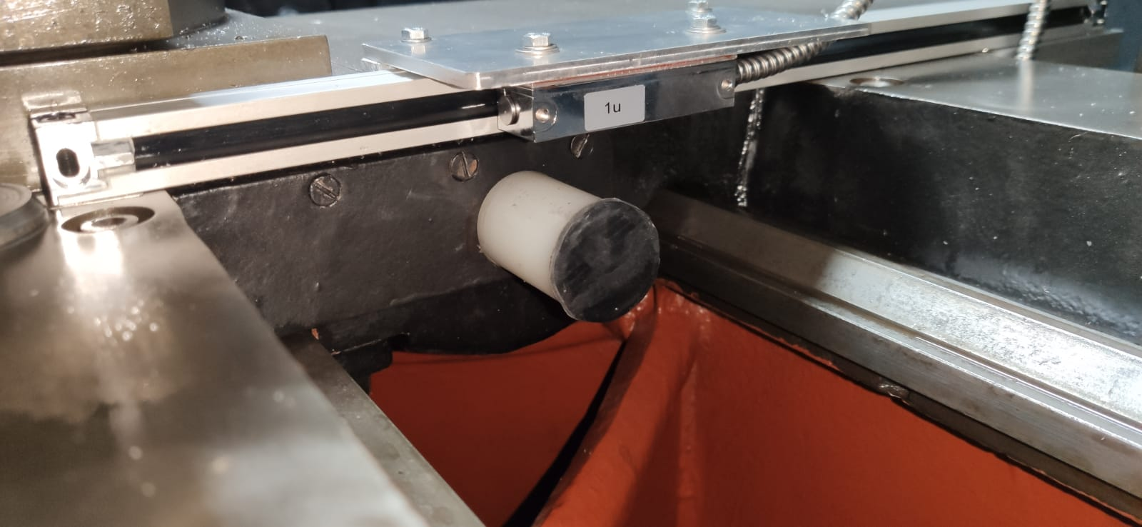

The Sino X-Axis scale worked perfectly, the eBay purchased one did not
A big fat Zero was the only thing displayed on the DRO for the Z-axis.
I swapped the cables around to see if it would make any difference, but it did not.
I was panicking thinking I might have a 'dead on arrival' scale from eBay and was NOT looking forward to removing it again.
Luckily my milling machine is close to the lathe and I could plug the Z-axis scale into the milling machine's DRO to test it.
It worked!
So, I did not have a broken scale but it did not want to work on the Sino DRO.

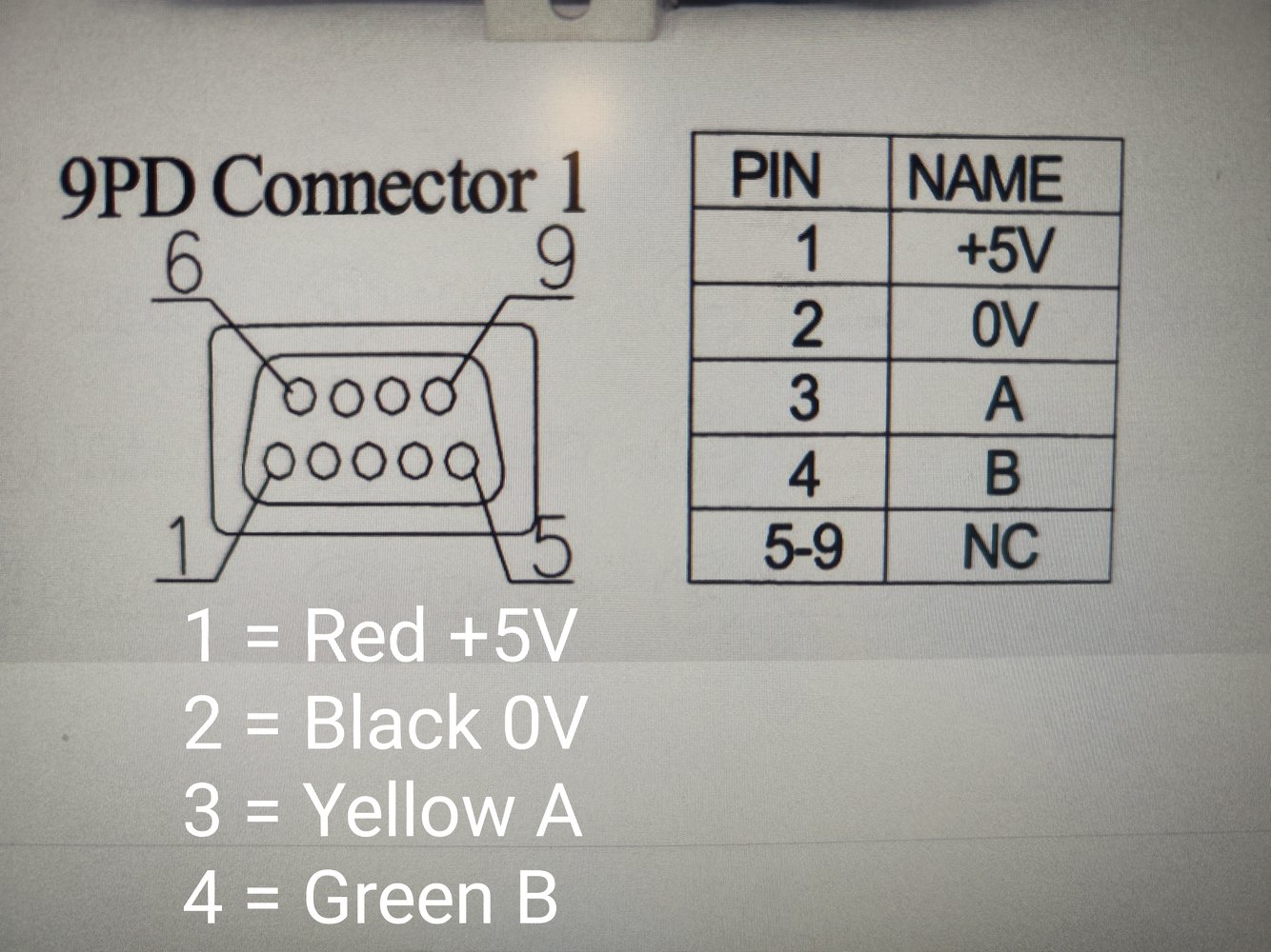

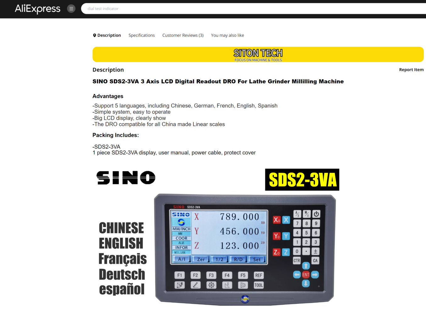

This is despite the Sino DRO stating it will work with any Chinese Linear Scale.

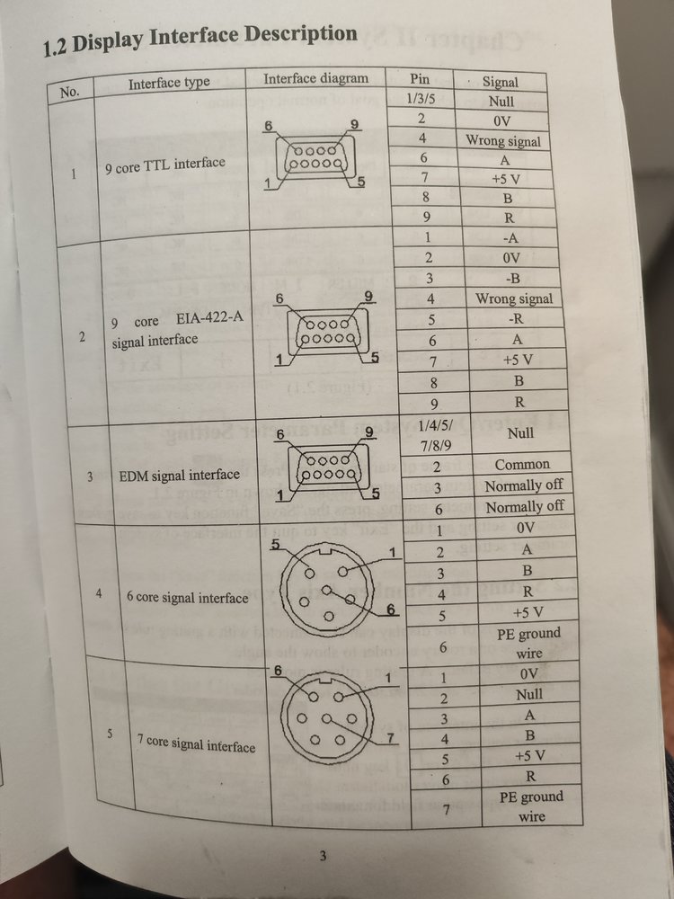

I found this page in the Sino DRO's manual
Mmmmm different wiring standards.

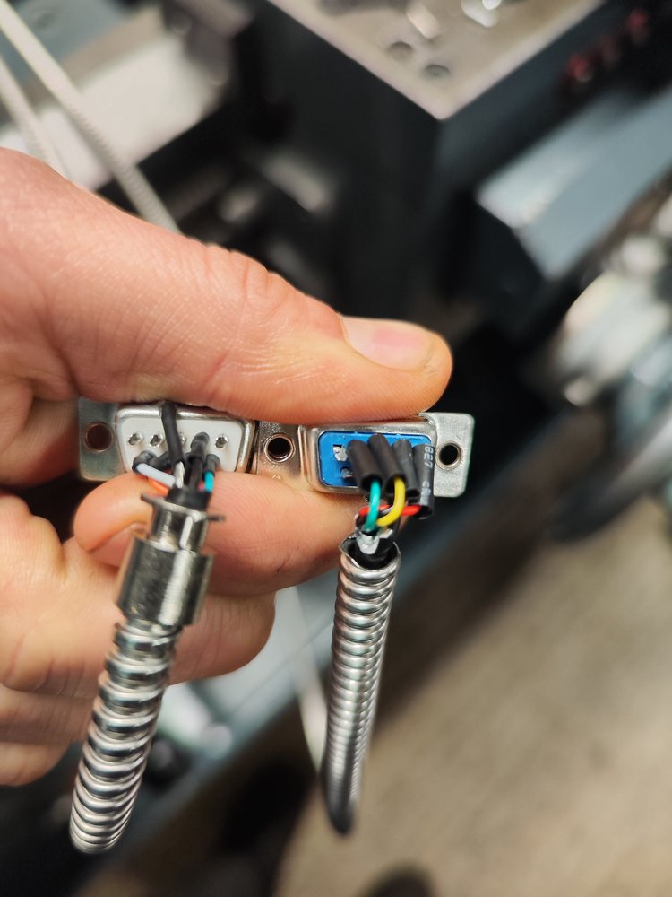

Time to open up the two connectors of the scales.
The white connector is the Sino scale and the blue connector is the ToAuto eBay scale.
They are not the same!

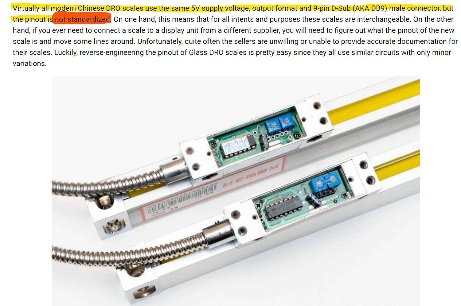

I did some googling and came across an article on the TouchDro website
Great. Wish I knew that the pinout on DRO scales is not standardised beforehand.

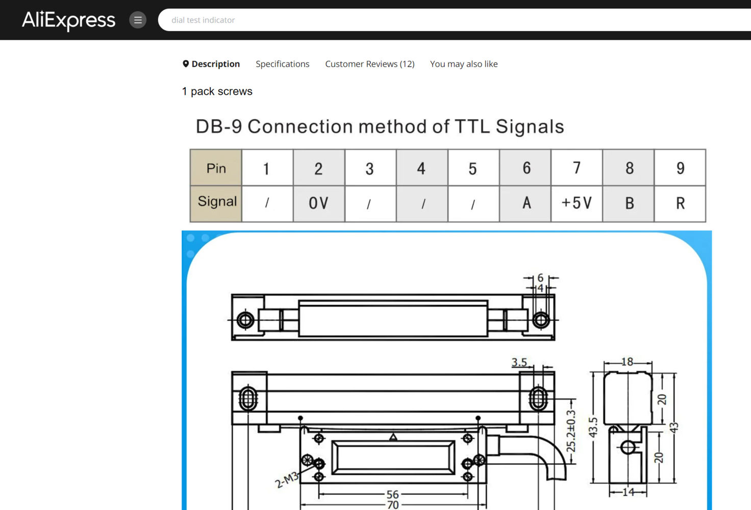

The Sino scale's pinout was displayed on the scale's listing and also corresponded to the pinout page in the Sino DRO's manual.
The eBay scale's pinout was not.
I googled for a bit and luckily found the pin layout for the ToAuto scales.
From the pinout I could work out which colour wire was for what function.
Yes, the wire colours are not standardized either
I desoldered the cables on the ToAuto scales and soldered them back in the positions the Sino DRO requires and all was well!
It worked!
