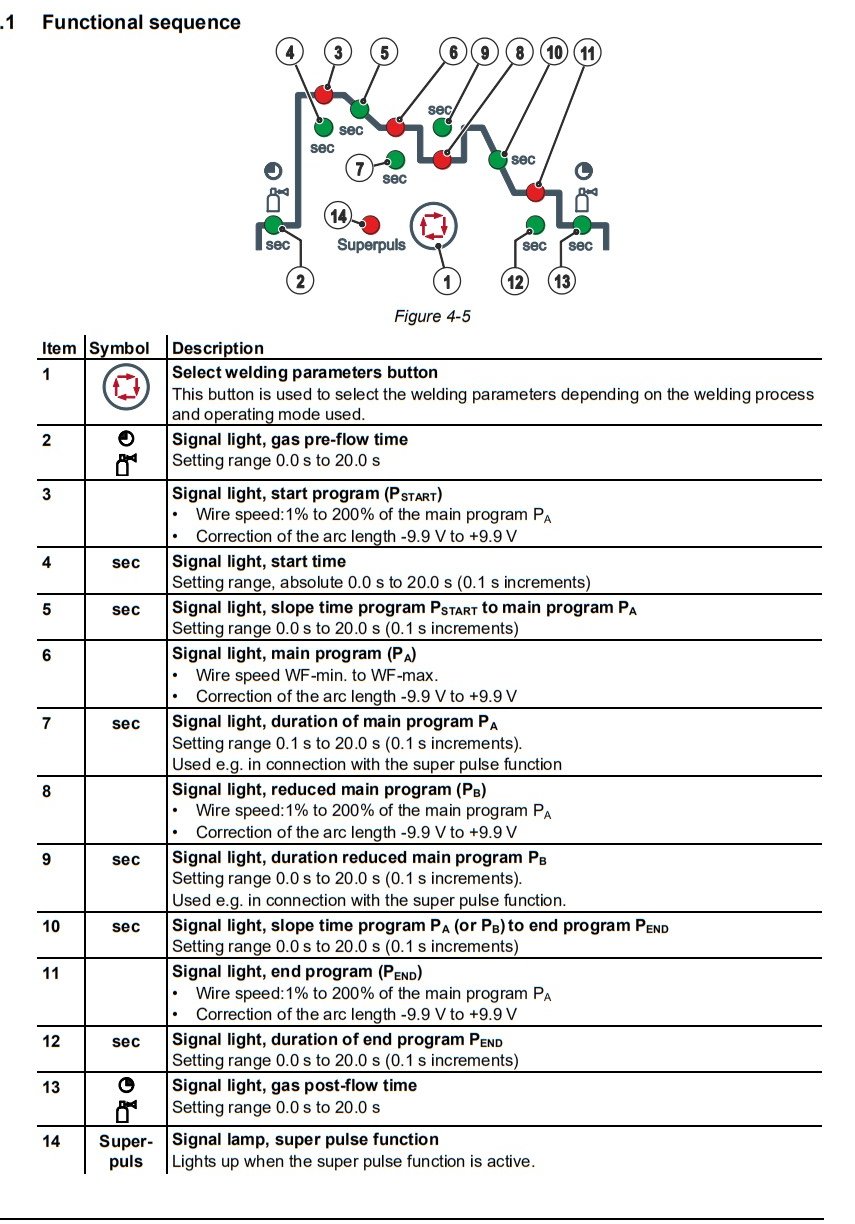

Can you change program during a weld run?
Actually you can![]()
Cool. So if you set enough programs you can just skip through them as if you were adjusting wire feed speed. Just need the software to set it all up.

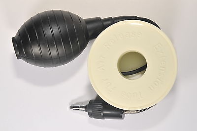

Hope the bulb is hot spatter proofView attachment 260954
Remote air shutter release .
First one I found, £14 for 6m.
You could mount the bulb on the python behind you out the way of the gun.
3d printed bracket, fit to the welder with double-sided velcro tape. It will push the switch for you. No warranty broken.
Does give you a few options:
Ie. For welding 8mm,
Job #180 = 8mm. No pulse
Program #8 = your default settings for that
Programs 7, 6 , 5... lower wire speeds in steps of 1
Programs 9, 10, 11.... higher wire speeds in step of 1
Job #181 = 8mm single pulse
Programs same as before
Job #182 = 8mm double pulse
You could then go as far as Job# 280/281/281 is also 8mm but the programs all change the wire speed in steps of 2. (Or 5 or whatever)
Job 380 could change something different.
I dont know how many memory allocations are available and aside from the machine you would also be limited to how many you could remember yourself!
If 1mm to 9mm pretty much covers you then you can do it that way,
Job 101 basic 1mm, programs change wire speed
Job 110 single pulse, 1mm
Job 210 twin pulse 1mm
Job 310 basic 1mm, programs change something else..
Job 102 basic 2mm, rinsed & repeated
CowardThere is a "specialised" leather sheath product that a bulb like that would fit into. I am not prepared to do a search for it.
