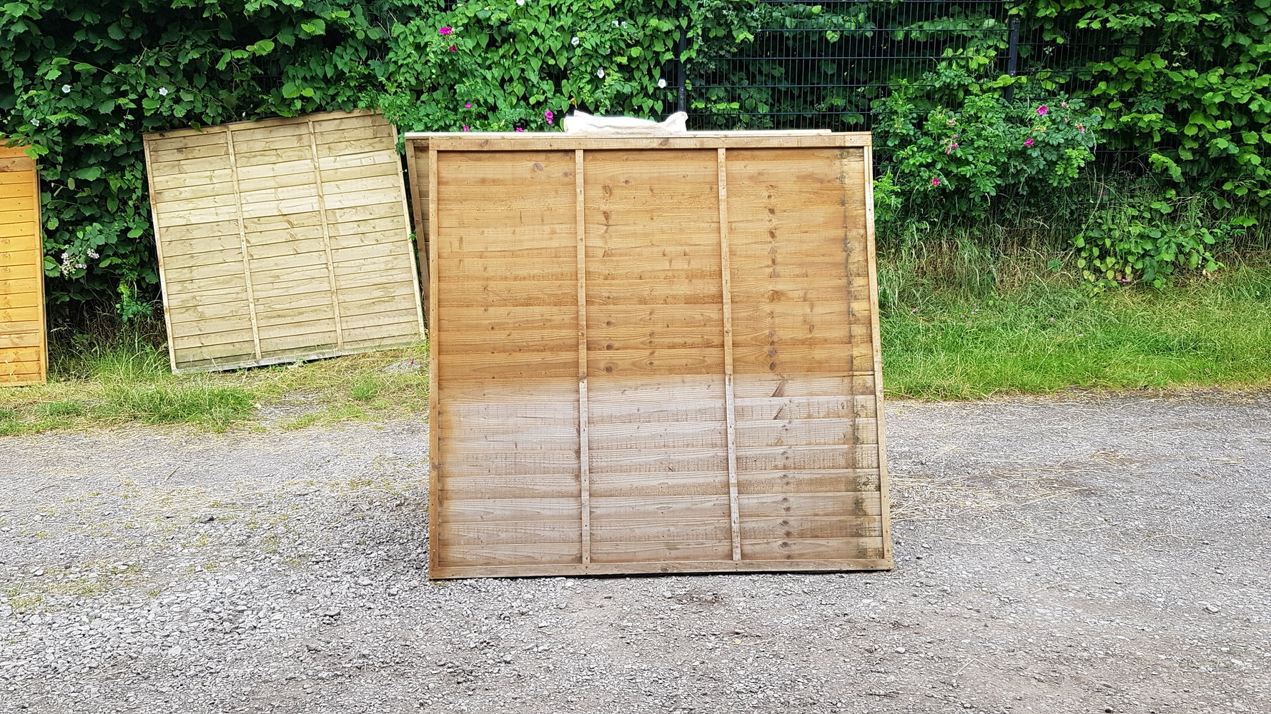

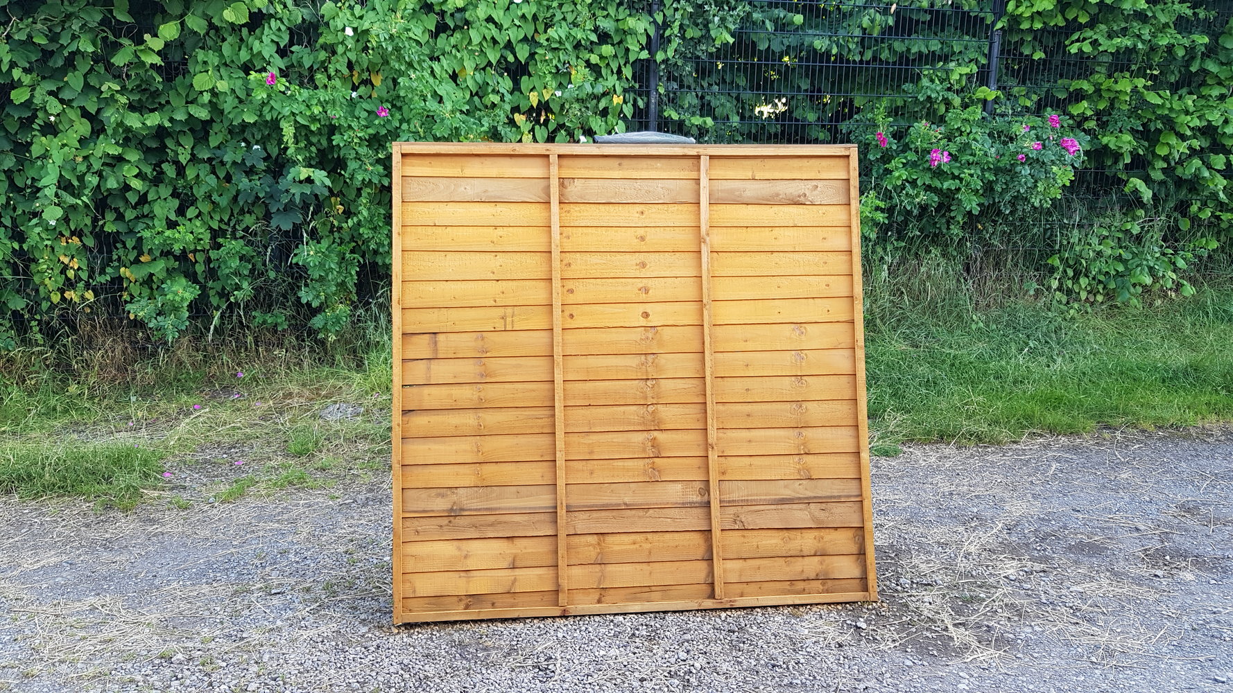

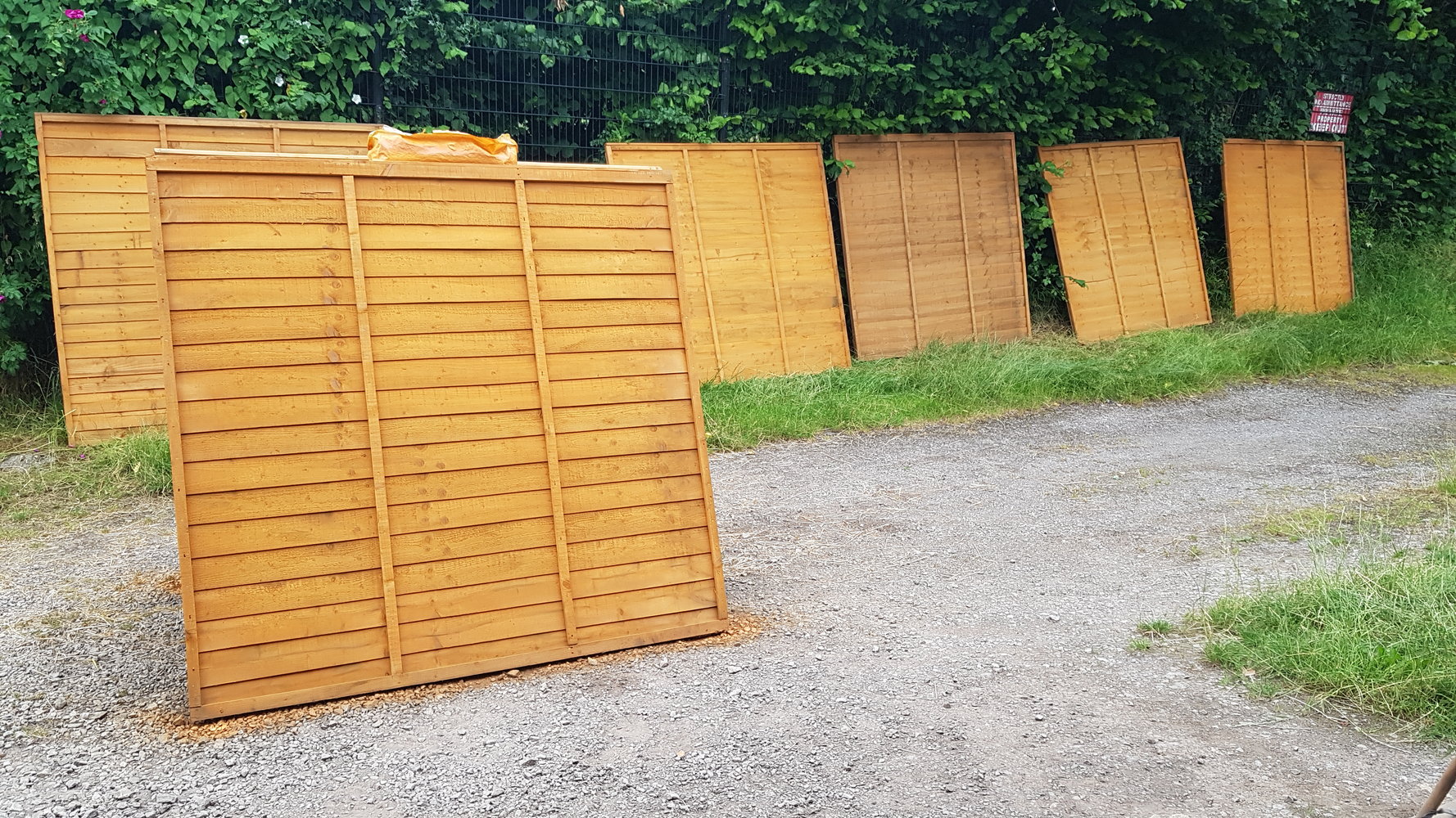

I have sprayed one panel so far,As said over spray can be brutal, but if managed spray gun all the way! I am currently spraying my fence panels as I build them using cuprinol ducksback, this is very thick stuff and specifically says not suitable for spraying.
I'm not letting a tin tell me what to do! So bought this
Spray Gun HVLP High Volume Low Pressure (Gun 1.8+2.5mm Nozzles) https://amzn.eu/d/5pVYc43 ( if that works) think the price has gone up but a spray gun with a 2.5mm nozzle works great. Flow restrictor wound all the way back, just adjust the pressure and pattern. No need to water down of strain the paint, 2.5mm is very forgiving when it comes to lumps
Also found the ducksback can keep in the gun for a few weeks so no need to clean after every use, handy for my situation where I'm only getting time to build a panel a week...
Devilbis JGA, 1.8mm nozzle I think,
Cuprinol Ducksback, thinned 60% paint 40% water,
I only use my HVLP's for car paint,You get over spray if you miss the target, but mine only runs 23psi at the gun, so it doesn't go very far.
I'll try it neat, as you say,Did you try it undiluted? It is thick but might surprise you. I was apprehensive at watering it down as it's got wax in it and don't know how that would work? The wax really does work though, the water beads up on the painted panels and rolls off.

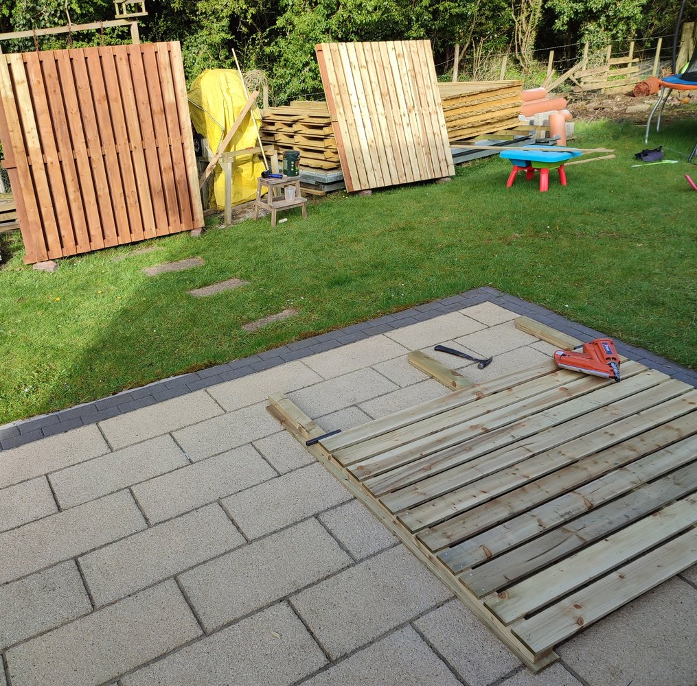

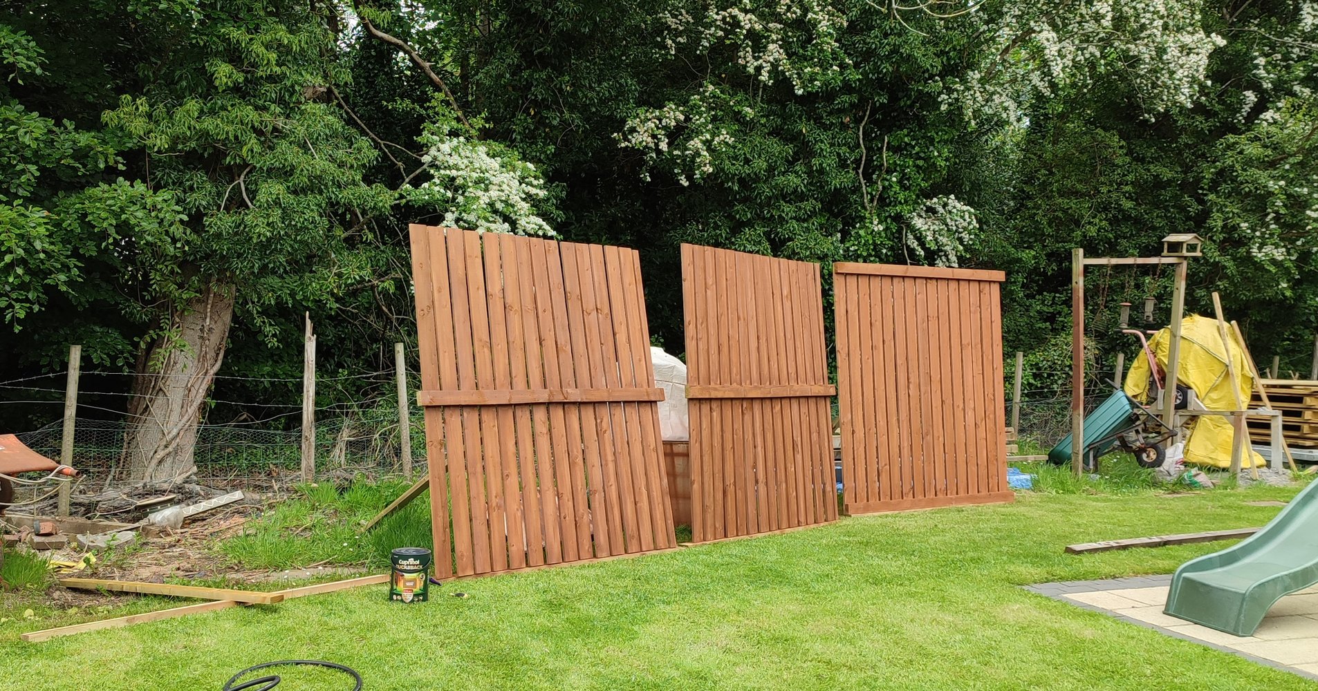

Out of desperation I tried it in my little 1.2mm touchup gun to see if it would spray neat, and it did! Took a bit of pressure to get it out but worked. That's when I upgraded to the big one, not tried the 1.8 nozzle though. Here is part of my panel production line, double sided hit an miss painted inside and out, 2l of paint per panel! (Harvest brown)
