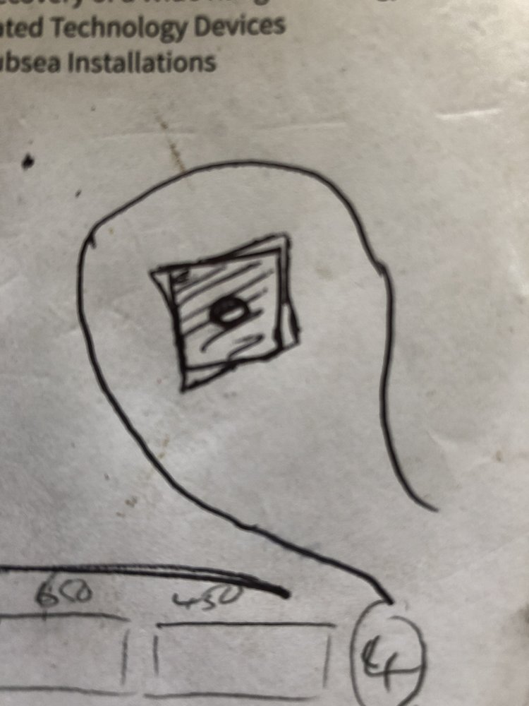

Part of the problem and perhaps why its a common issue, the bottom bracket male tapers always have large radiused corners, while the female are cut square, it seems wrong, encourages a sloppy fit. Its very tempting to tig it up and grind it sharp square corners, if it wernt for that it would cook the bearings.What I was getting at with the copper.
in my head from the op it’s like this:
No amount of bolt tightening will fill that gap
Evans, who I bought the bike from had previously cross threaded and ruined the bottom bracket thread, I replaced it, but thats best left alone while it works.
I had a good look at this today. I needed the puller tool to get it off. I think I'd done less than half a mile with a lossening crank but it had put reasonable burrs and damage in, a ridge that will stop it going on further - unless it was from last time. Filed it square/flat. Got it ******* hot and tapped it on with deadblow. I had a meter length of tube handy so that was my allen key extension. I do not think it will come off again.
