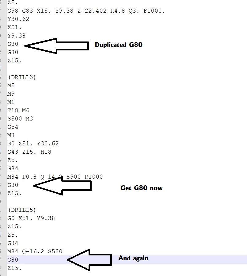

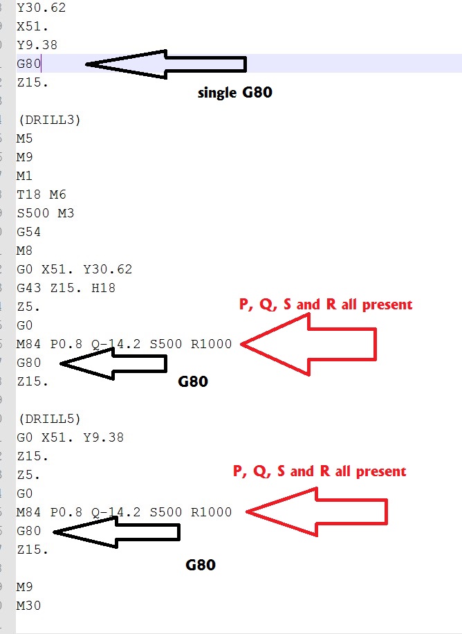

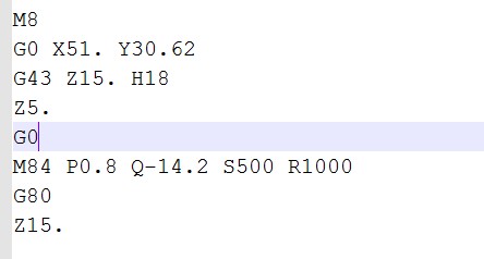

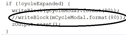

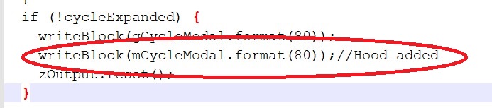

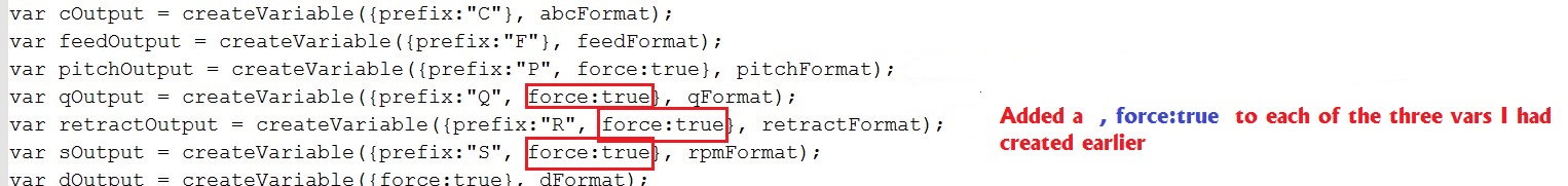

If you are out of your depth I am right at the bottom of a horrid stinking smelly swamp.....I am well out of my depth as well but I am a stubborn B
I have managed to adapt the lathe and plasma ones to suit, will persevere with this for a bit and see.
I thought maybe a drill a tap a drill a tap etc would work but nope, just the same![]()

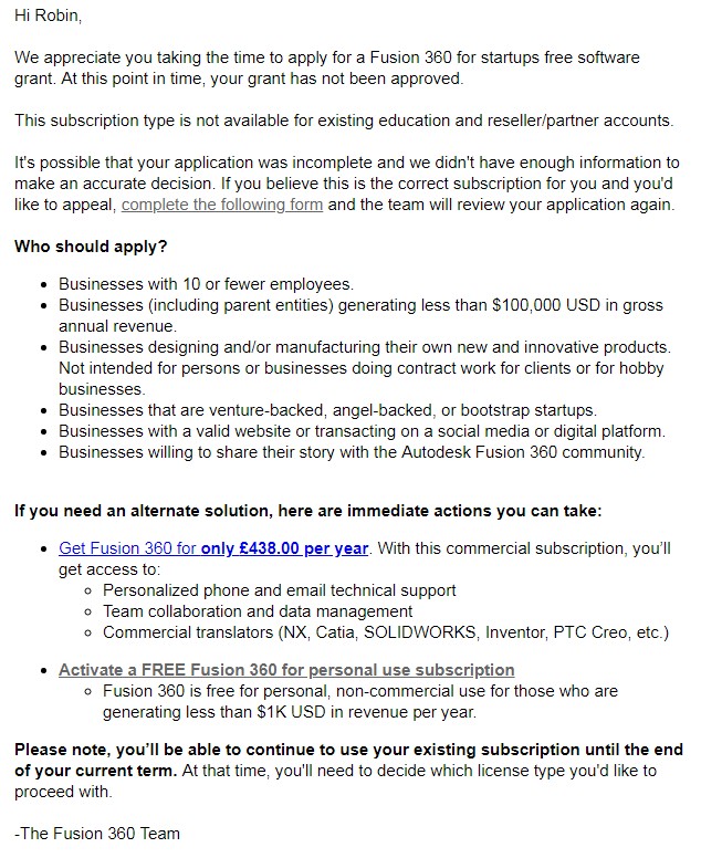

but should the lottery lout decide to get my numbers right for a full house in the next couple of years I might just be encouraged to learn it to be able to play with all the new toys in my new 3 phase mancupboard.
I just hope the new Au paire can assist me without breaking her finger nails too much .
