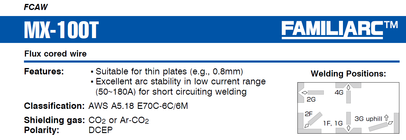

The cheap DIY AC MIGs often have a range of 55A to 90A as this saves maybe a £ of copper wire on the primary winding of the transformer.
The Lidl offering has smarter triac control. The video at 3.03, shows c. 0.7 mm steel being flux core welded successfully.
Most would be blowing holes. Unless it's been faked by using a MinArcmig...
