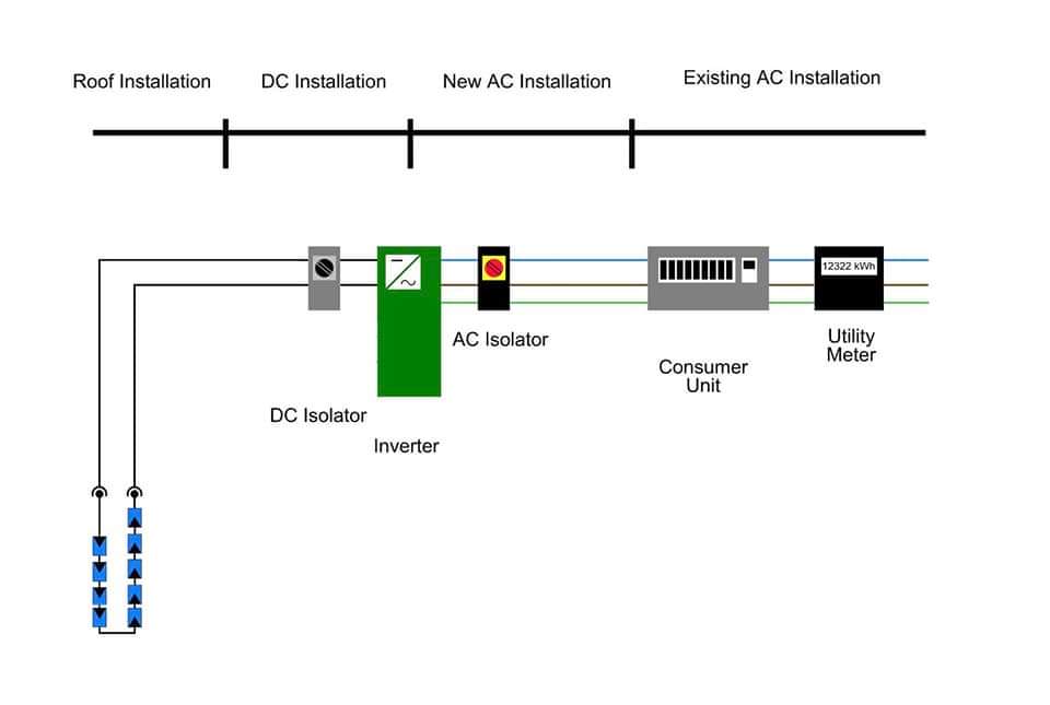

The roof is east west facing and is made of 80mm kingspan insulated panels. There are various mounting systems available, I paid for a detailed quote/study for solar and batteries about 3 years ago. I can look at what they proposed however the guy who fitted the roof came up with a cheaper option. That roof is another option but the east side is covered in trees.Is that sheet metal roof your barn? What direction does that face? I wonder if my live stock building is strong enough for panels one side is about 5 degrees off due south!
AmI correct in thinking that if I have batteries and dont export any more juice than my existing 4kw system I could have as much as I wanted.
In terms of how much solar you can have, if you go G98 then you can only export 16A per phase max. So, subject to planning, knock yourself out with solar panels as long as your inverter can handle it and meet G98 and max export of 16A per phase. Some inverters support more panel over subscription than others so you could have more panels and dump some energy into batteries and your hot water tank and still export some if weather permits.
