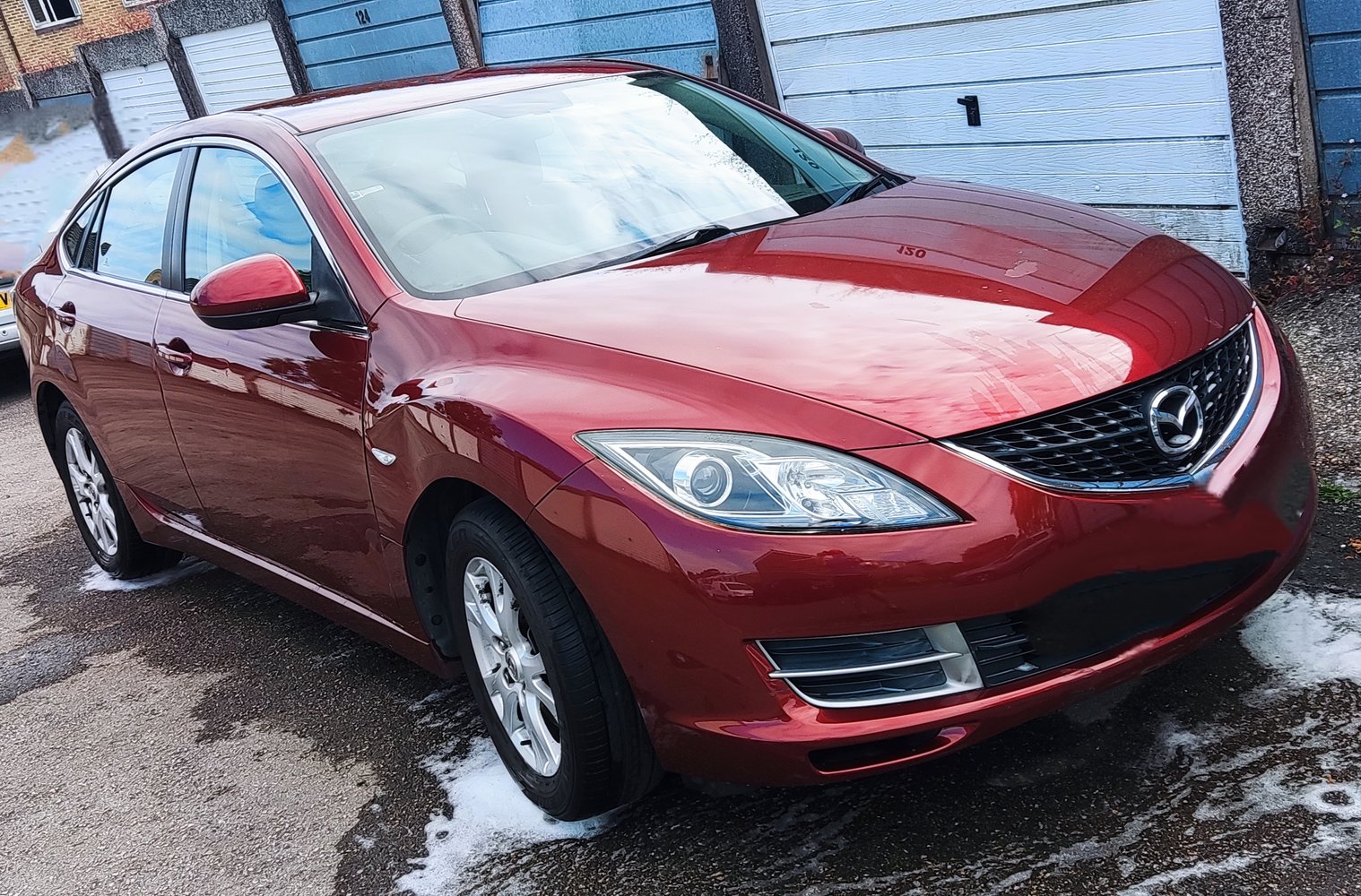

TLDR: My drivers door is stuck locked shut ,,,
Any ideas how I can non destructively open the door to have another try at it? Perhaps I'll need to cut the door and replace it.

TLDR: My drivers door is stuck locked shut.
Since I bought the car, the car alarm was going off randomly. The door open light often flashes up, hinting that the sensor is bad. The sensor is a pair of electrical contacts hidden inside the lock actuator unit.
Today I got the door apart, lock actuator unit out, opened up, cleaned, reassembled and back together. I did a basic test that it all worked with it off the door, all good.
I put it back in the door and started testing it. At first all good, but soon not reliable locking or unlocking, but putting the key in would work. Then the keystopped working and its now stuck in the locked position, with the door shut.

As for the problem, I’d say you are in the best possible situation to resolve it. Most of the time when these things fail the biggest job is trying to remove the door trim with the door stuck shut.
To have the trim off and access to the actuator rods is half the battle won.
As for actually freeing it off, it’s probably going to be one of those unique situations you are going to have to figure out - I doubt too many people have had exactly this specific issue.
If one of the bars is stuck on the metal shield, then that's probably the first thing to attack and see if you can free it off.
