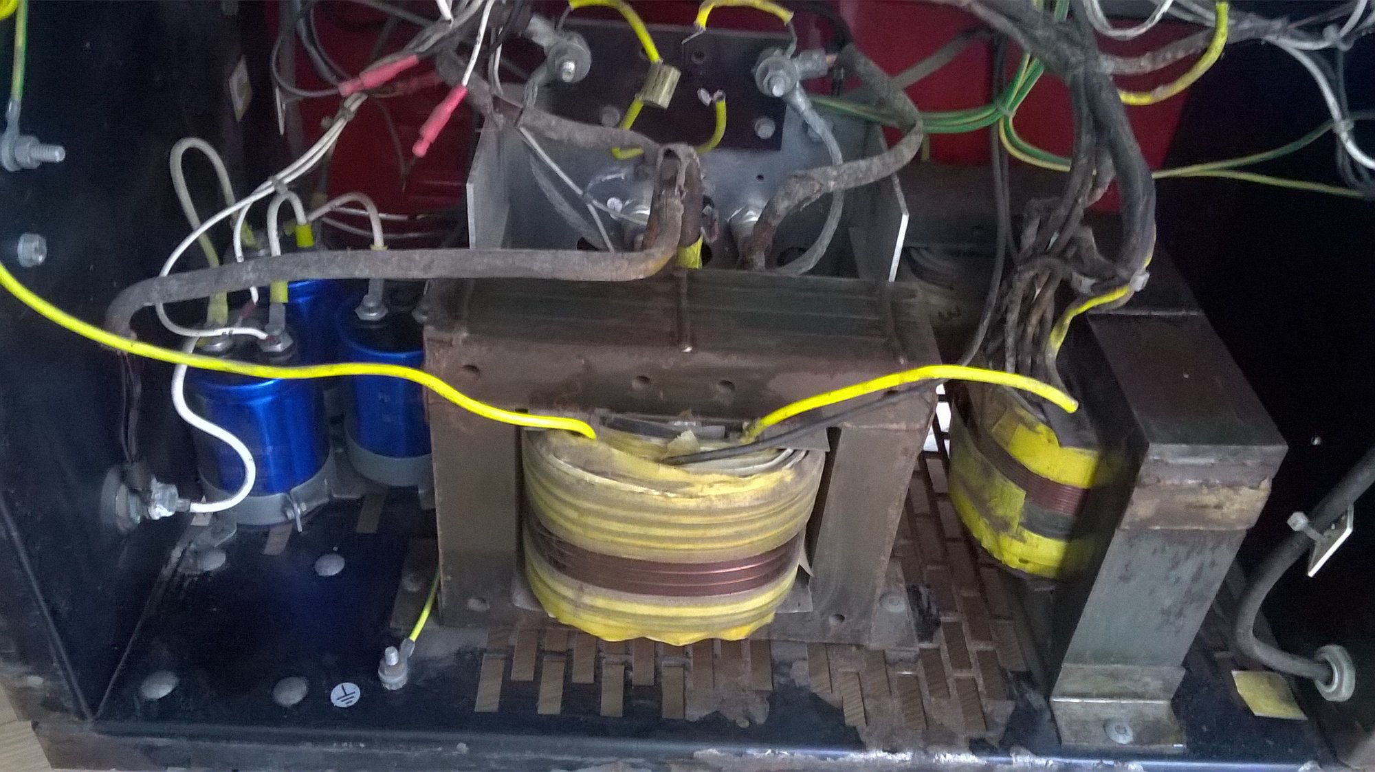

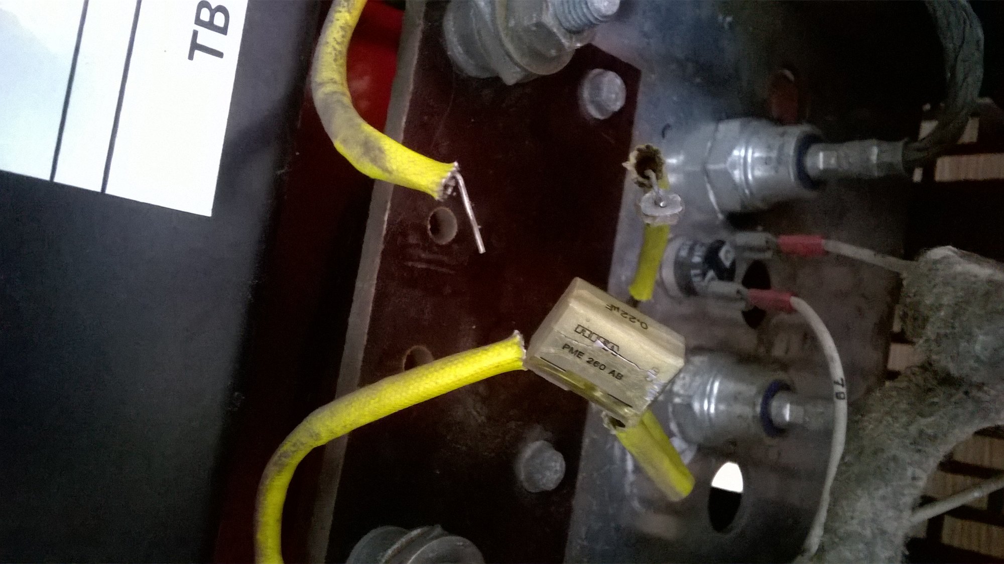

Yup.I would start with that stray wire in your last photo.

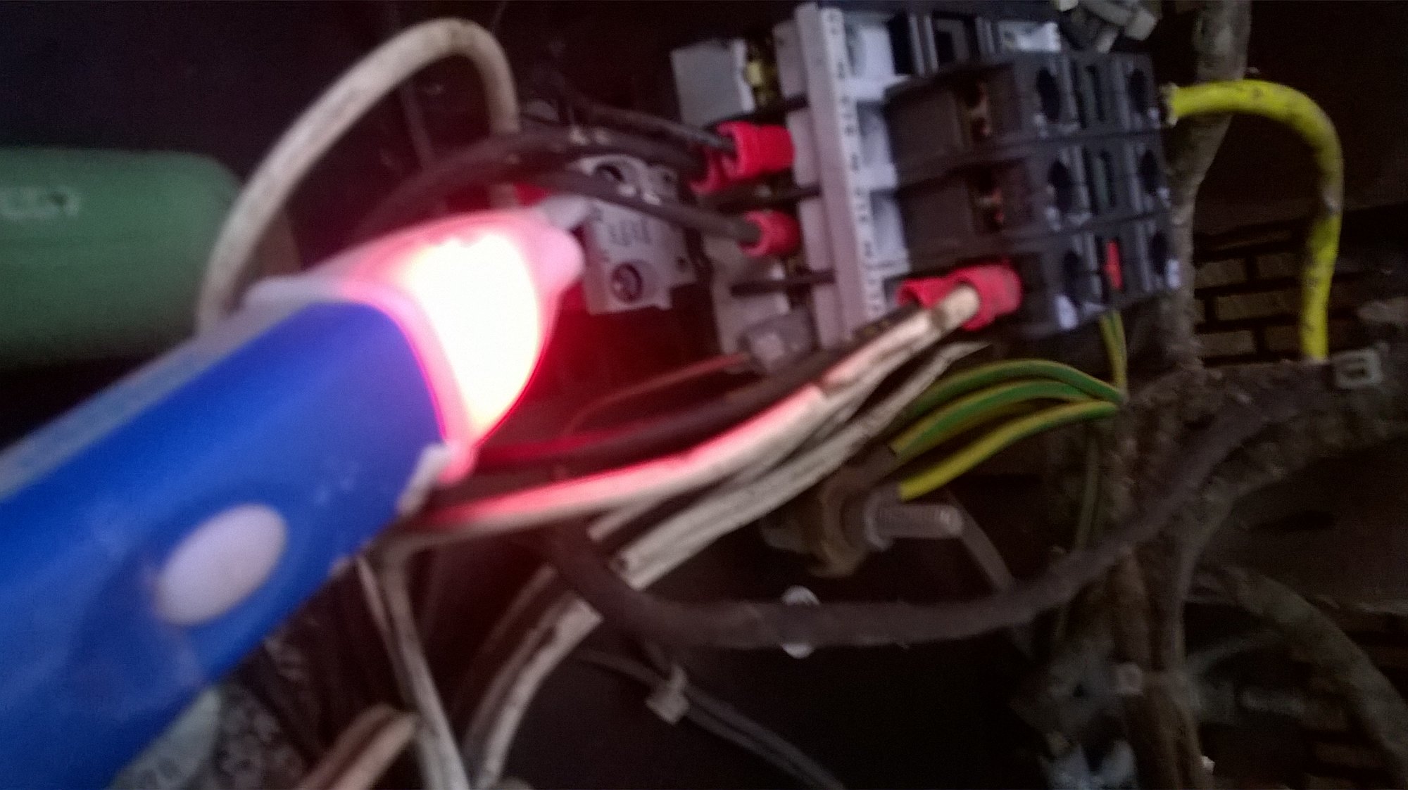

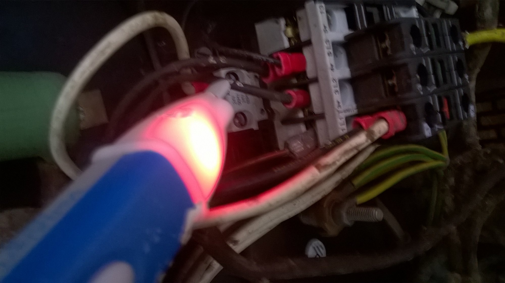

Need something like this check there Rated for mainsI get this with tester nothing on l3 if I push the green button in the welder sounds on

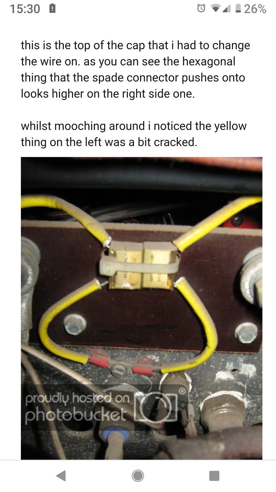

thats 2 capacitors
to further this post
rifa pme 260 ab 0.22uf
PME 260 General Purpose Metallized Paper Capacitor PME 260 General Purpose AC/DC Capacitor · , 695-2-2 IEC 68-2-3 Test Ca +40°C and 90 - 95% R.H.
https://www.datasheetarchive.com/RIFA PME 260-datasheet.html
rifa metal caps was renowned for failure
You have a missing component Sarah, there’s absolutely no point in doing any other fault-finding until you’ve replaced it.
You will quite likely find that’s all that’s wrong with it, if not then at least you know the fault lies elsewhere.
I disagree, you are mixing up cause and effect. That cap did not blow up of its own accord (there was a short through it) and it would not be causing a complete lack of power to the unit.
If it is replaced before fault finding the unit then it will just blow again.
Start at the beginning and work through the unit until something incorrect is found.
I wouldn't rely on results testing with one of those there only a rough indicator. confirm power with a cheapo multimeter for voltage if you haven't one alreadyI get this with tester nothing on l3 if I push the green button in the welder sounds on
