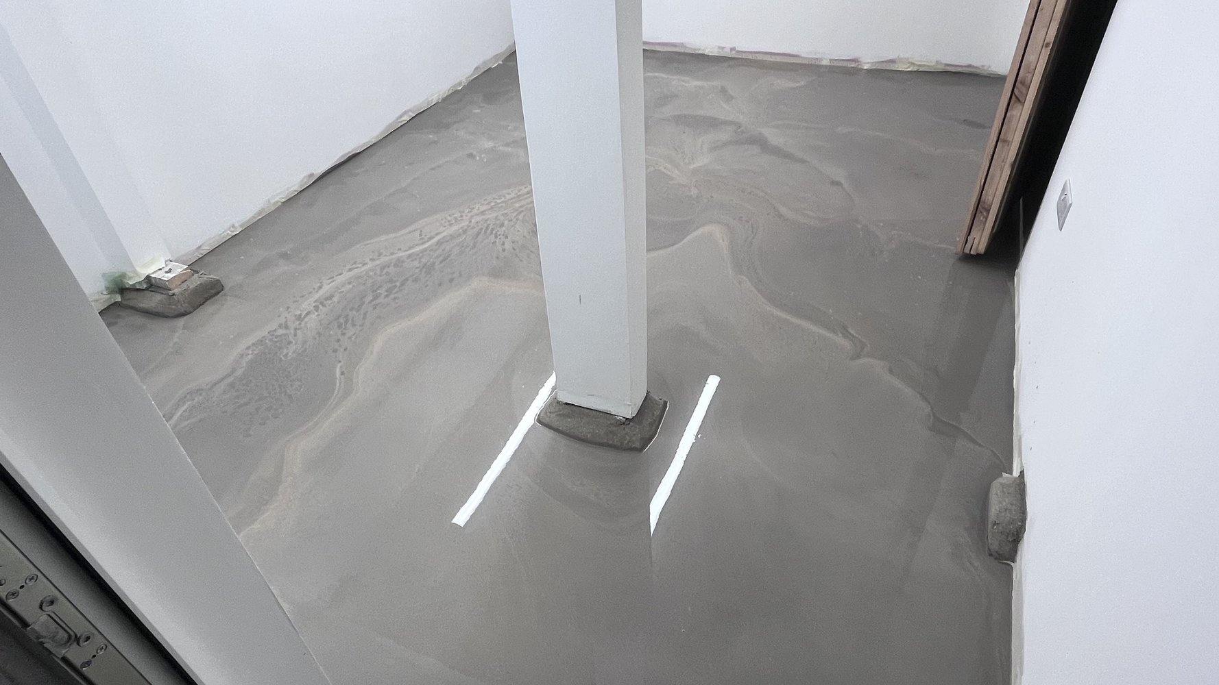

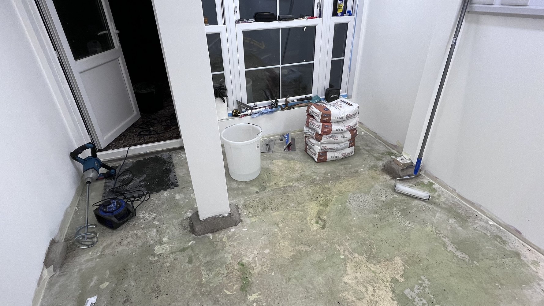

The floor was unfortunately rubbish in this room after the debacle with the delayed concrete delivery etc, so I filled the biggest hole with some sand/cement screed (it was about 40mm deep).
I want to be able to roll tool-cabinets etc around, so also needed to sort out the roughness in other areas.
After much research, I settled on "High Performance Leveller" by Setcrete. It's possible to use as a wearing surface (i.e no floor required), which suits my plans. Unfortunately it also cost 30 pounds a bag, and I calculated that I needed 10
The sacks of gold lined up:
Getting ready to mix. I figured I wouldn't have time to mix this with the SDS drill and paddle, so got myself an Erbauer paddle mixer specifically for this job - What a lovely, lovely, tool it is! Should have bought one years ago to mix plaster etc.
I made sure I had enough water on hand for all the mixing, and also a separate bucket to clean the mixer between "mixes" (can only do one bag at a time).
Floor was first primed with the Setcrete acrylic primer - diluted 4:1.
I was super worried about this, but in the end it was fairly simple. If you're doing this on your own, however, you _must_ ensure you have all the water etc ready to go for all your bags. The stuff goes off really fast.
The only weirdness was that in some areas I got these little pinholes once it was set - not sure what happened, because I primed as per instructions, rolled with a spiky roller etc. Anyway, No biggie because most of the pinholes are under where the bench is going anyway.
