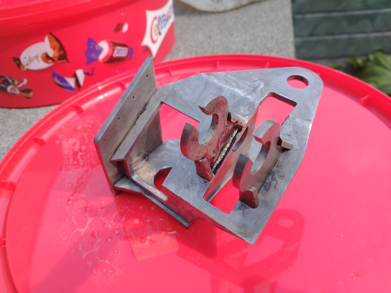

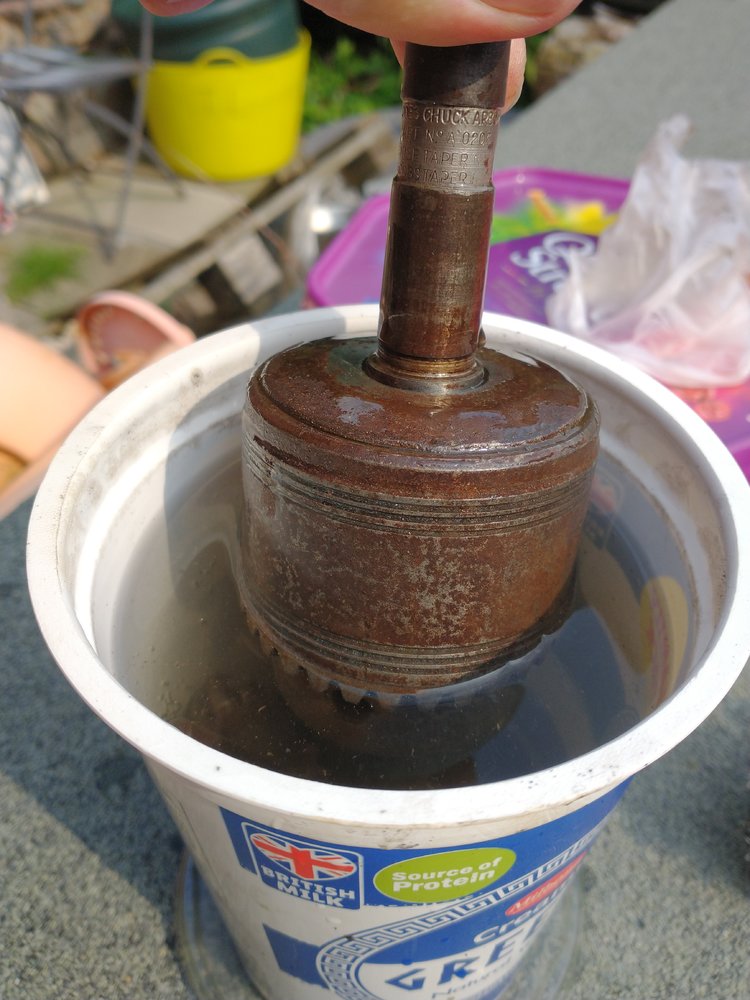

I have a bucket full of the stuff, and it's good enough on small fiddly stuff to warrant the price IMO, but still messy and slow like every other chemical de-rusting process.I would have to assume here that most posters to date have not actually used Evaporust!
It works much faster and better than Citric acid and does not require heat or anything.
As per the patent information above, Evaporust is effectively a citrate buffer, with a catalytic amount of phosphate, pH adjusted for best reactivity with Sulphuric Acid...I used evaporust on some Mercedes parts and was very impressed. Anything no matter how heavy the rust was came out totally rust free about 24 hours later. No agitating or heat required very simple. And those parts did not flash rust either even sitting for a couple of weeks in the garage. So I'd go as far to say there is a corrosion I hibititing finis on the part when fished out of the evaporust.
Like a citric acid bath that's been given every possible chemical advantage to live its best rust-eating life.
There's no corrosion inhibitors in there, and I know from experience that Evaporust cleaned parts can and do flash rust.
The pH adjusted nature of Evaporust will definitely reduce the likelihood of flash rust relative to any free acid.
It's also possible that the phosphate causes some conversion coating effect in the same way that Phosphoric Acid does, so if the container your Evaporust is in has a small skim of oil contamination, you're inadvertently giving them an ultrathin coat of black phosphate and oil every time you lift them out.
