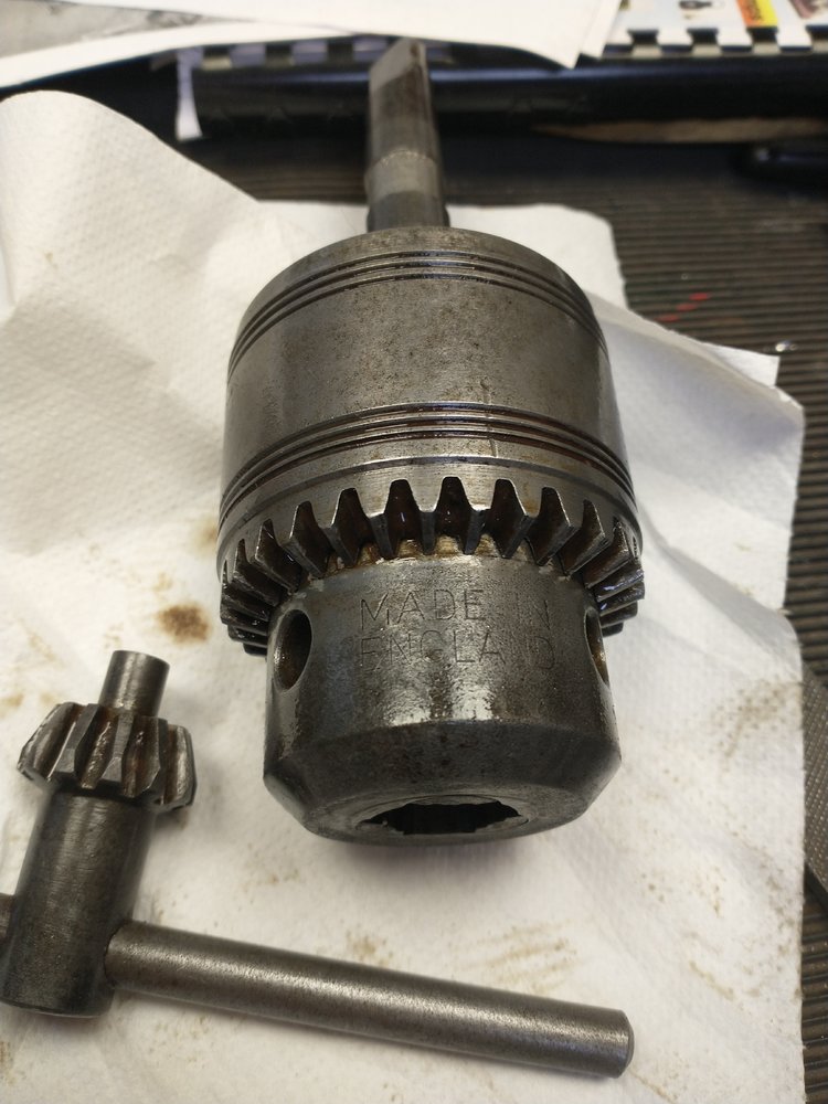

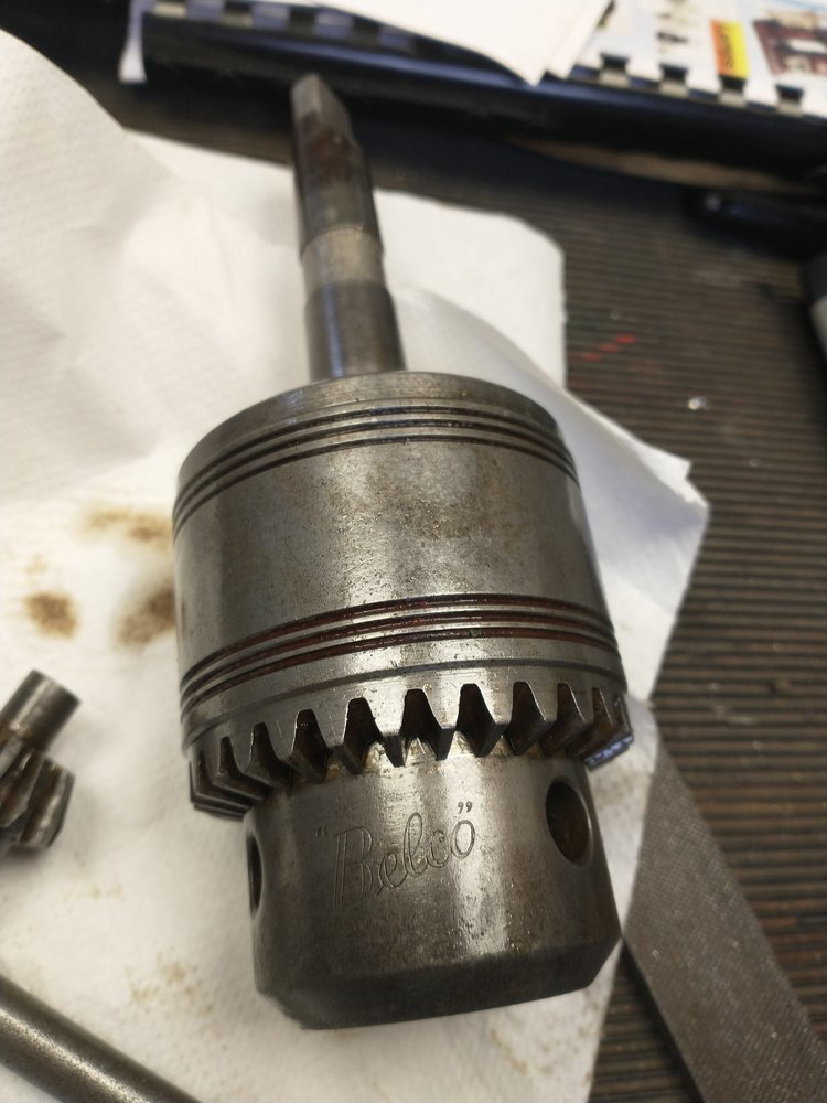

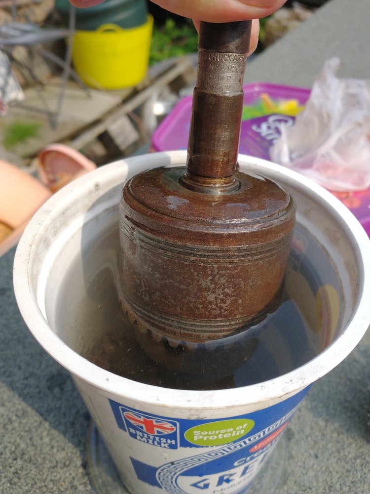

Which exact recipe did you use?And here's a drill chuck that had light surface rust
After
Worst side

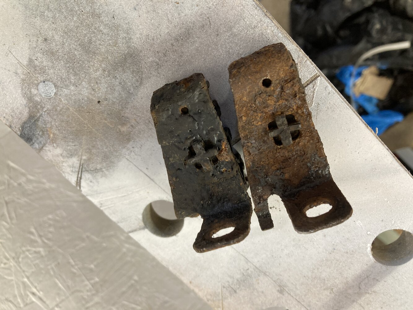

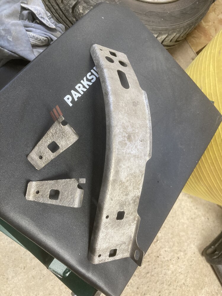

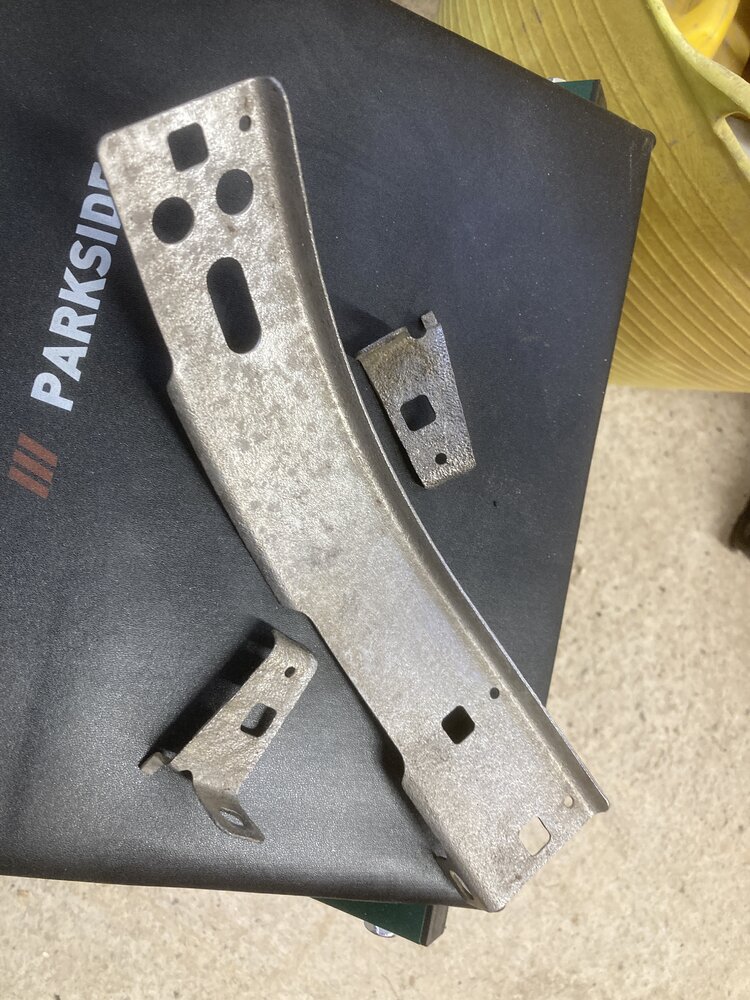

Seems a lot more effective than just citric acid and leaves a better finish.
This one as I had washing soda to hand.Which exact recipe did you use?
Maybe 10 or 20 cm3 of IPA to work as surfactant?This one as I had washing soda to hand.

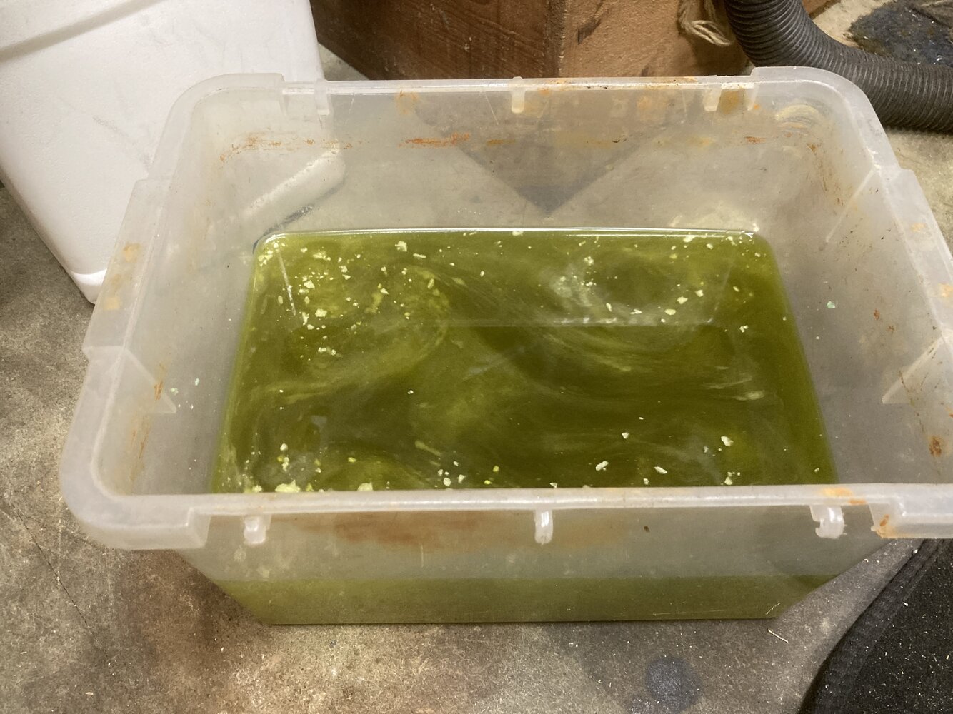

"To each liter of water, I’m adding 100grams of citric acid and 40 grams of sodium carbonate, also known as washing soda."
I didn't add anything to be a surfactant as I forgot! I wouldn't use washing up liquid as that has salt in it.
