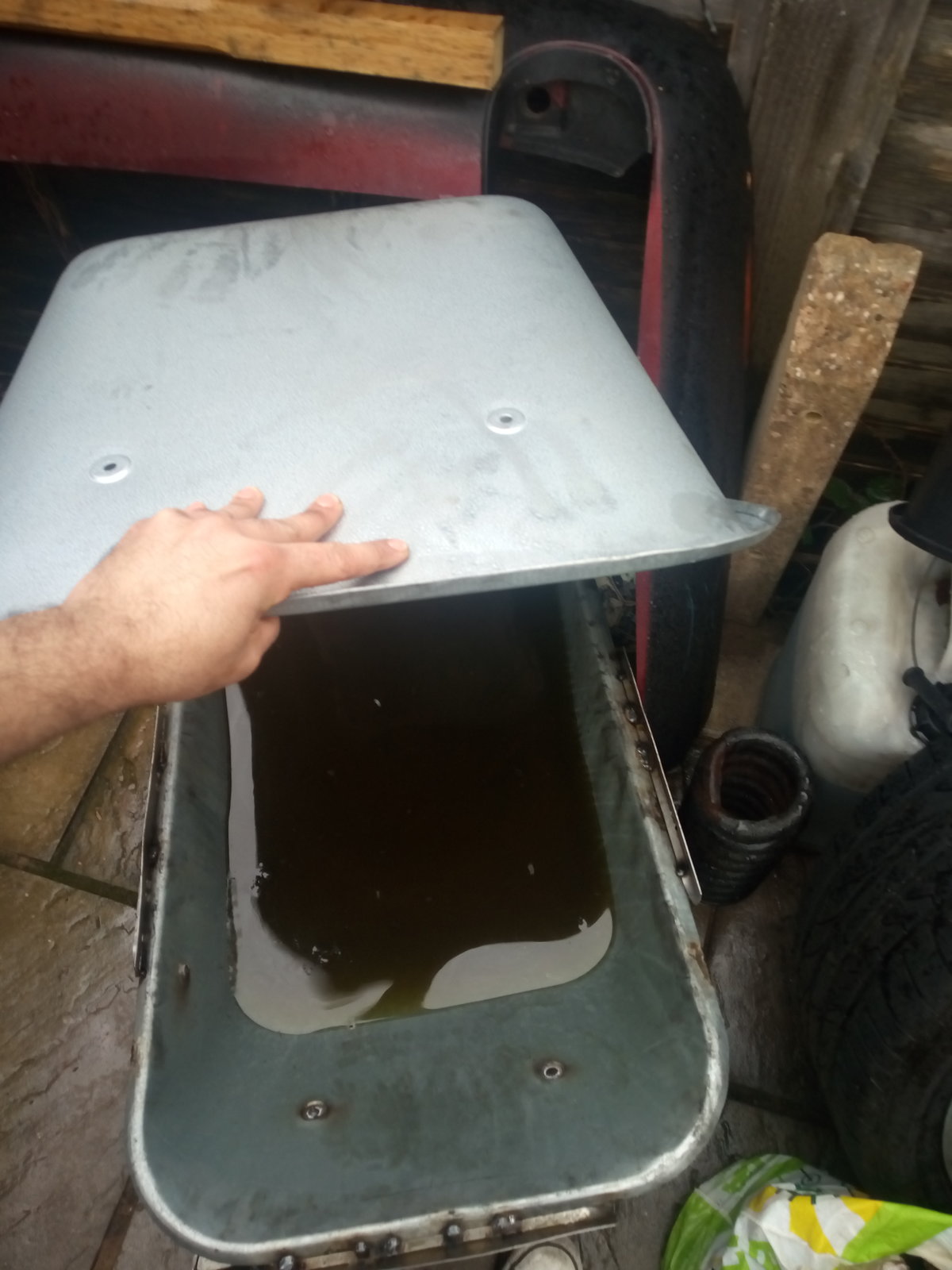

The citric made short work of that job ! That bracket might be iron rather than steel ?
Cast aren't they, calipers?
I use wheel barrow tubs for mine (get them free), one for the lid and 2 for the bottom, fits everything I need to derust
Currently got a brake disk backing plate thing in
What's that in there citric acid?
I didn't think it was too kind to zinc as in the barrow tub coating?
Assuming Deox-C is citric acid it says not to immerse anything zinc in it:

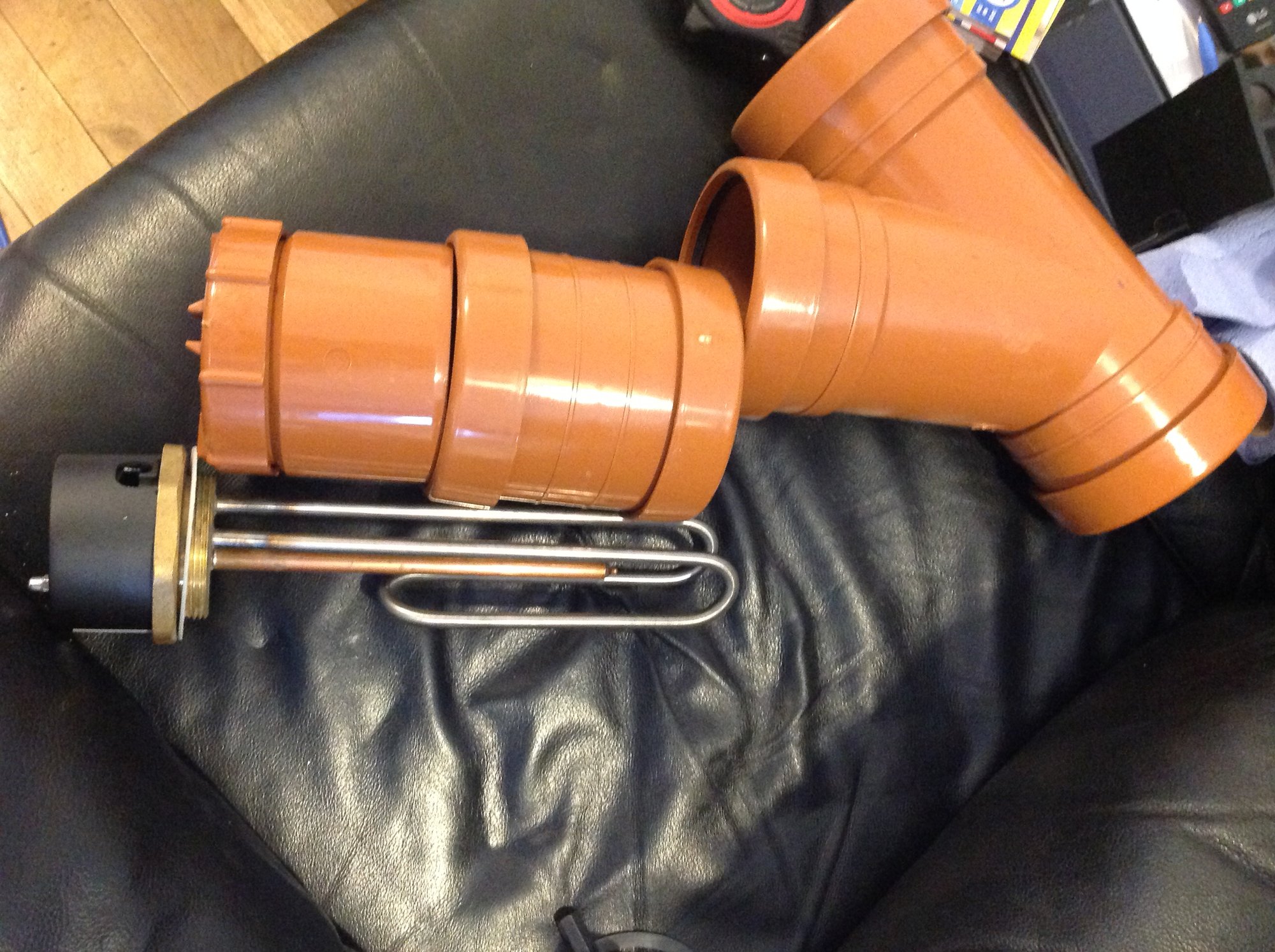

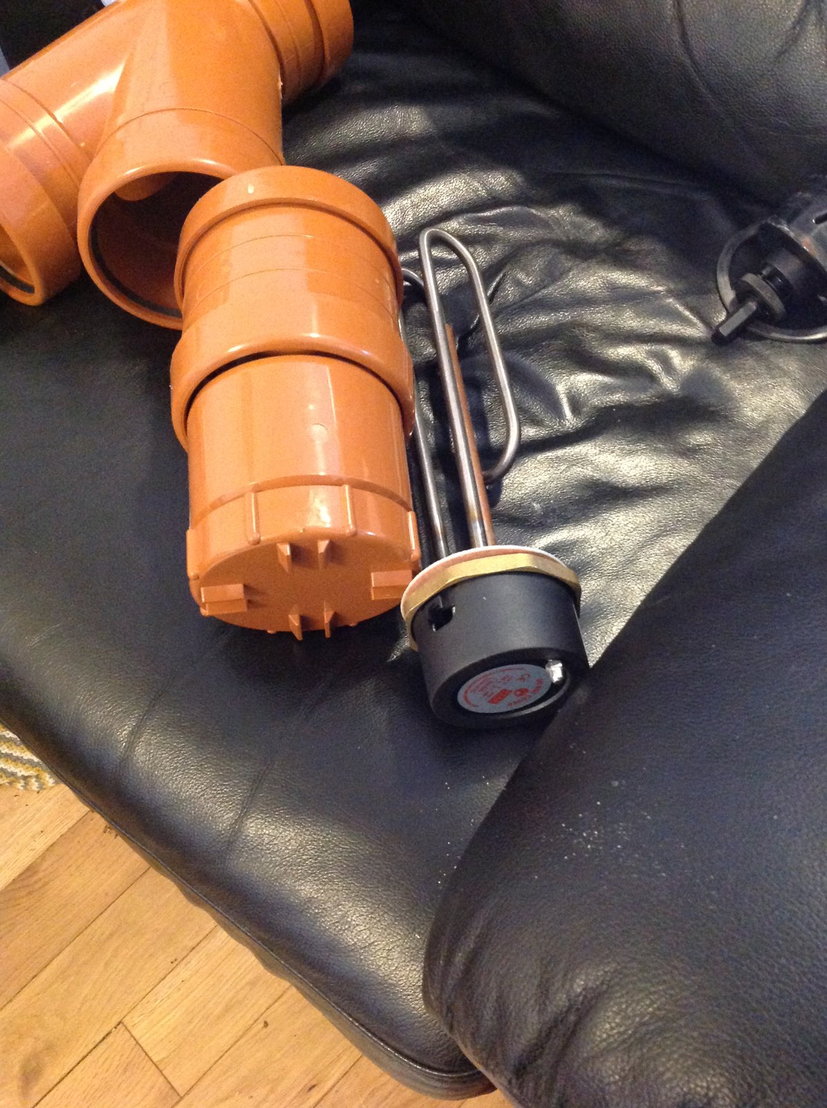

Ok so I've got some lengths of steel to deriust using hot citric acid , now today I've bought some 110mm waste pipe and fittings as per photo and intend to assemble 3kw immersion element , just ordered a lock nut/flange for the element .
Obviously the pipe will have a screw cap on one end and be inclined so as to contain the water /citric mix and steel
Inbuilt thermostat set at whatever say 50, degrees or whatever's optimum ,
Will be on a 16 amp plug and rcd and will seal up the element cover with silicone sealant to stop any rain ingress
Anyone see any problems ??
