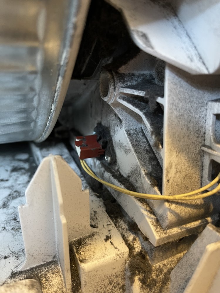

No digital display I'm afraid. Just dial and a start buttonIf it has a digital display it should be able to give a fault code, I replaced the stats and whole heater module on my hotpoint the "one shot" stat would go when it got to hot.
Checking each element individually with my £10 Screwfix multimeter on the 200Q setting yields a different result everytime so maybe the meter is uselessThat's almost an identical model to the one I'm currently trying to diagnose an issue with.
I don't think the stats will prevent it turning on, more likely it will give a heating error when trying to heat. Not there are two thermal cutouts and and thermistor. Use a DVM to check continuity of the cutouts and operation of the thermistor.
Check continuity of individual heating elements (24R). There's also another thermistor at front of drum.
I assume you've unplugged from the control board?Checking each element individually with my £10 Screwfix multimeter on the 200Q setting yields a different result everytime so maybe the meter is useless
Your option lights 'high heat' etc will indicate an error code...if it gets that far!No digital display I'm afraid. Just dial and a start button
Yes. I've taken the whole heater unit ojtI assume you've unplugged from the control board?
It doesn't get that far I'm afraid. We've got absolutely nothing coming up. No lights, chimes or anythingYour option lights 'high heat' etc will indicate an error code...if it gets that far!
That sounds more like something fundamental, have you probed the mains on to the control board?It doesn't get that far I'm afraid. We've got absolutely nothing coming up. No lights, chimes or anything
Just literally got in and bought the tester with me. I'll have a go in 20 minutesThat sounds more like something fundamental, have you probed the mains on to the control board?
I had this with my old Hoover condensing drier. it turned out to be a faulty cap on the circuit board PITA to get out but easy fix. Can you post a close up picture of the board?No digital display I'm afraid. Just dial and a start button
