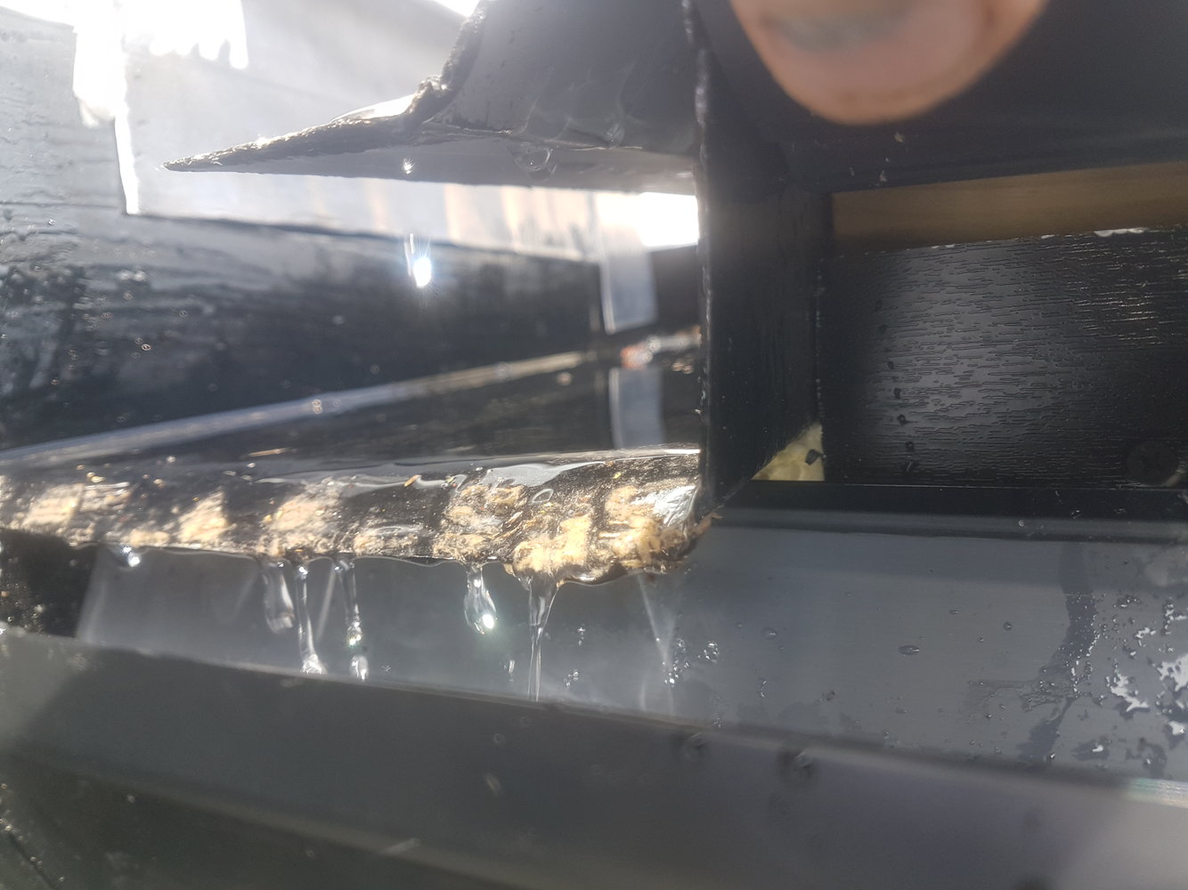

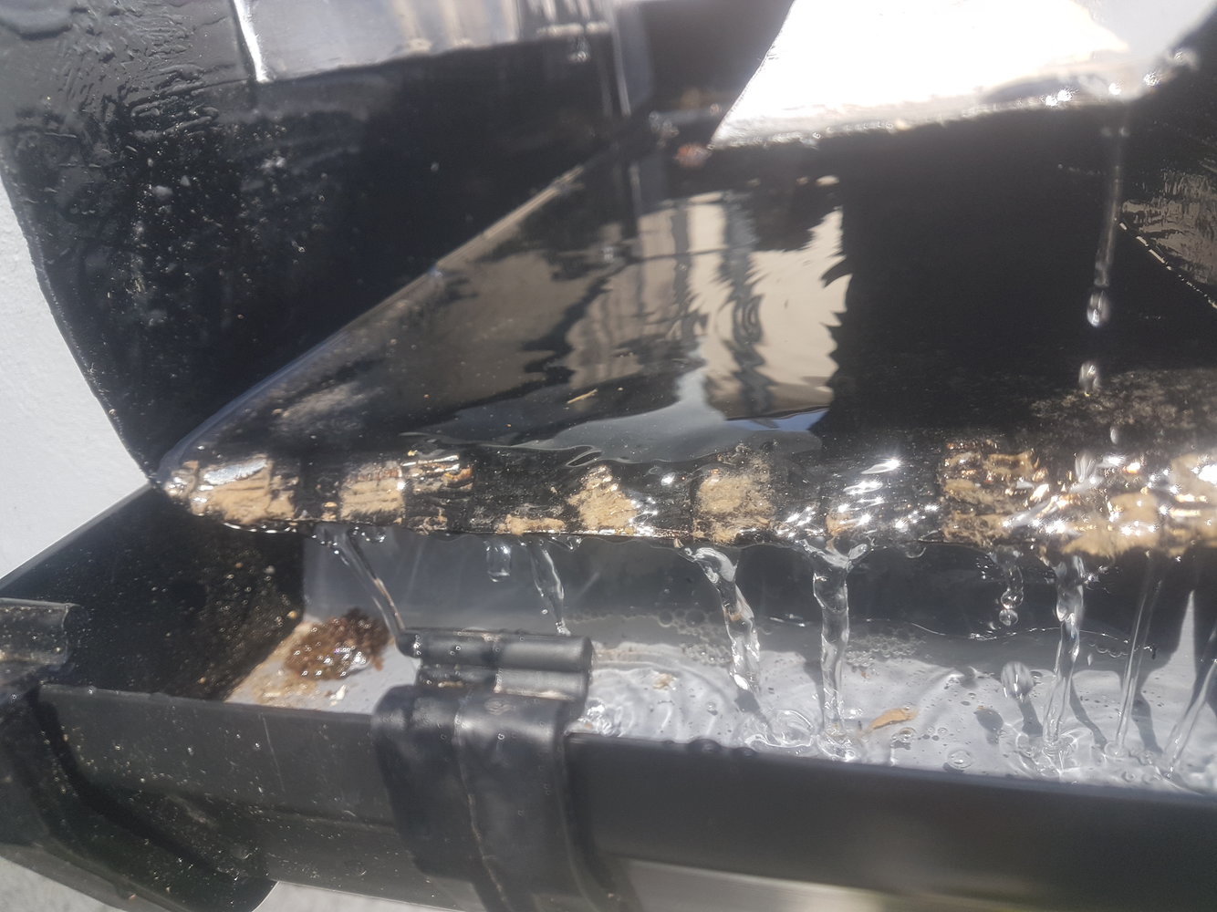

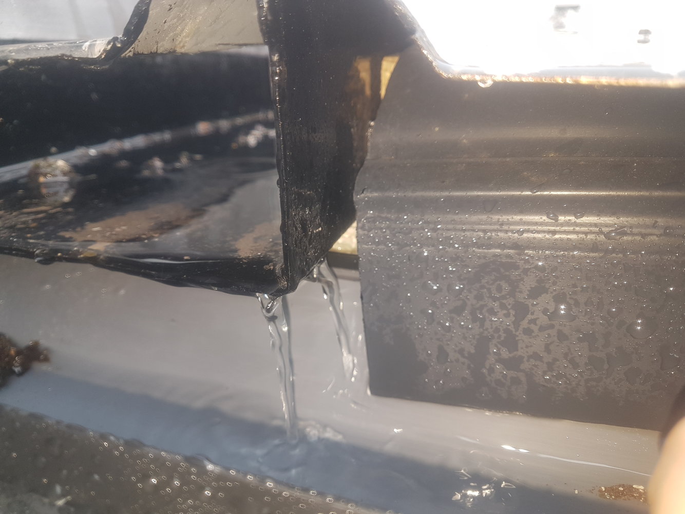

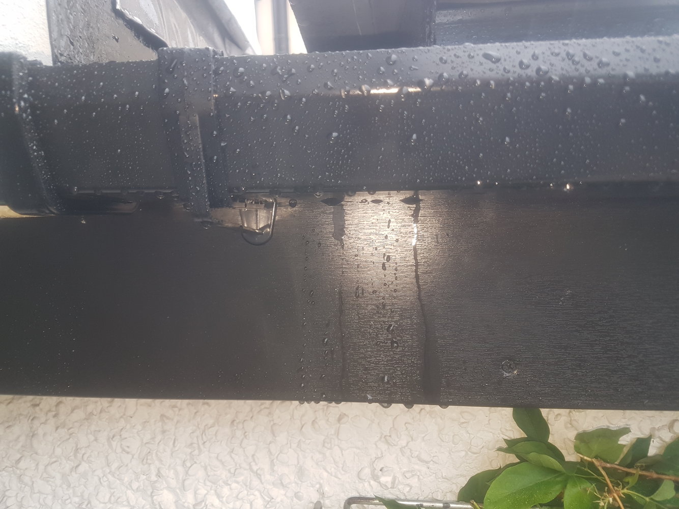

Well I have plenty of foam here to go on my gun so I best get my butt up there and foam it all. So it's all the high edges under the corner trim.
Grab the last 10mm with vice grips and bend a lip into it right across the full width...sortedJust deciding what would be best.
Cut and bend it down a few degrees
Stick a length if the eaves protector onto the bottom side of the metal box gutter
Or another way open to suggestions
View attachment 288982 View attachment 288983
A lip down towards the gutter I presumeGrab the last 10mm with vice grips and bend a lip into it right across the full width...sorted![]()
yea a full 90 degree lipA lip down towards the gutter I presume
I will have to cut into it 10mm thenyea a full 90 degree lip
Why will you need to cut it?I will have to cut into it 10mm then
thanks mate we are getting there now.Excellent work,
Overcoming 'The Problems' is what makes it.
it actually runs along the right side so good shout it may work just by bending without the cutsyou coud try what roofman said
if most of the lip is bent down words water should travel to the lowest point so as long as the middle of the tray is lower than the sides all the way along the full gutter
eg if the water normal runs along the gutter in the middle of the tray as its the lowest point or does the water run a long the sides ?
Whats your email so i can send my consultation invoiceNo problems at all now since bending that box gutter down. Only problem is the water butt fills up so fast
doh! lol,Whats your email so i can send my consultation invoice![]()
