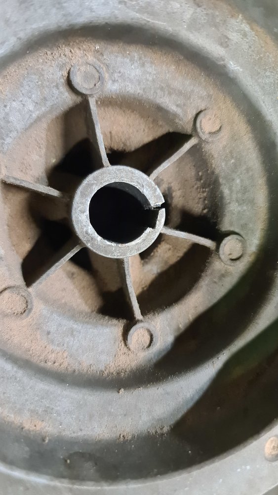

That’s a very good suggestionSleeve it as is and cut a new key 180 degrees away.
Bob

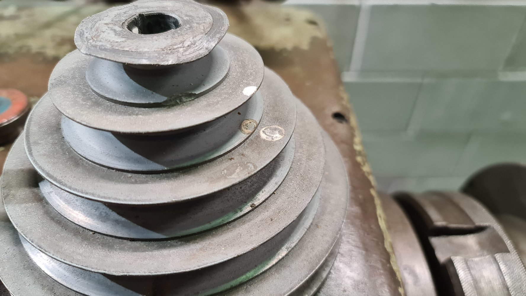

I've got a similar problem on my 2g, difficult to find anything close to the 5 step pulley with large bore. I'll be casting a cone and machining when I get round to it.It's off a progress 2g drill. Hard to find and turning up from the solid not very easy.

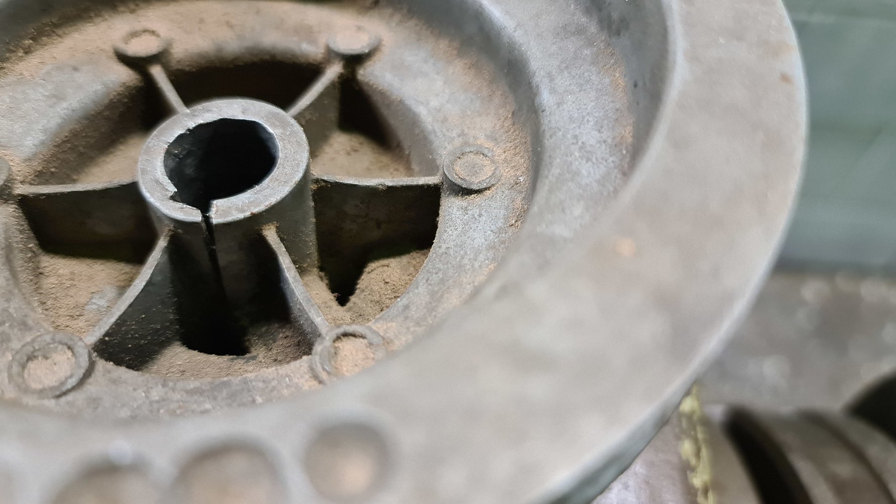

Its a bodge Parmster, would you expect anything else from a member on here If it was sleeved you could dribble some araldite down the old keyway to beef it up.That’s a very good suggestion
I would need to bore it first? Very thin at the other end. If I sleeve it without boring how do I get the motor shaft in?Sleeve it as is and cut a new key 180 degrees away.
Bob
There is hardly any thickness to play with the other end.Yes, bore it, sleeve it and cut new key on the opposite side.
Bob
Cheers!I might have one you can have.
Put down the sizes on the pulleys, shaft and key
Failing that machine 5 separate pulleys
