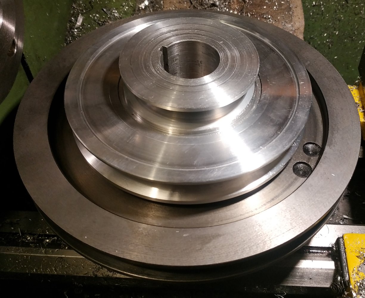

That is a lovely job!What is the length of the whole thing and ID of each step?

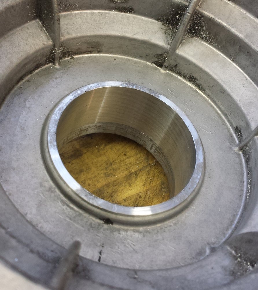

No way I would try to repair that, it looks rubbish zinc more than aluminium.
Its about 15 quid worth material to cut a new one from solid alu, and quite enjoyable.

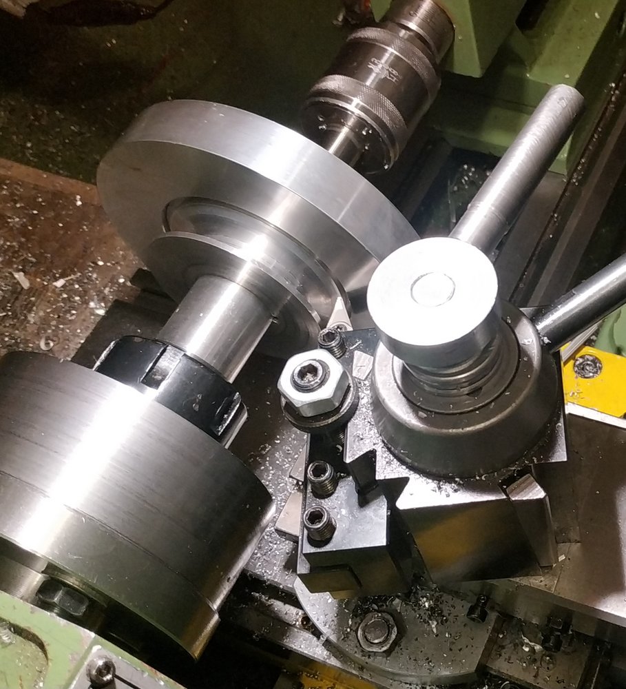

I would cheat. Central shaft and the first pully as one peice. In my case the bore was 28mm, first pulley 63mm and hub OD 75mm. The remaining peices to shrink fit from suitable diameter bar. In bigger sizes cast iron taper lock pulleys are cheap and I bored out a 180mm one, shunk fit it onto my 3 step hub for the lathe spindle.
Having each pulley seperate for turning helps as you can use a VCGT1604 tool straight in and it will have the edge length for it, and you wont have clearance issues with the tool post hitting the bigger steps. Id already turned the small pulley in pic before shrink fitting but it shows the problem.
Then the big pulley
It's off a progress 2g drill. Hard to find and turning up from the solid not very easy.
And yours! Very nice.As above.. make you own

Thats how i did it... work out the off set between, then parted down...no cnc here, took a couple of evenings and a lot of swarfAnd yours! Very nice.
So what is the secret? Parting tool down to the id and then topslide at an angle for the tapered sides?
Be very easy on a CNC![]()
Thanks! I enjoyed it. Recommend you make one as it was a nice job to do. Not often I get to do big deep cuts in large lumps of aluminium.That is a lovely job!
Wheres the fun in that. VCGT1604 tool straight in and side to side to rough out then topslide to finish. The tool is 35 degrees and belts need roughly 36 depending on pitch diameter, thats what I remeber using.So what is the secret? Parting tool down to the id and then topslide at an angle for the tapered sides?

Having just read all this, that's pretty much my thoughts - although I might use ali for a straight bore sleeve, warm it up with a air gun and slide in on. Less weight spinning around on a motor shaft.Squeeze it back to shape, machine down the outside through those ribs, machine up a steel sleeve to go over the outside, tight fit and slightly tapered inside, press the sleeve over the outside with some araldite/locktite/whatever, worth a try maybe, easyish, what is the worst that could happen............ I think that is monkey metal so hard to weld with technoweld etc.
