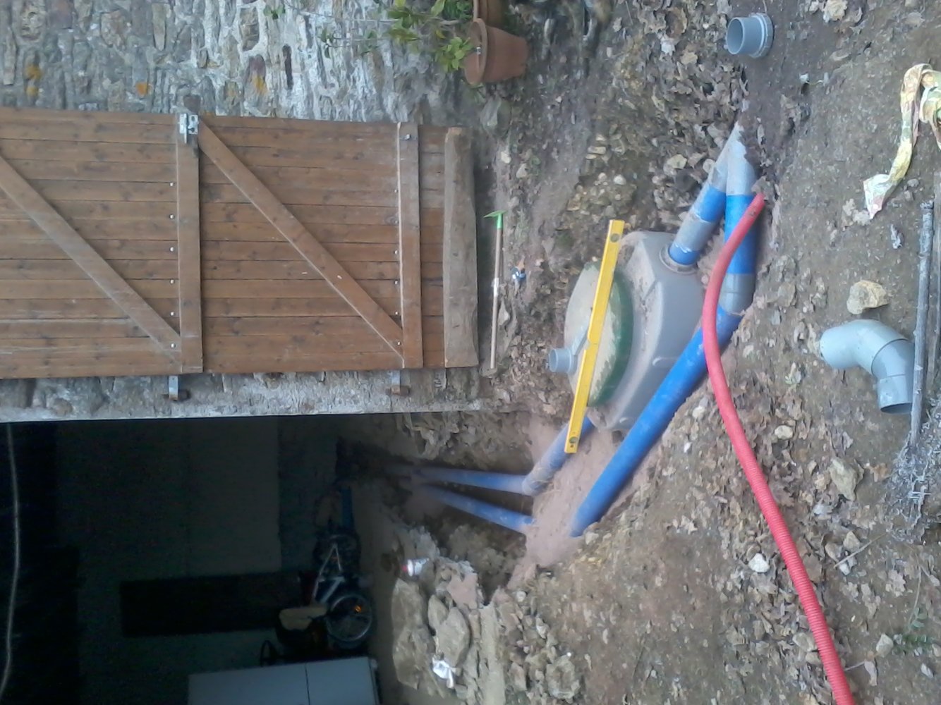

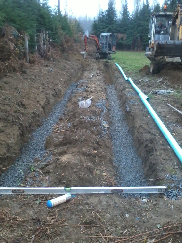

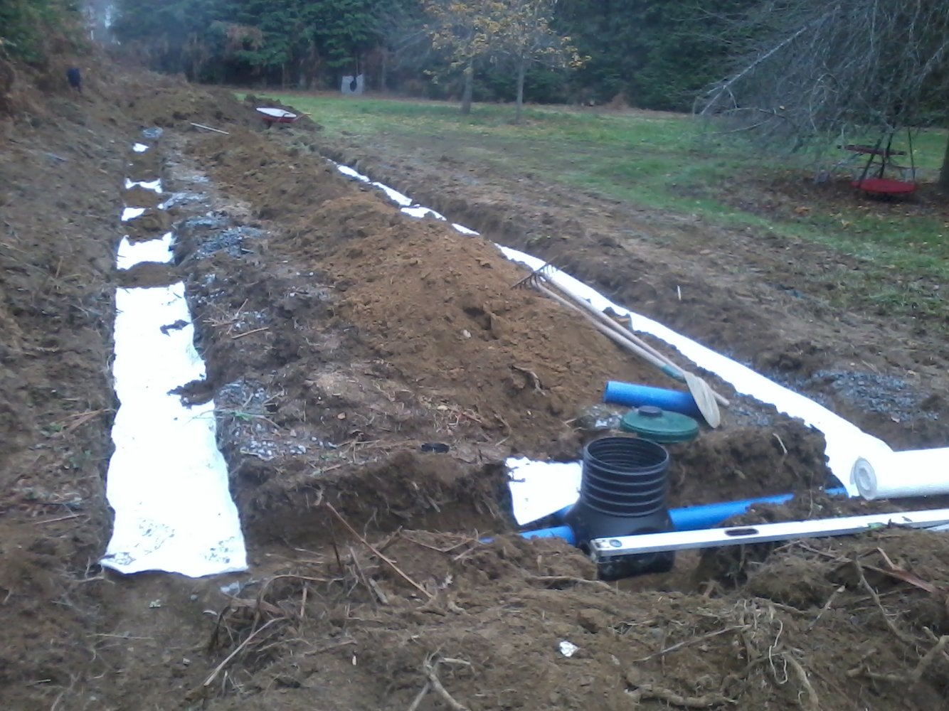

I've rodding points everywhere, max length 10 meters between rodding points, six years + now no real issues, except once or twice when my disabled son blocked the loo, with a ridiculous amount of loo roll.Best get a decent power washer ( 150 bar ) that can handle a 20 mtr drain cleaner hose on the end of it's normal length of high pressure hose .

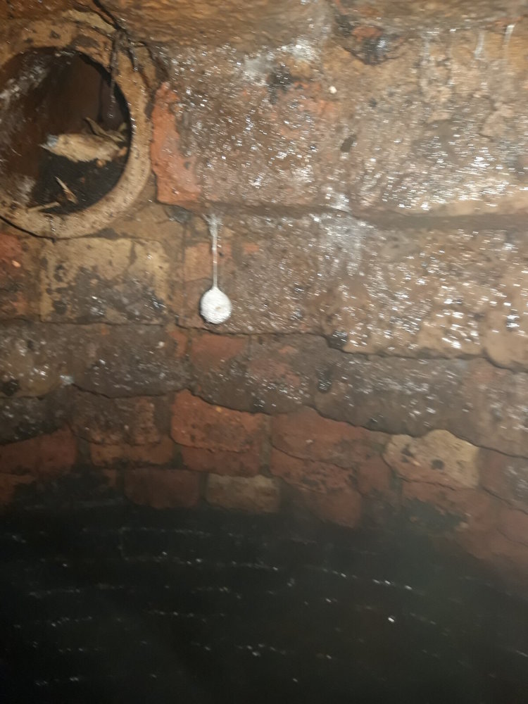

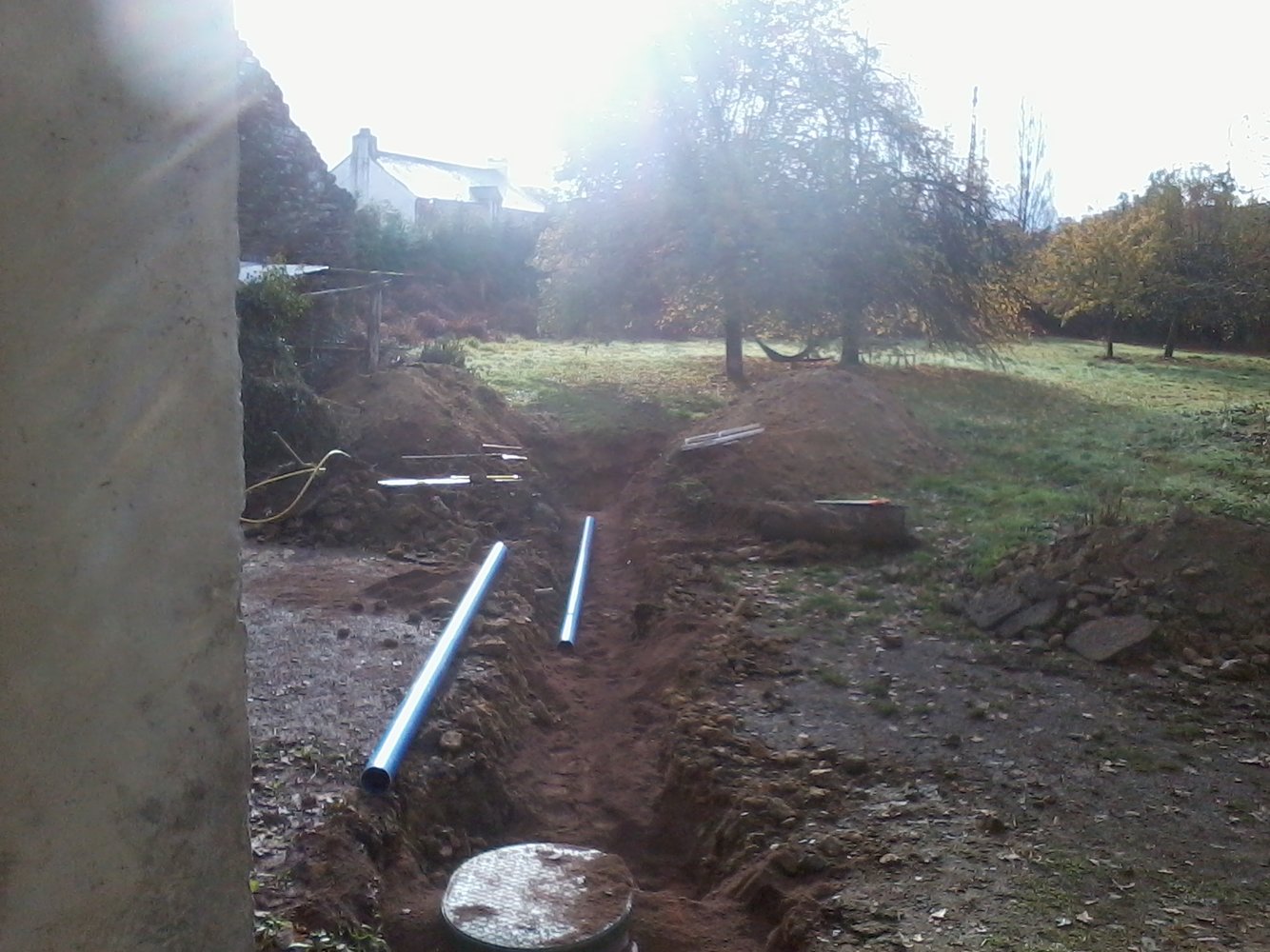

I had to run my hose & extension hose c/w cleaning head down 30 mtrs of 25 mm ID blue alkathene water pipe I'd inserted in the drain bit by bit with the washer running as the 100 mm diameter was too big for the cleaner head to pull itself along much past 20 mtrs to reach the blockage which was five feet back along my pipe run down a six foot deep manhole full of crap & a sanitary towel blocked exit (thanks neighbours
