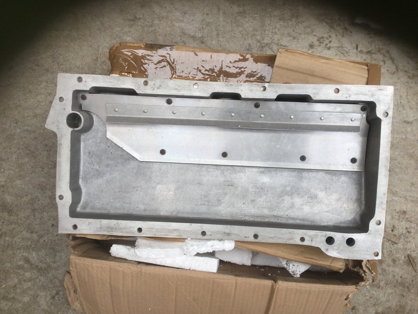

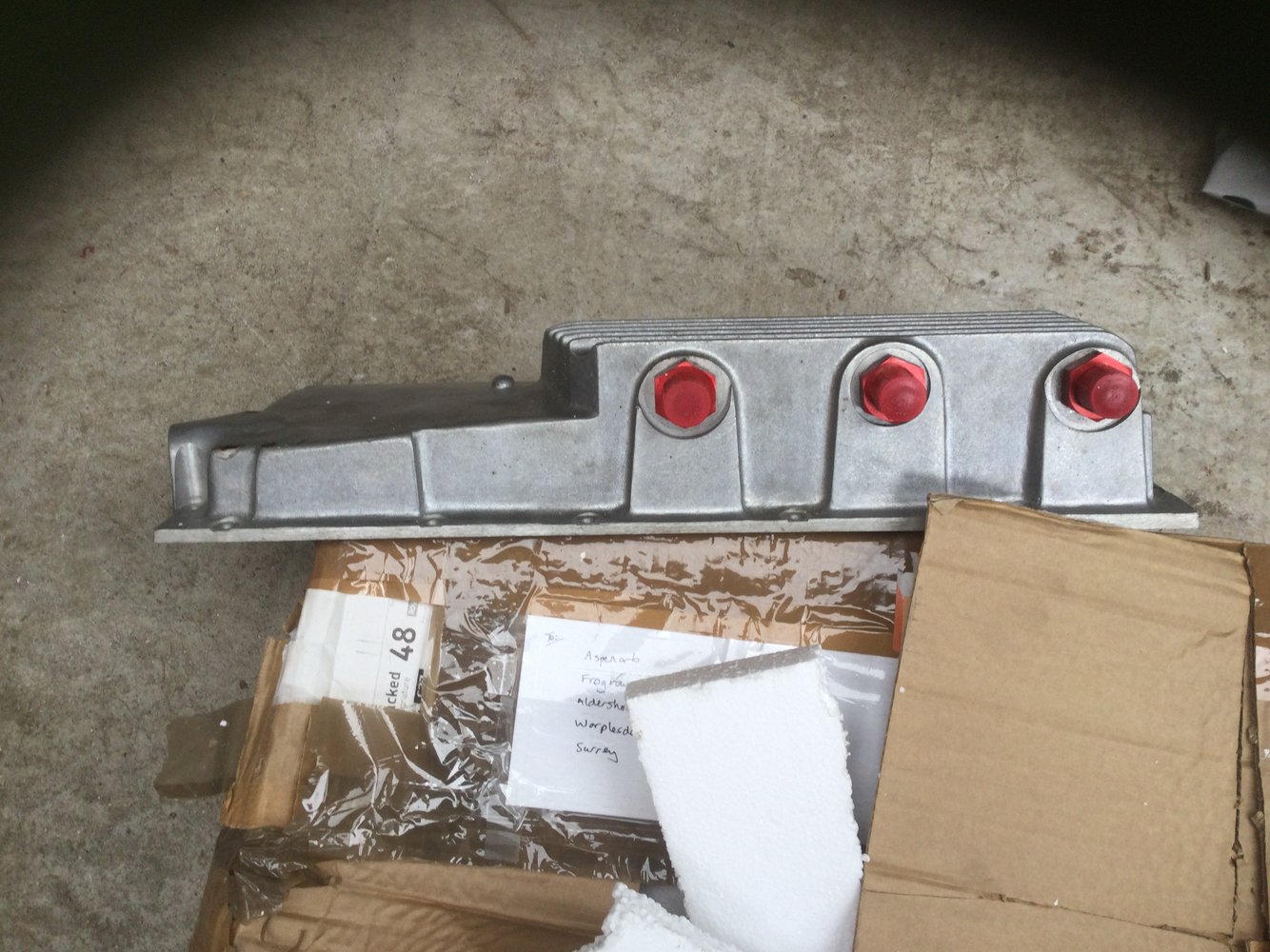

I still have the option of designing the front form rockers to raise it an inch, but I don't really want the whole shebang raised higher if I can get away with it.Probably easier to extend the forks a couple more inches put the front wheel on a block and measure the clearance.
I could probably get by as it is, but an extra inch or so makes all the difference. Ooer mrs.....What is the clearance ? Does not look that bad from your picture in post 1, although pictures are obviously deceptive.
as said by others just add a bash/ skid plate
I'd make any skid plate "sacrificial" and easily replaceableI could probably get by as it is, but an extra inch or so makes all the difference. Ooer mrs.....
I have though about some sort of skid plate, so I may revisit that idea.
I’d make it with titanium blocks on so it sparks like fk!!I'd make any skid plate "sacrificial" and easily replaceable
Where are you getting the 3.5” from Bob?If the sump does get chopped oil level needs to be at least 3.5" below the sealing face/flange of the sump, thats to stop the crank turning the oil to foam. Thats providing the engine hasn't got a stroker crank fitted. Looks achievable.

Is that calculated on something? Ie different for each engine?
Is that calculated on something? Ie different foe each engine?

MoneyCan you dry sump it? What’s involved? Never done one but had a few bikes that were.
