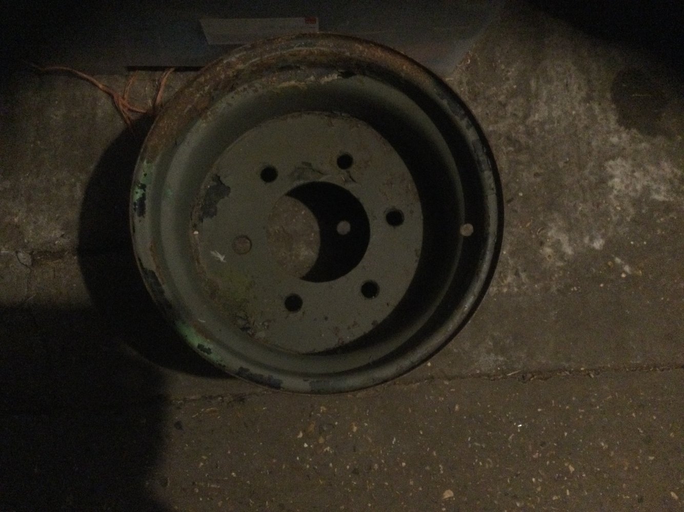

For those that don't know, the 101 is six stud, so no common alternative rims, apart from the previously mentioned unimog rims.
Thank you
You are in luck Julian, I have just checked in the wheelery and there is a set of five 101 15" rims. A bit scabby but they will clean up, they came in a pile of 101 oddsnsods I bought. PM me if you are interested.

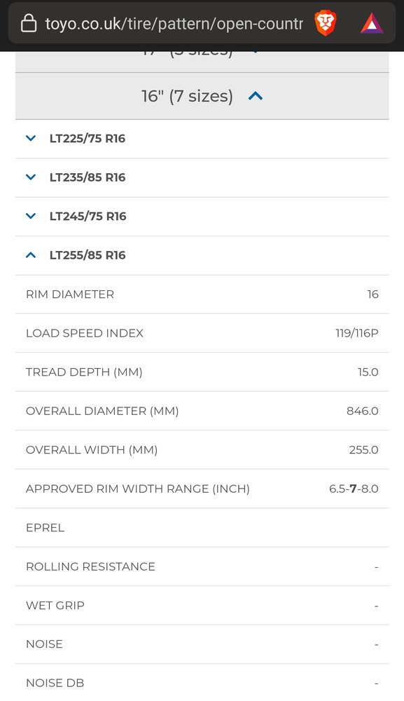

@julianf 255 85 x 16's are available from the likes of Toyo, set of 4 new ones are about £500
Mathematically they work out at 33.7" so fairly close to your 34" target

Yes, those Toyo tires will fit. The specification includes 6.5" rims.
I've just measured the Goodyear bar grips, and they are about 890mm, so the Toyo tyres are a little smaller at 850. The vehicle will be an inch lower.
