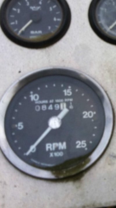

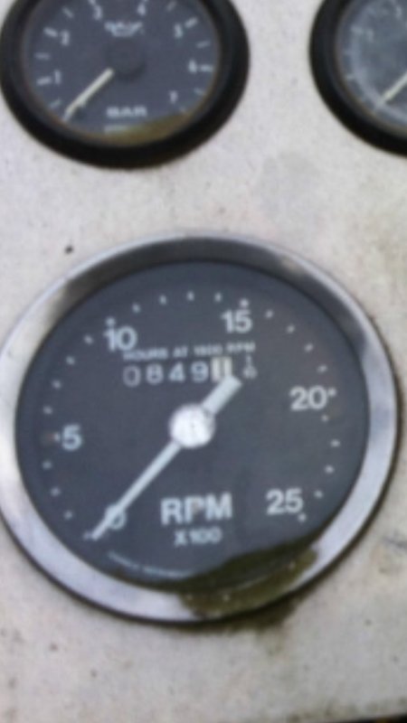

christ 1200 for that it says light use from a n x engineering college whats that suposed to mean it hasnt been on a site and hasnt done hard work pm him and ask him how many hours its run as its fitted with an hours counter
Spot on Daniel - it's been listed 3 times that I know of without a nibble, ( which is probably saying something ), hence my post just to see if there was enough info out on this machine for parts and of course it's viability as a project. Historically it seems that this model had its issues, which leads me to sway towards the negative

Your old Dorset should be rated at 80hp ~ 200+ cfm when new. Don't discount it entirely on appearance , the missing tin work can be replaced fairly easily. You need to give it a thorough check over, especially it's cold starting performance, condition of the engine oil and coolant - rusty water is not a good sign! Also check the condition of the radiator, it will cost a bit to recore. As mentioned above, give the machine a good long run to check for overheating and over pressure in the water jacket. And squeeze them on price, it's an old machine from the 70s.
