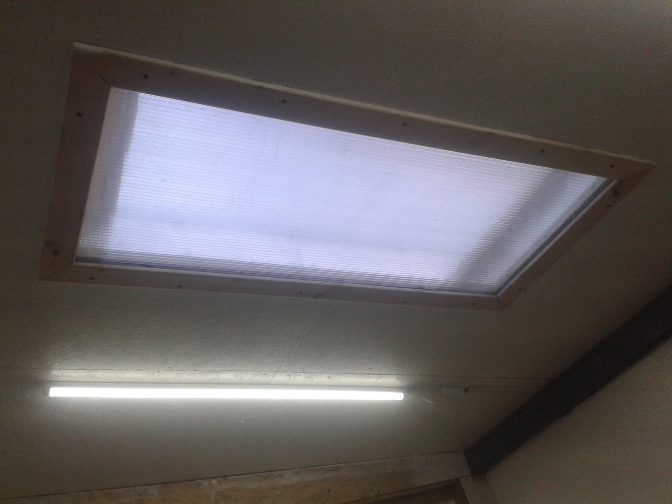

as goes for the window lights id make a frame up to the size i was wanting and just do what i did
but i didnt seal the panels as they need to come back down to clean them every now and again
thats why ive shown you what i did 8ob roughly followed the same reference it does work and it throws alot of light around
once you start to insulate you will block alot of light but you can gain alot back add some led strip lights and it will be bright in there more than you think

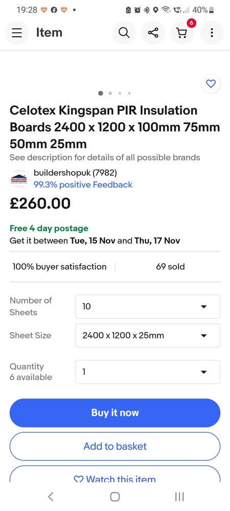

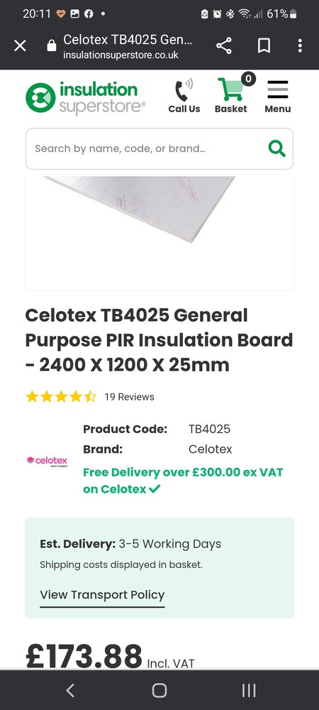

Is there a manufactures data sheet that gives the R value of the different thicknesses?Certainly playing with cost v thickness.
I was set on getting 75mm at £26.50 plus vat.
Then someone threw a curve ball and said they have 12 sheets of 100mm 8 x 4.
I asked the price and they want 40 quid a sheet. (With scuffs and dinks in them although new)
So I checked this morning and the place that has the 75mm also has 100mm in stock that works out at 42 quid INC vat.
So unless the guy reduces his price I am not going to buy his for 40 when I can get brand new (no drinks etc).
BUT and this is my dilemma. How much better are the 100mm.
I know they will be stronger but I don't think 75mm will sag or snap over a 1.85metre span. Are they however much warmer.
How do I gauge the extra thermal values against cost. 420 quid v 318 if my maths is correct.
Assuming the same material for each it’s directly proportional to the thickness. 100mm is going to be 33% better than 75mm. Which is almost exactly reflected in the price you quoted.How do I gauge the extra thermal values against cost. 420 quid v 318 if my maths is correct.
