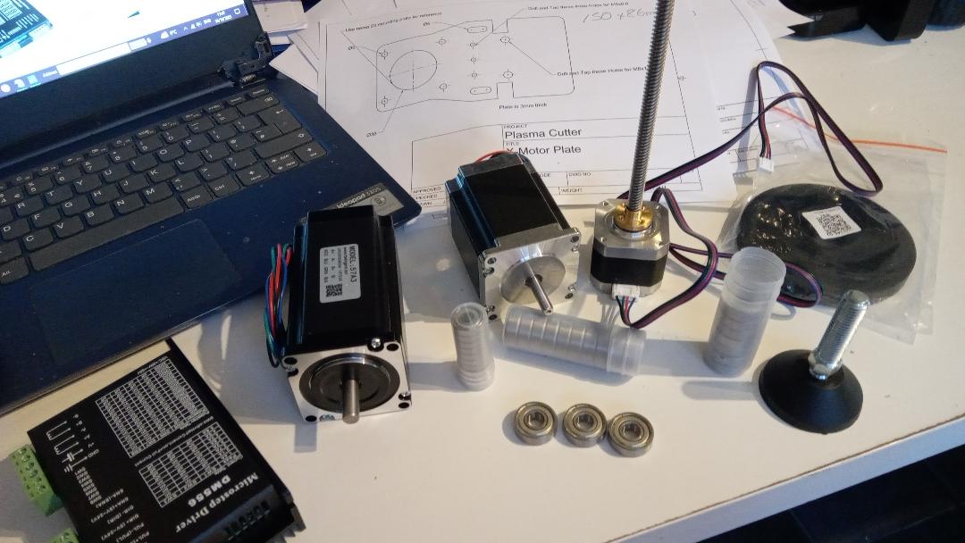

im going to make a few changes to the sizes, plans as supplied give a cut area of 800mmx700mm im going smaller either 600x600mm or more likely 500mmx500mm, also im not putting the legs on it can sit on one of the benches and hang on the wall when not in use, ive looked back at what ive bought in from my local engineering firm over the last few years and nothing bigger than 200x200mm so i think i can live with 500x500 bed, given that 2mx1m is a stock sheet size i can get the stock holders to chop into 500mm squares, if it all works i can always biuld a 2mx1m bed another day,
and the plans call for 50x50x1.5mm box, im using 2mm wall for the y axis and 1.6mm wall for the x axis which is 200mm shorter than the plans

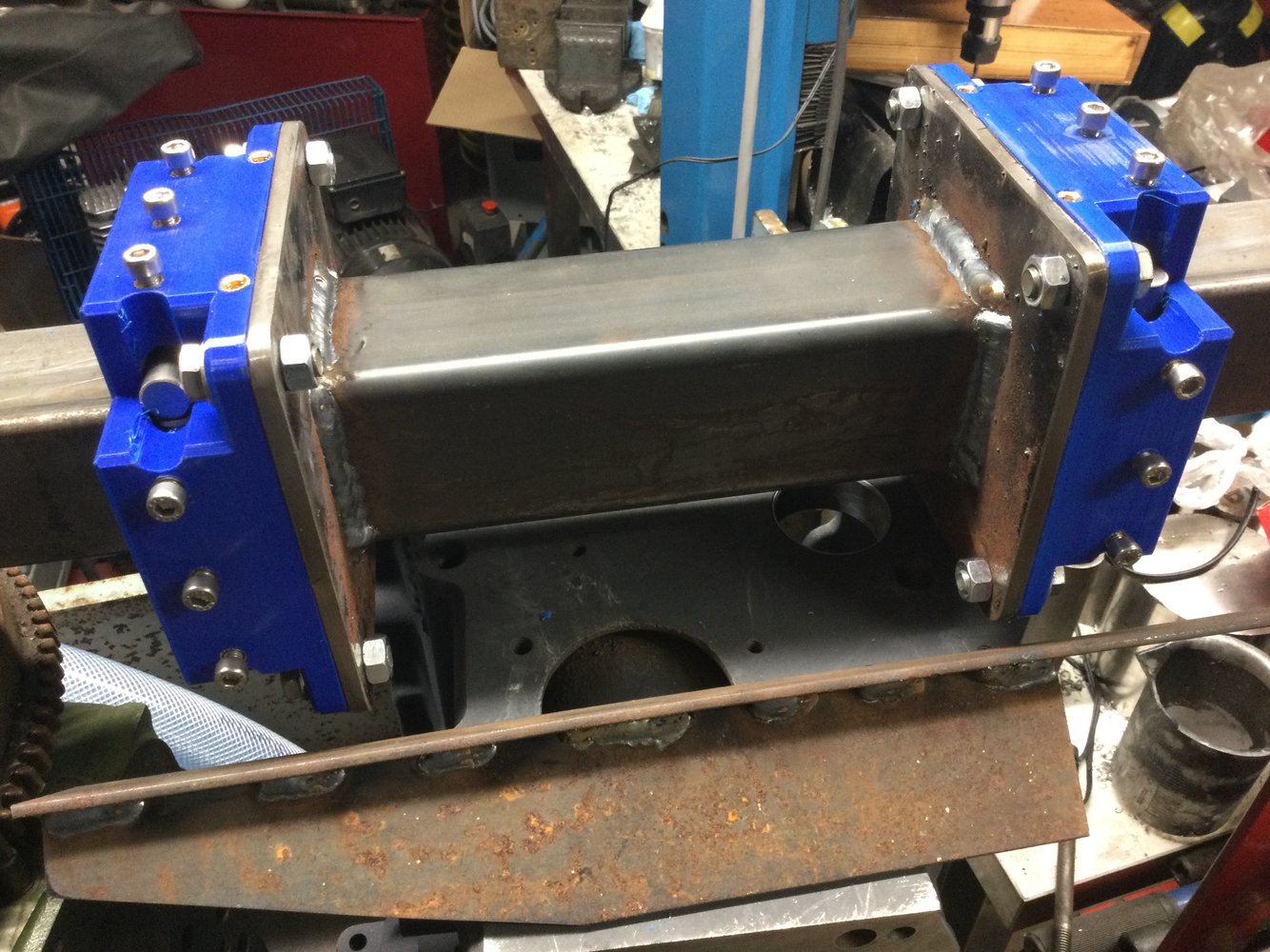

I'll also be welding most of it together, with the exception of the Y axis double rails, X arm and X bearing support rail. Partly because I don't want to put heat into what are pretty straight tubes, but also because I'm impatient and have already blued the rails...im also thinking of welding most of it together rather than all those bolts including the x axis arm onto the 70mm carrier, can you see any issues with doing that ?

i might do something similar to that and im still considering whether to weld or bolt on the x arm to the carrier. as you say if its bolted it adjustableIt’s worth making the x axis removable so you can adjust for square and also if you want to pack it away it’s a smaller footprint. I have welded the plates onto the end for the bearing carrier and skimmed them flat though.

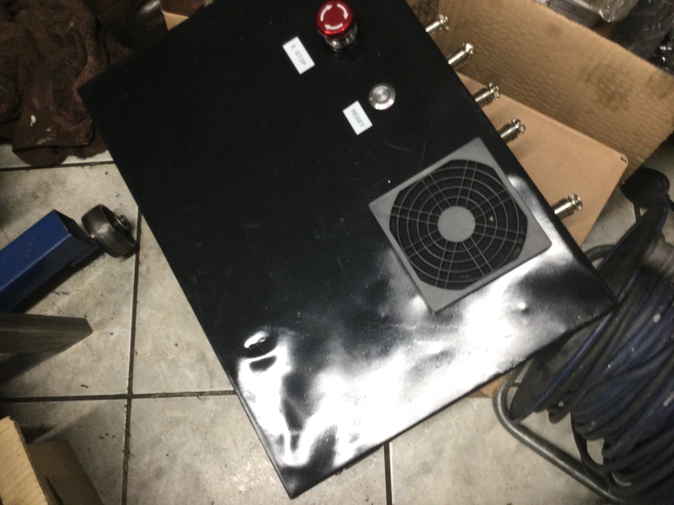

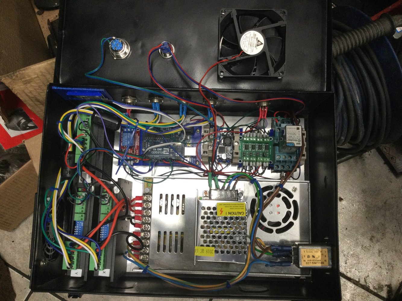

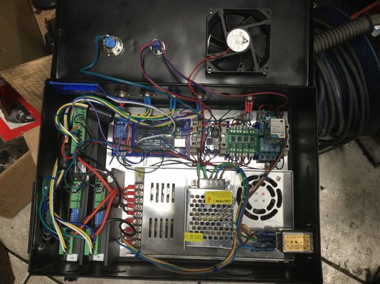

are there limit switches ? i was looking for them in the plans but couldn't find themJust talking about control box and 24v, here is mine, 24v latching relay for the E stop and also the torch height and limits if I bother with them, interfaced with an opto isolator board and will use Nc contacts. The box is an angle grinder box I had.
View attachment 421702 View attachment 421703
How powerful are the motors you are using? JD's said they didn't bother with limit switches as the sizes they use just stall and do no damage when crashed.Just talking about control box and 24v, here is mine, 24v latching relay for the E stop and also the torch height and limits if I bother with them, interfaced with an opto isolator board and will use Nc contacts. The box is an angle grinder box I had.
