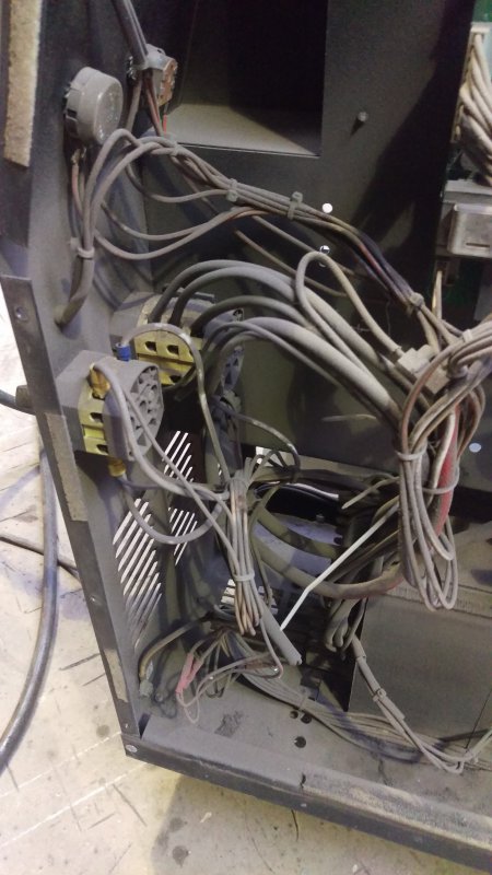

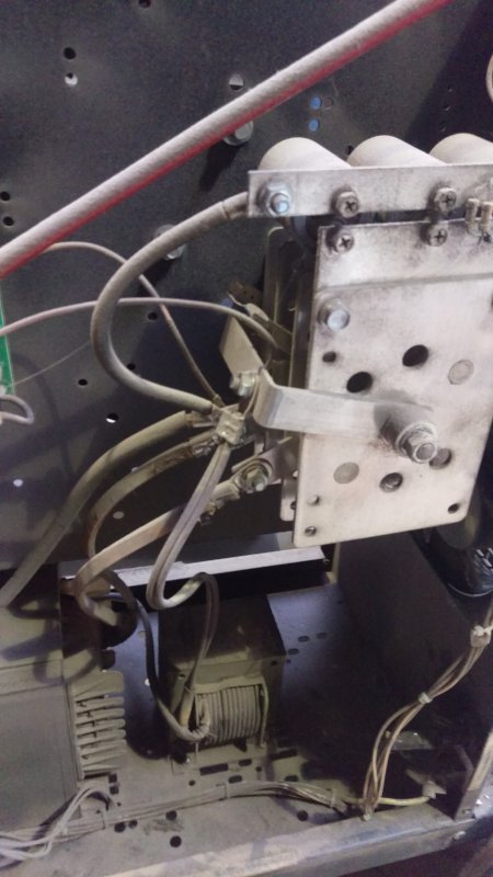

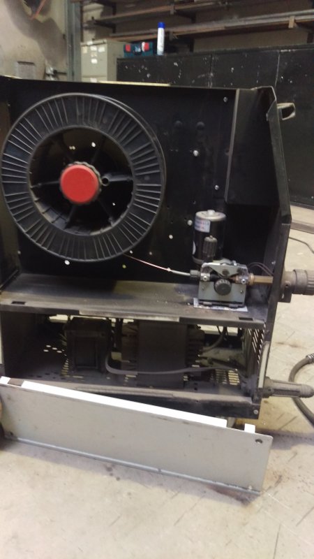

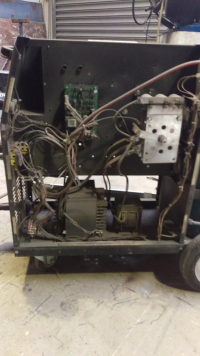

I got the 110v plug on the machine yesterday and a spark installed a socket for it. I also opened up the machine to check polarity but I couldn't see anything in it where it could switched I'm going to send photos at lunch time of the inside to see if you guys could spot it

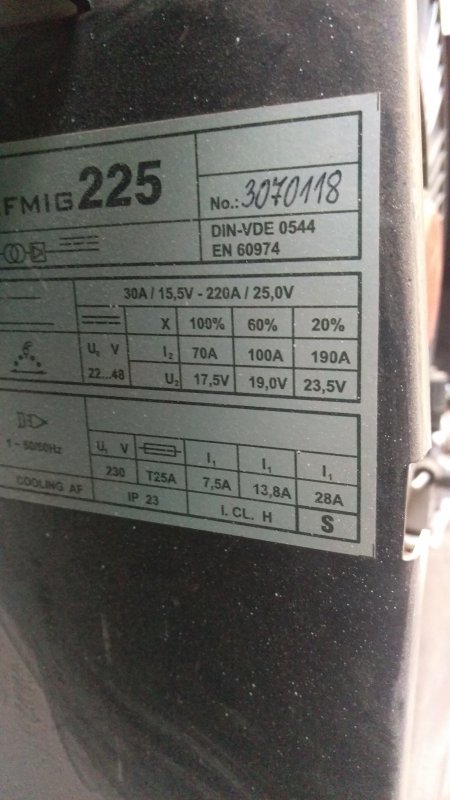

On 110v machine will have less powerI still don't understand this...all the info I can find about your machine says it's a 230V machine...I can't see how it will will work on 110V and definitely can't see how 110V will give you better results even if it did work.

from what you said before you said it had a 110V plug, but then was changed to 240V and thats when the problems started, and now you have changed it back to 110v...then said you got 110V and 240V mixed up? if this is the case and you were running that machine on 110V you have found your problem...
if it now has a 240V plug on it, fire it up and see how it performs..
