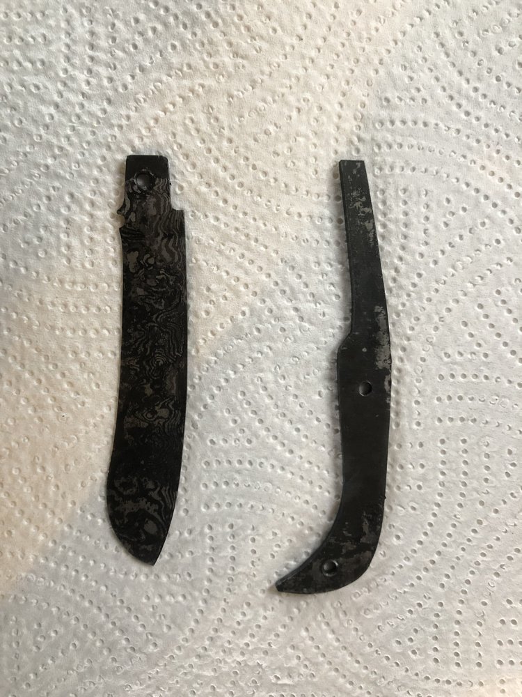

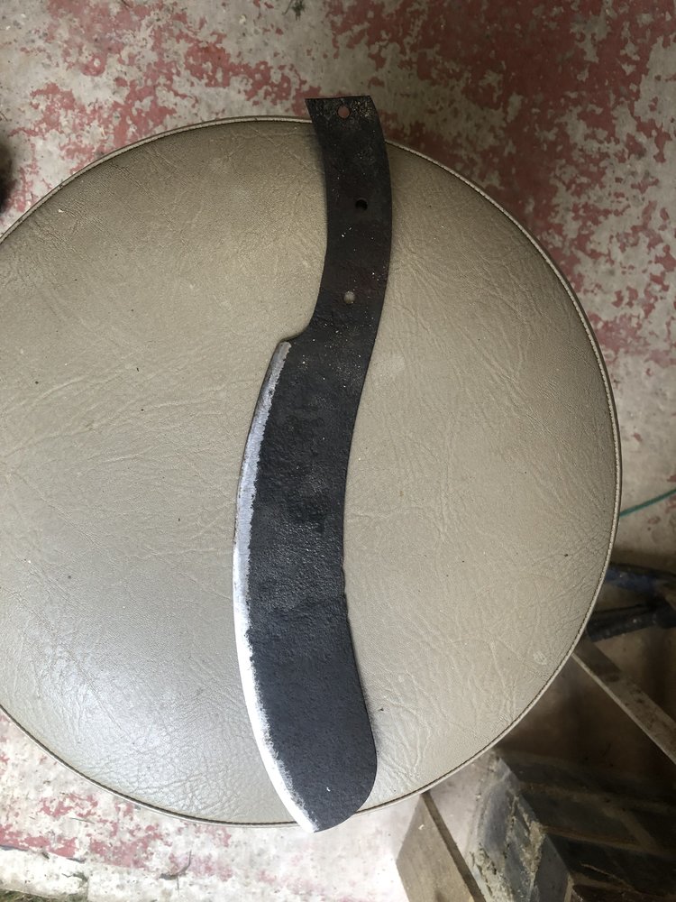

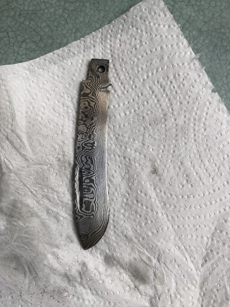

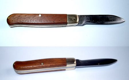

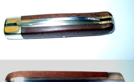

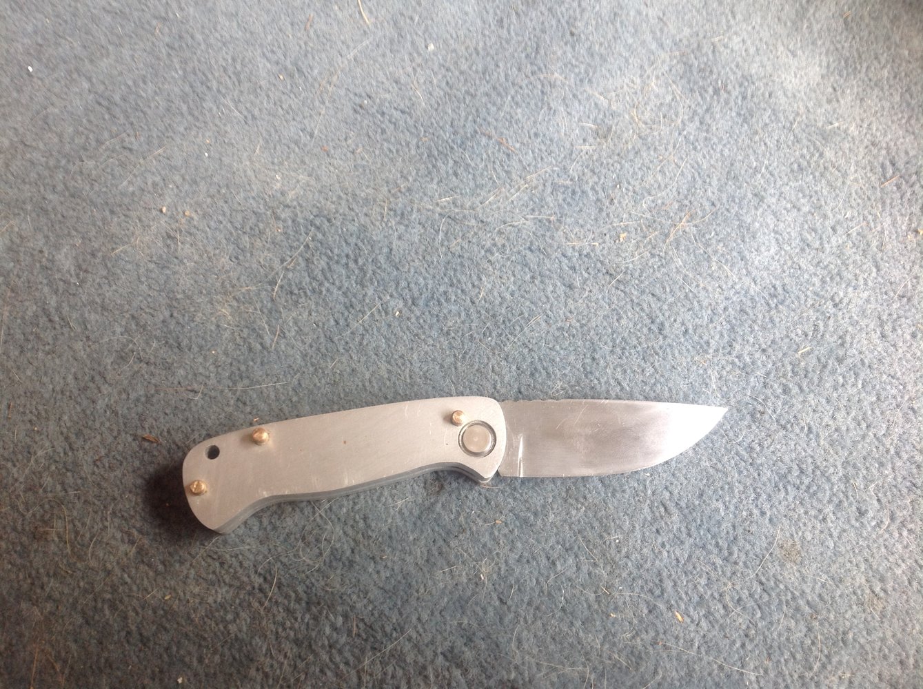

That's cool, here's one I have just hardened and is about to be tempered. I snapped a spring on one yesterday so I'm going to torch temper it so it's a bit less brittle.One I did a few years ago for a project someone was running from Sheffield University. They showed you how to make a knife and you made one and sent it in to them. This was my second attempt and was a tiny pen knife only about 3" long altogether.
View attachment 304618 View attachment 304619
I posted in the wanted section for a little dovetail cutter to cut the nail nick because this one isn't the best. I used a stone dremel attachment I dressed to a dovetail shape in the drill press with the blade in the vice but it wasn't very crisp. I should have just used a dremel slitting disc I think. Any ideas?
