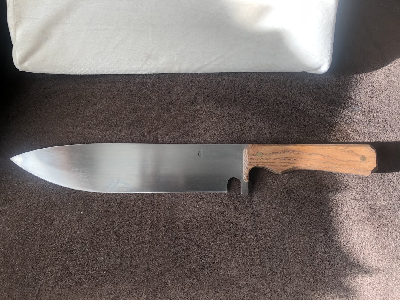

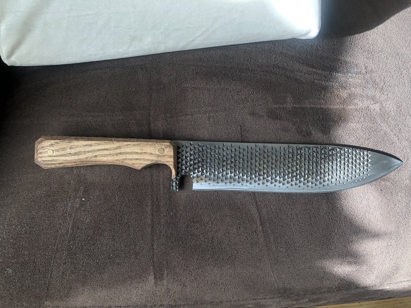

Does the U shape cut out have a purposeBack to knives, here's another chopper I've done in the last few weeks from one of @hotponyshoes rasps. Took a fair bit of surface grinding to get the teeth off the rasp on one side.
I like the fish de-scaler side .Back to knives, here's another chopper I've done in the last few weeks from one of @hotponyshoes rasps. Took a fair bit of surface grinding to get the teeth off the rasp on one side.
Bottle opener ?Does the U shape cut out have a purpose
Just a large choil to make sharpening easier, the handle side of it acts as a guard.Does the U shape cut out have a purpose
Thanks....Ive also learned a new word....choilJust a large choil to make sharpening easier, the handle side of it acts as a guard.
I find that if the choil is big, it catches on stuff I’m cutting
I was about to ask why they were left on the one side
Me too
You'll be talking carcasses though?

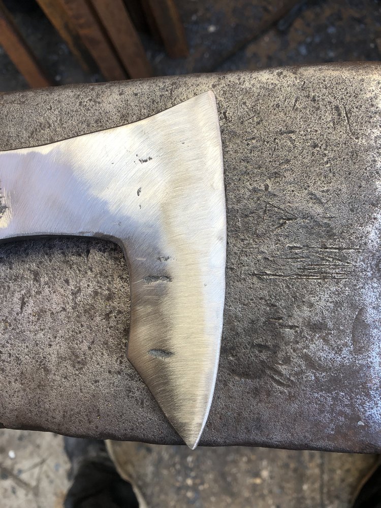

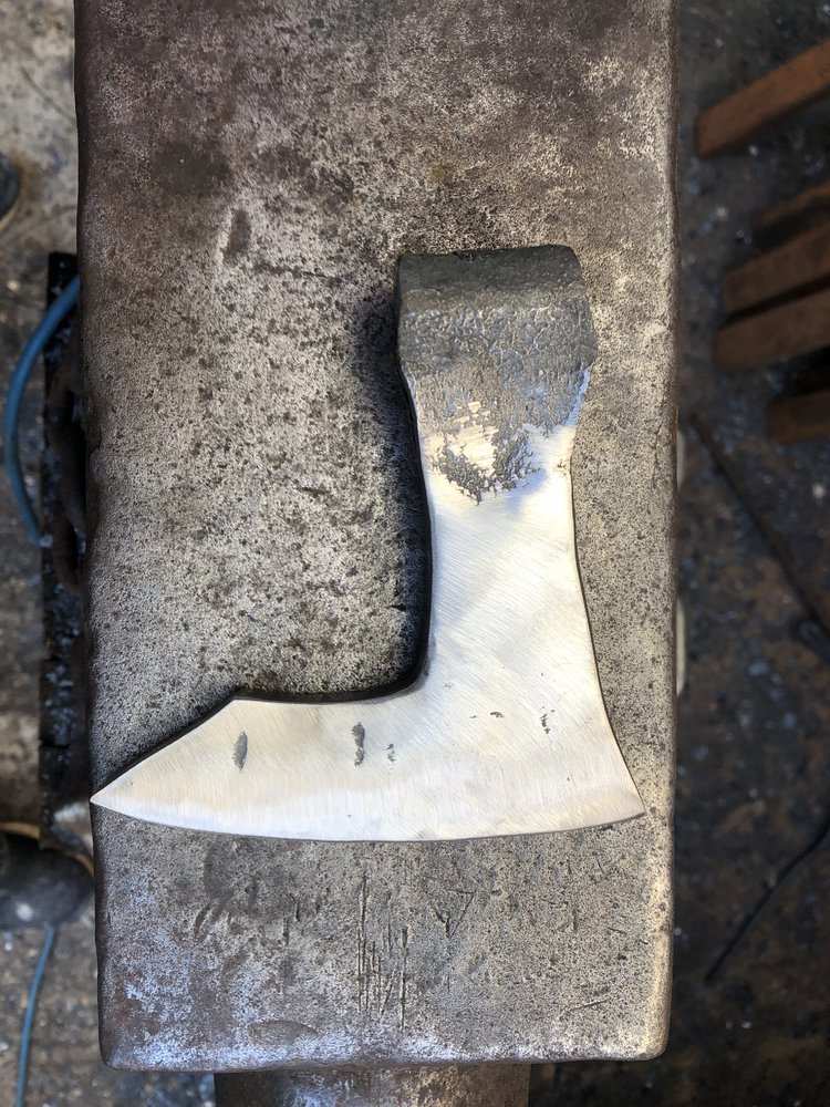

Yesterday evening decided to finish off some no spin throwing knives that have been kicking about for a while now.
They are cut out of "annealed" quarter inch truck spring.
Being quarter of an inch thick (!) they need some substantial lightening holes in the handle for balance and to stop them sinking an inch deep in the target board.
It was a disaster! They are not fully annealed and my spurious collection of random drill bits won't touch it. It may be work hardening but on one occasion I ended up with a huge dimple pressed through one side where the drill bit just wouldn't bite. So I chucked it in the forge and punched the holes through with a drift. Yeah, ugly as sin and I'll have to open up the holes with a cutting disk. The other three blanks went into the forge, red hot and two left in there to anneal, one dipped in a bucket of vermiculite.

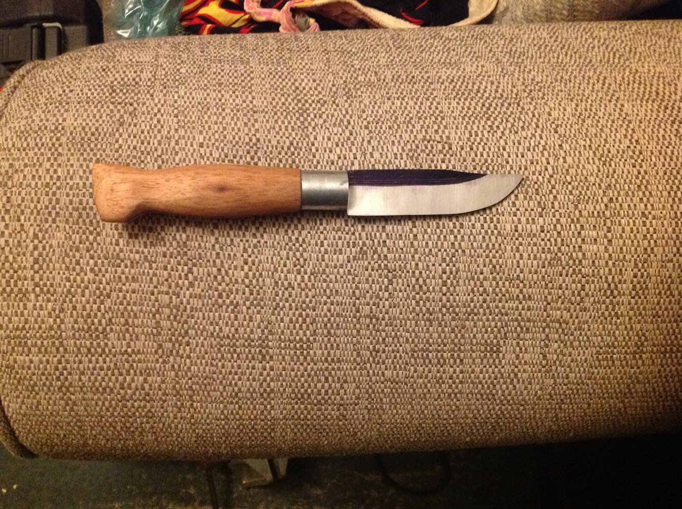

While I was doing that, it occurred to me I better finish this off so that I can claim it to be my first knife. Heat treated, O1 toolsteel, quenched in chip fat oil. Still arrow straight.
It is a copy of a Gough custom because I just love the look of the blade. It went glass hard so tempered in the oven at gas mark 6.
Reason I lost interest in this blade is I have two "precision" holes for fixing the scales and a load of "random" lightening holes.
...I stoopidly drilled two random holes right in front of the handle where it will show unless I extend the scales to cover them up which will make it look "bulky".
I'll do it anyway, not exactly an EDC anyway, no one's going to see it except you guys.
