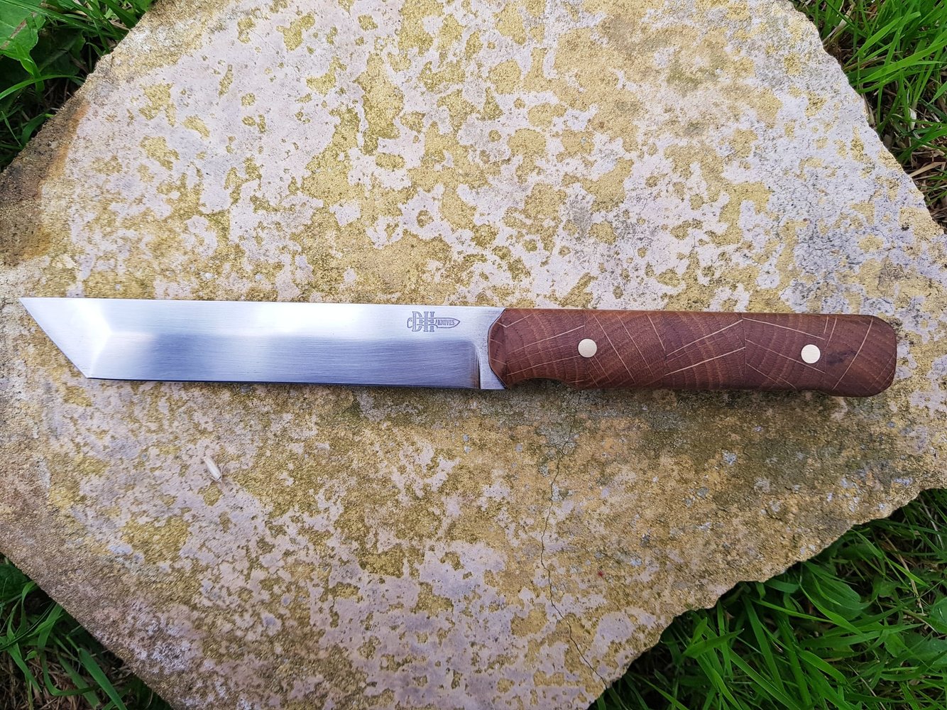

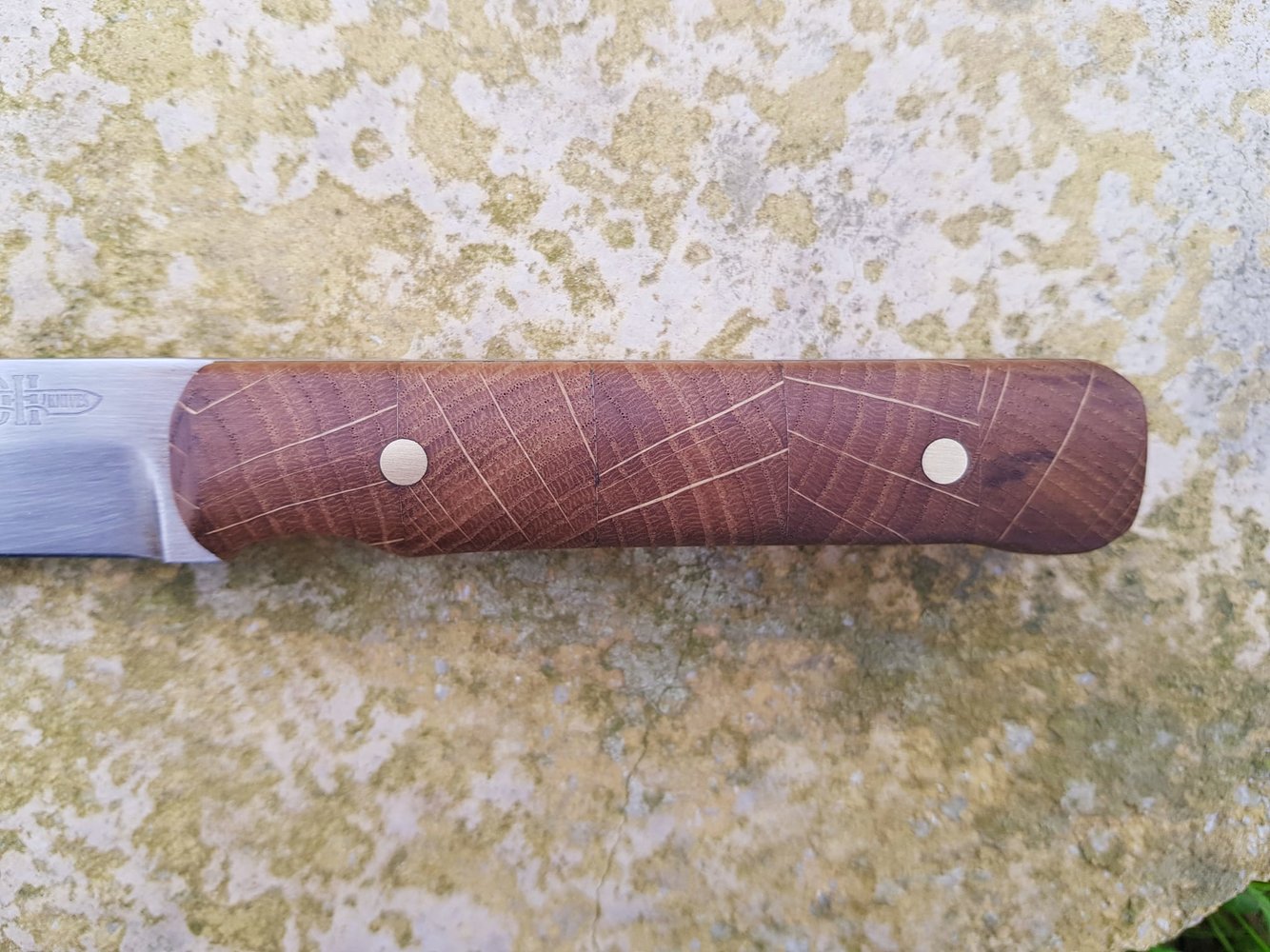

The blade and handle are top qualityNew tanto finished today
Super pleased with the handle. It's actually old oak looting cut up into blocks and glued together, then cut in half on the bandsaw, brass pins then hand sanded to 600g and I I shed with linseed oil. I love the end grain.

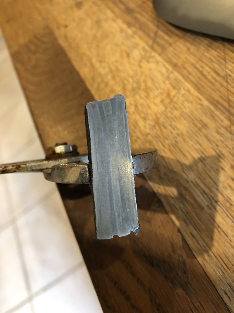

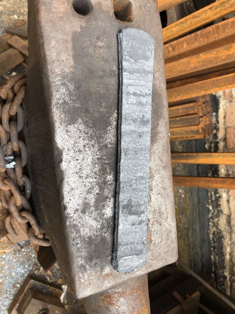

maybe Martempering would do it......ideally though you need to know the grade of steelNext step is to up my game a bit, so I have been experimenting with the san mai technique. This is mild steel outer layers and leaf spring core. It forge welded up perfectly as you can see where the steels welded in he photo but when I quenched it developed a huge shear right down the middle of the spine. Not on the weld, right through the core of the leaf spring. I've read this is because as it is quenched the carbon steel expands and because it has nowhere to go it shears itself. An edge quench is supposed to cure this.

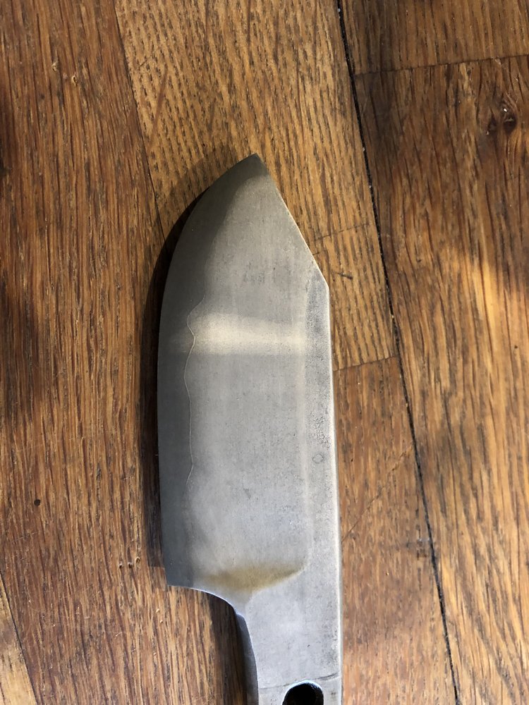

I thought I would grind it and finish the blade just to see how it comes out and this is it after 2x20 minute etched in ferric chloride. I'm trying a coffee etch now.
I had seen something about ghat but not read into it, that's a good link, thanks. I still have half of the billet left so I will try that when I next have a chance.maybe Martempering would do it......ideally though you need to know the grade of steel
Martempering/Marquenching - Hardening and tempering - Bodycote Plc
Interrupted quenching of steels typically in a molten salt bath, at a temperature just above the martensitic phase. The purpose is to delay the cooling for a length of time to equalise the temperature throughout the piece. This will minimise distortion, cracking and residual stress.www.bodycote.com
Any time before I quench I do at least three normalising cycles, more if I have been forge welding. I made an axe which I have posted before which was exactly this combination, mild steel outer with leaf spring bit, it heat treated perfectly but I did only do an edge quench.Another technique for reducing the possibility of splitting would be to do a couple of normalising cycles. Take the whole thing up to a good red heat (after searching for some recommended temperatures from the obvious sources) then just let it air cool. Another tip would be to heat the quenching oil before you lob it in there.
