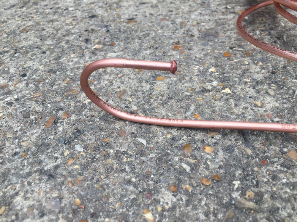

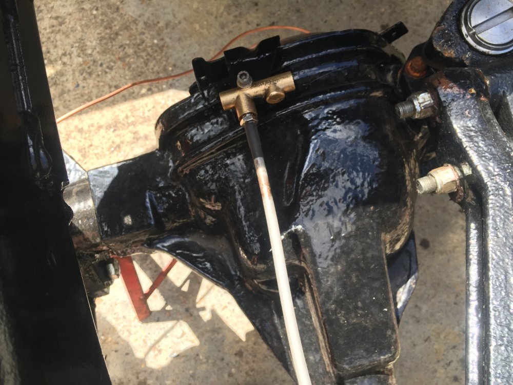

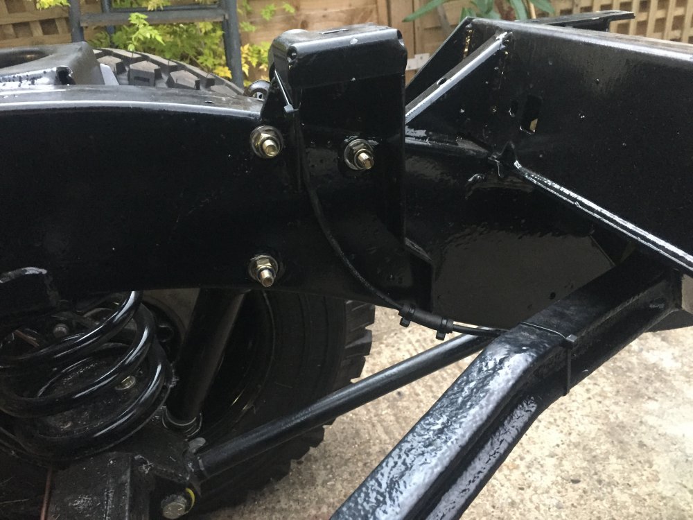

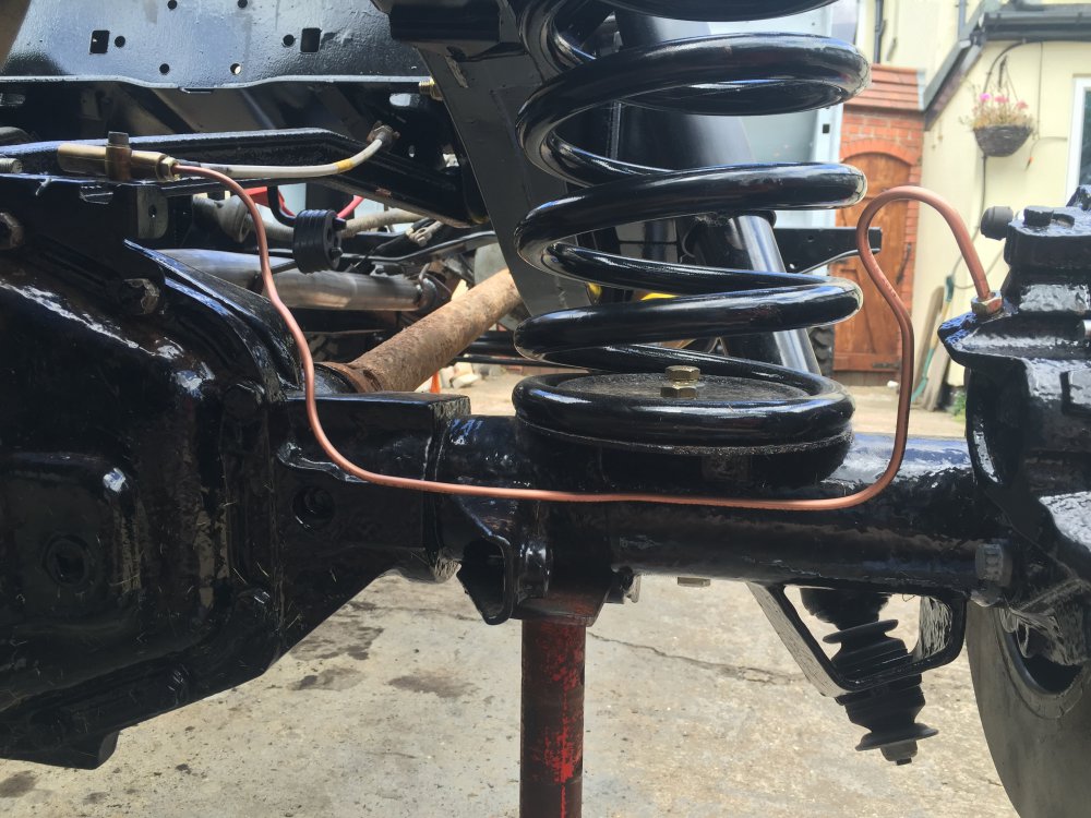

luckily the pipe cutting tool allows me to cut just behind the flare making it much easier, I did do it about another two times though

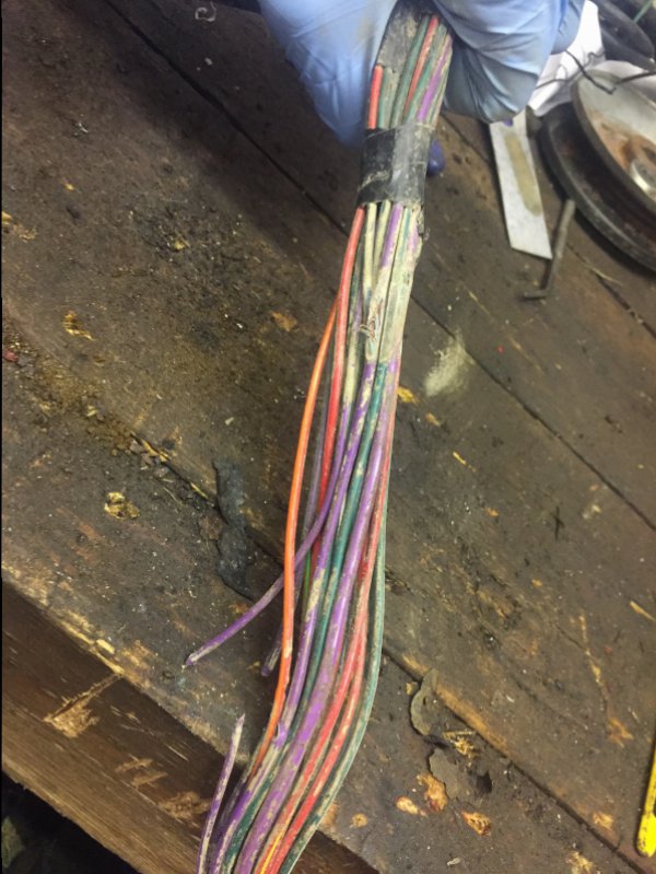

anyway got that sorted and on with the other side done. Just need to buy some more clips Okay I'll go to a shop and try get some thanksKim, a decent active flux will remove an amazing amount of oxidisation. How much would a new loom be? In fact are they even available?
I've been doing exactly this. Unlike before I will be able tying it tight to chassis or something and in a way it's not going to do this again and won't have any way to move. Also will be shortening the tow socket loom as its way to long currently. That should reduce the amount of loom lying around.Soldering the loom should prove to be a good short-term fix but you might encounter problems later on because you're creating a hard spot in a flexible lead. They tend to break at the end of the solder joint especially if there's a lot of vibration. Make sure the repaired section is thoroughly supported so there's no movement. Some self-amalgamating tape would be a good idea to re-cover the loom wires and keep out moisture.
On wires that have been abraded like that and exposed to the elements I usually try going a couple of inches further back on each wire to see how far the oxidation goes then add a fresh section. Sometimes easier to replace a whole length if you have the correct colours.
