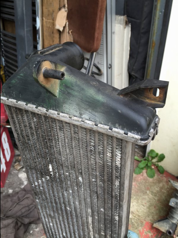

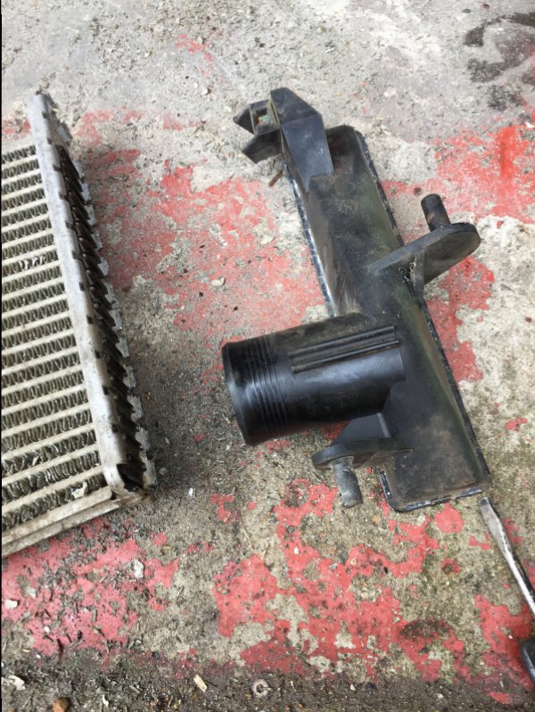

Yes I looked into repair also but I paid £30 for both delivered. To spend 30mind switching the caps over I'm not fussedAt least you could repair it, the radiator in my Freelander started leaking so I took it to my usual repair place and they said it wasn't worth trying to repair modern radiators due to the way they are made but they did sell me a replacement a lot cheaper than I could find elsewhere.
not sure how I'd pressure test it ?you can nip the tabs up with a pair of mole grips Kim might have been an idea to put some RTV sealent on both sides of the gasket too
i would pressure test it before fitting if you can
Brilliant idea. Never crossed my mind. ThanksThe easiest way is to get an inner tube for a bicycle or maybe motorcycle tyre and slice it opposite the valve stem, seal it on the inlet spigots with jubilee clips and pump it up.
