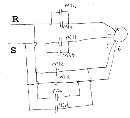

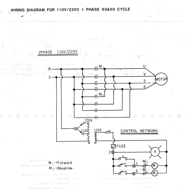

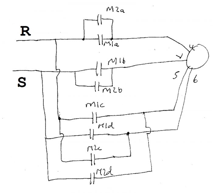

eil: ref your comment about the start and run windings. Earlier checks I did showed that the two black wires going into the windings had a resistance of 70ohm and were connected to Z1 &U1 and the two red wires had a resistance of 93ohm and were connected to V1 & U2. You are now saying that the two black wires should be connected to U1 & U2 and the two red wires should be connected to Z1 and Z2. It seems the motor is totally wrongly wired then and if so could never have worked!
