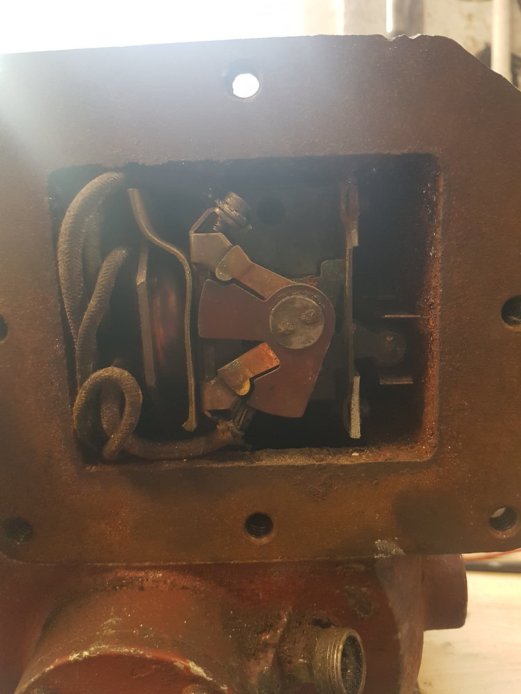

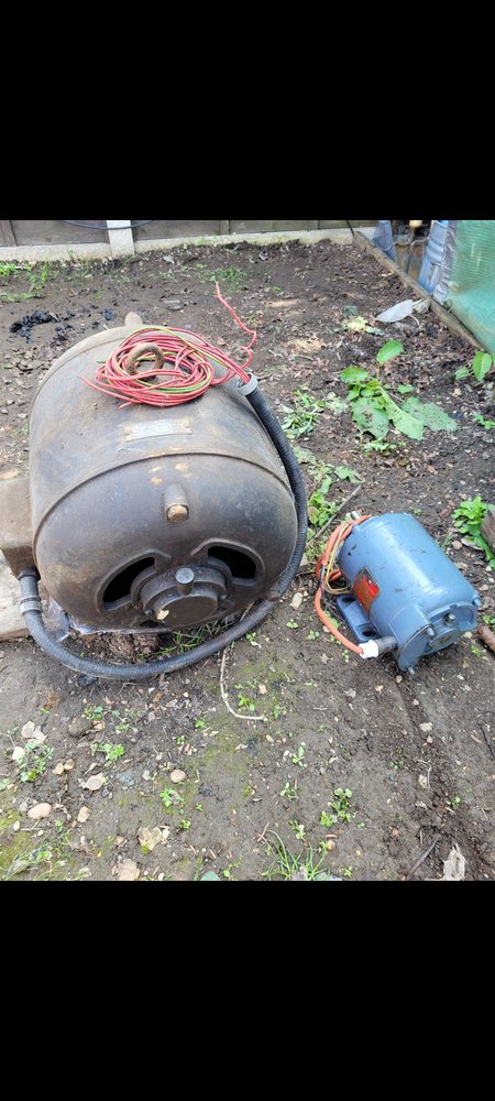

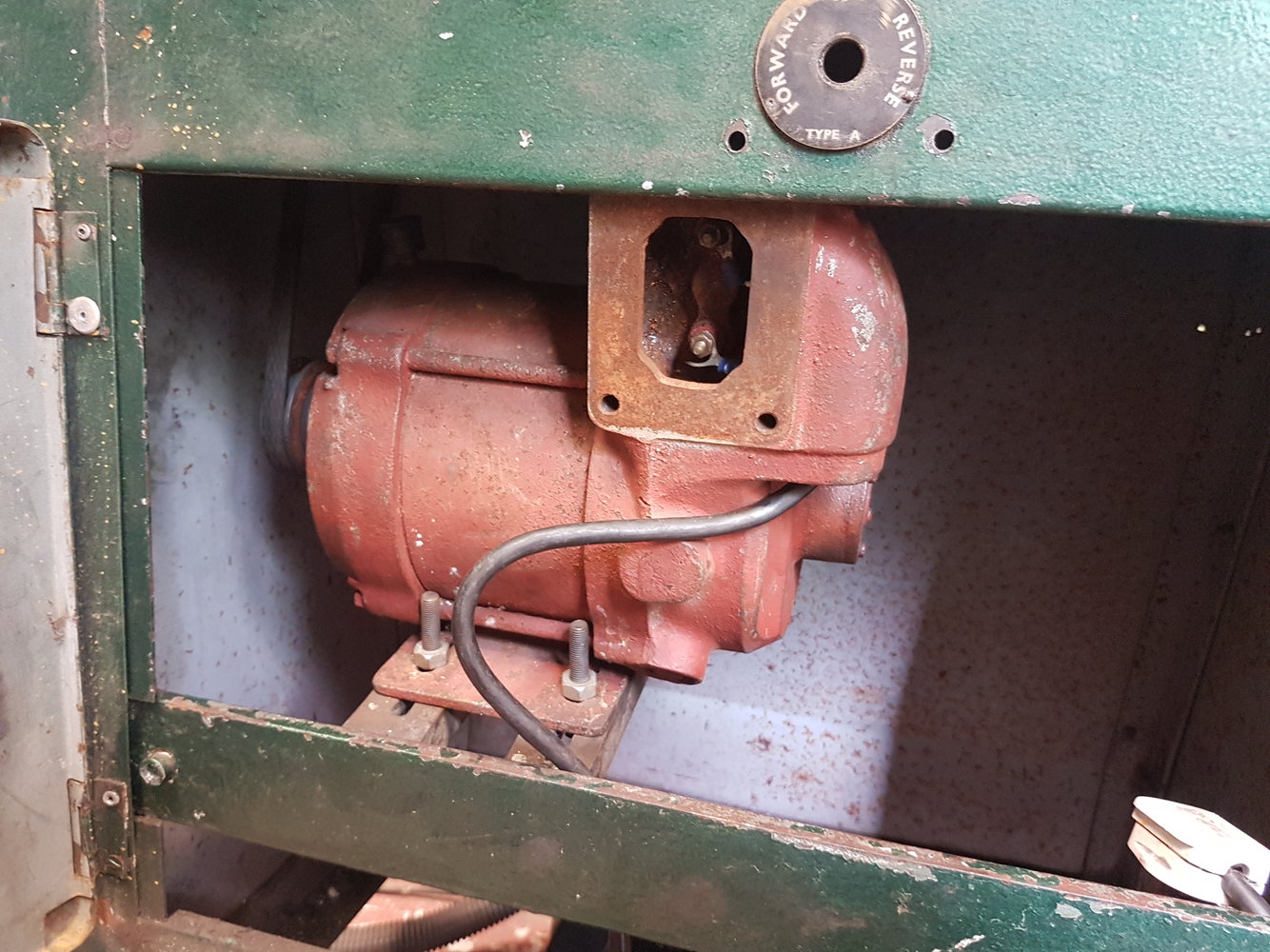

Yes the original set ups with motors can be a nightmare due the the weight and configuration of where it sits. A modern replacement is good. And a little extra on the hp is a bonus provided you don't go to excessive. With to much hp the first thing to go bang will be gears and screws.The only reason I'm already looking out for a motor is the one that's with it is heavy and doesn't quite fit through the opening due to the huge cast iron switch housing that's built I to it.
I'd rather pick up a spare 1ph motor for cheap than wrestle that thing back in!
Once it's all up and running and everything is good, I'll revisit the motor situation, along with dro's

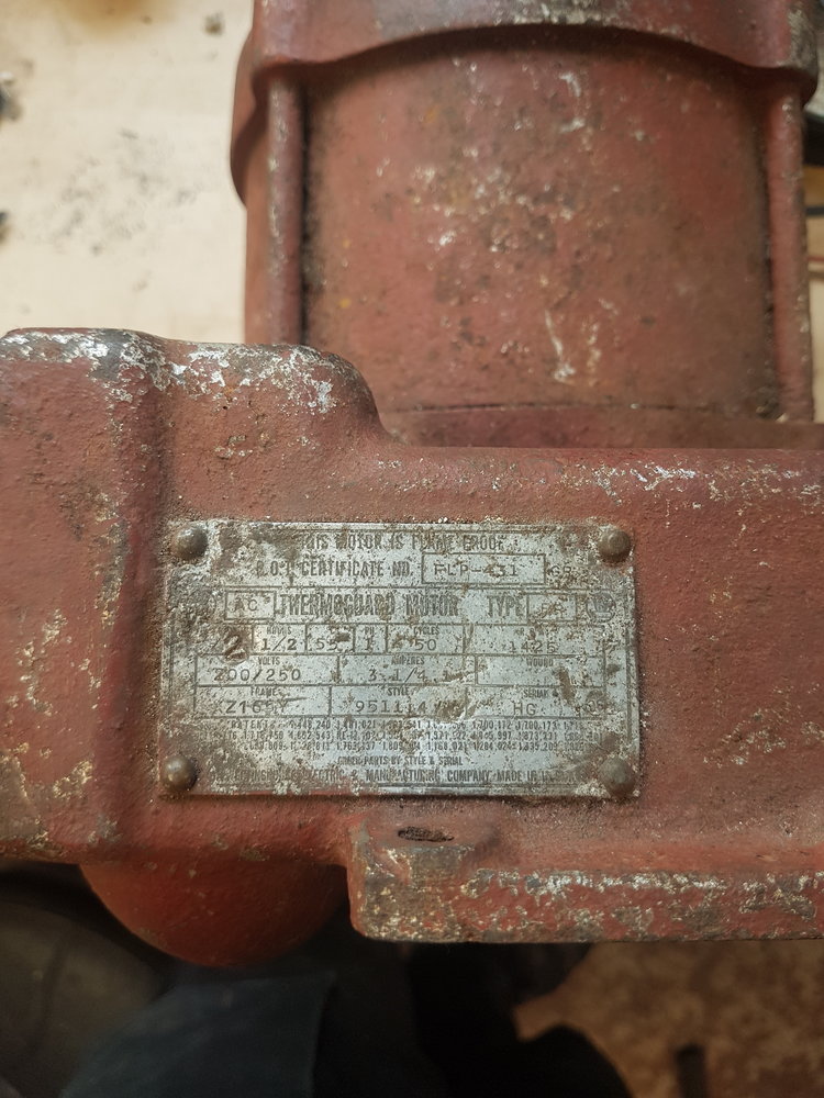

I be inclined to restore the original but that's just me. They did pack em in back then in the day and monster weightThis is the motor That's in it.
Can't believe how heavy it is for a 1/2hp motor.
It's fire proof, it's not original. The huge cast iron switch housing makes it very awkward to get in or out, there are no covers on the switch or terminal housings, and it grumbles a bit.View attachment 403305
It will do to get it up and running if i have to.

I'm half tempted to swap out the 1.5 hp on my lathe for a 3hp if you're interested.
It is three phase though
