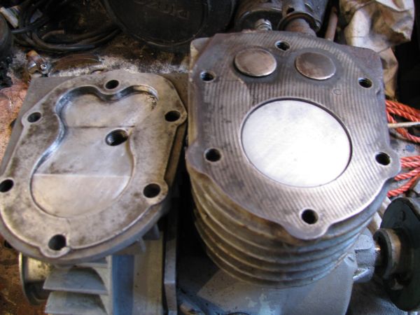

the pull start wheel was spinning so free that I thought maybe the con-rod was broken but after popping the sparkplug out we could see the piston moving. I thought it was 2-stroke but then noticed that it has a dip-stick. After removing the cylinder head I found it's a side-valve engine...haven't seen one of these since my old mates BSA (around a '54 model as I recall) and that must have been 30 years ago!

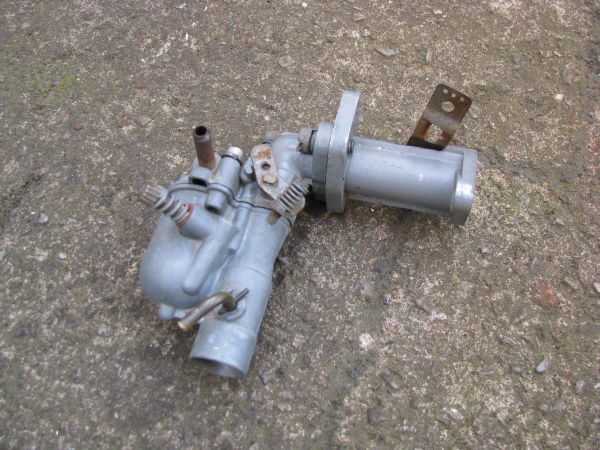

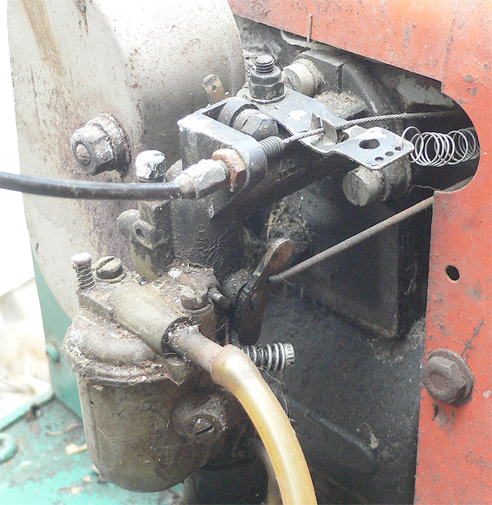

It looks to me like someone's played with it and not connected up the throttle cable to the actual 'valve'. The part that it was on looks more like an achor point on the manifold that was loose so it looked like the cable was actually doing something while the real valve is on the carb itself with nothing attached to it.
Anyhow, the engine's off the mower, we've got a decent looking chain and a centrifugal clutch. Looks like a decent stripdown and clean will get it running, maybe by next weekend.
I guess it's around 50cc but does anyone know for sure if it is, if it's 4-stoke, etc? Can anyone point me at a photo of the carb/throttle cables or advise on what it should look like? I've done a google search for 'suffolk lawn-mower' and 'E8103', the engine model number ,but haven't found anything usefull.
