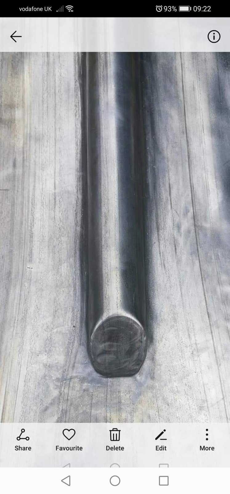

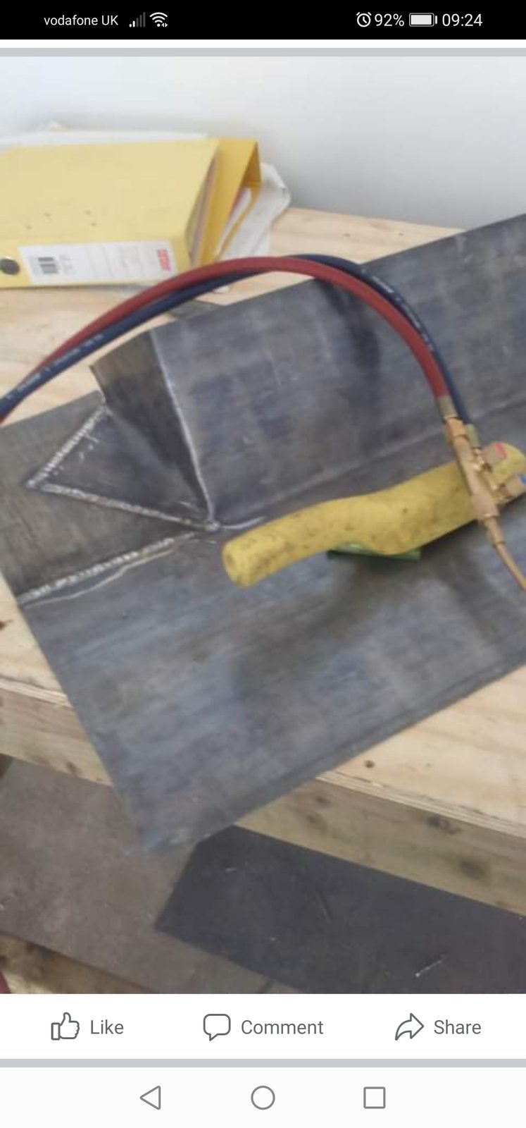

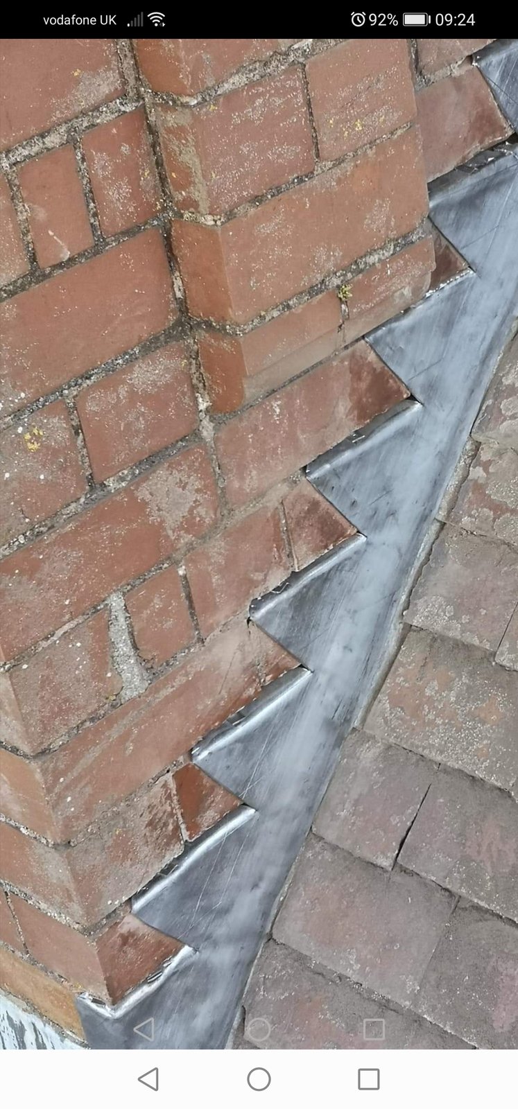

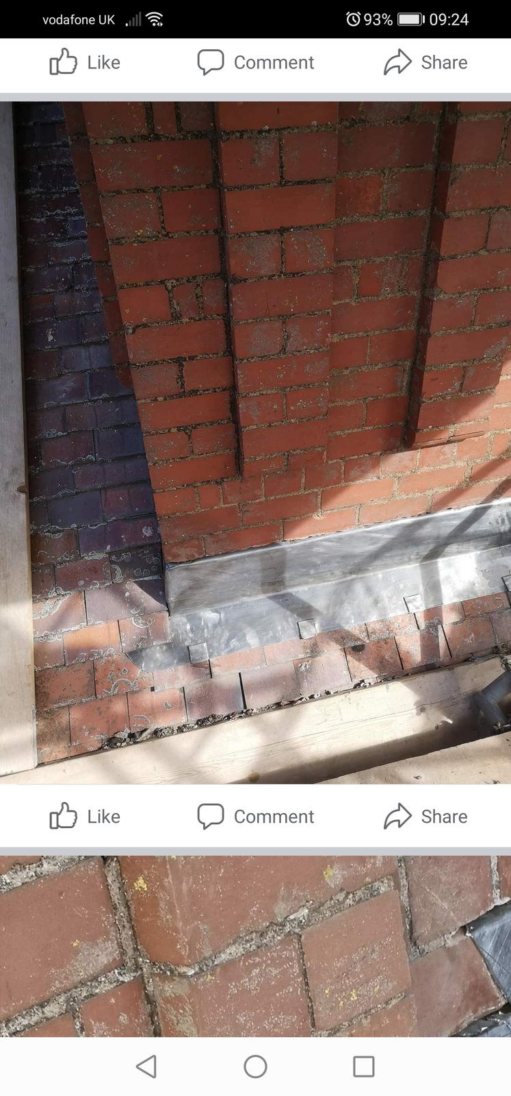

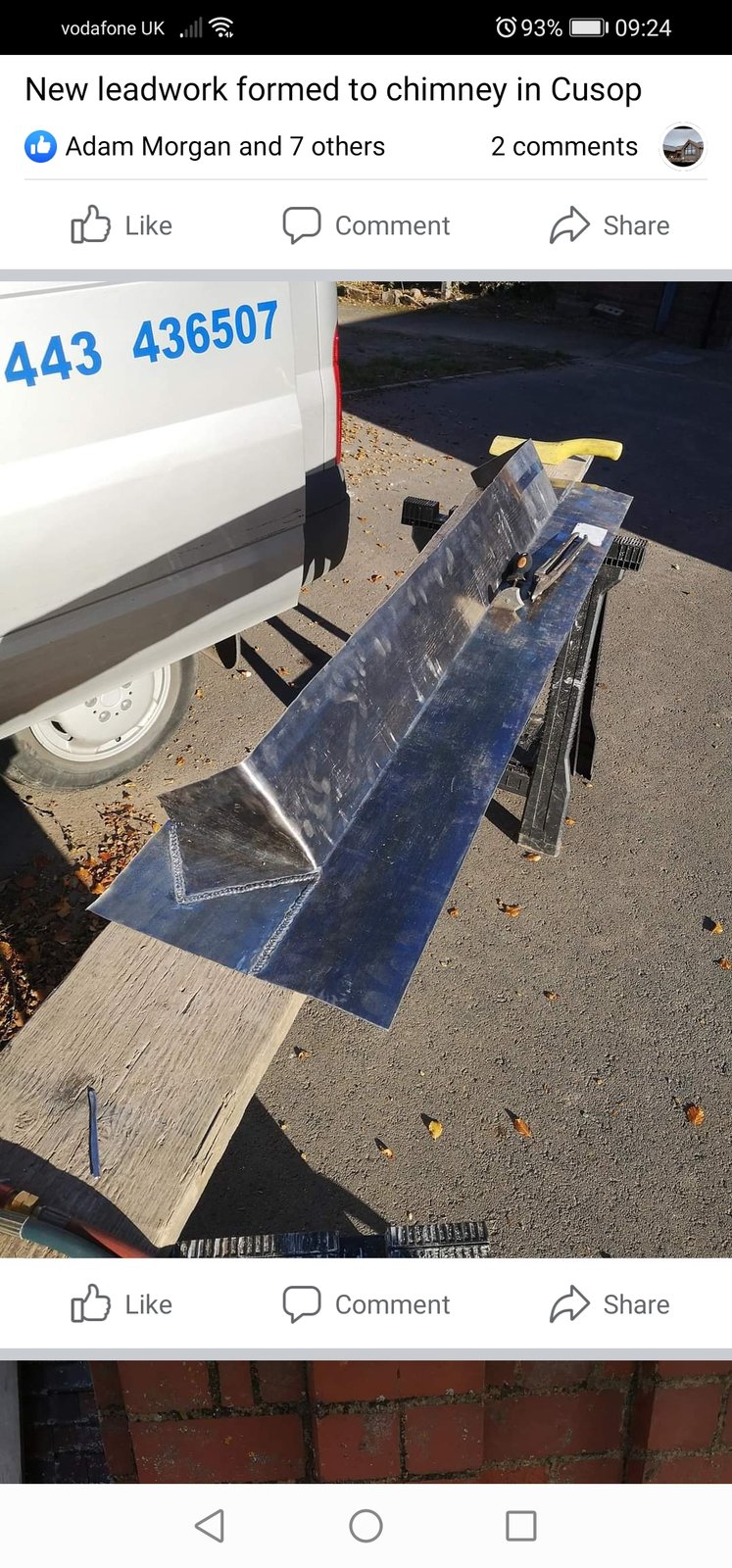

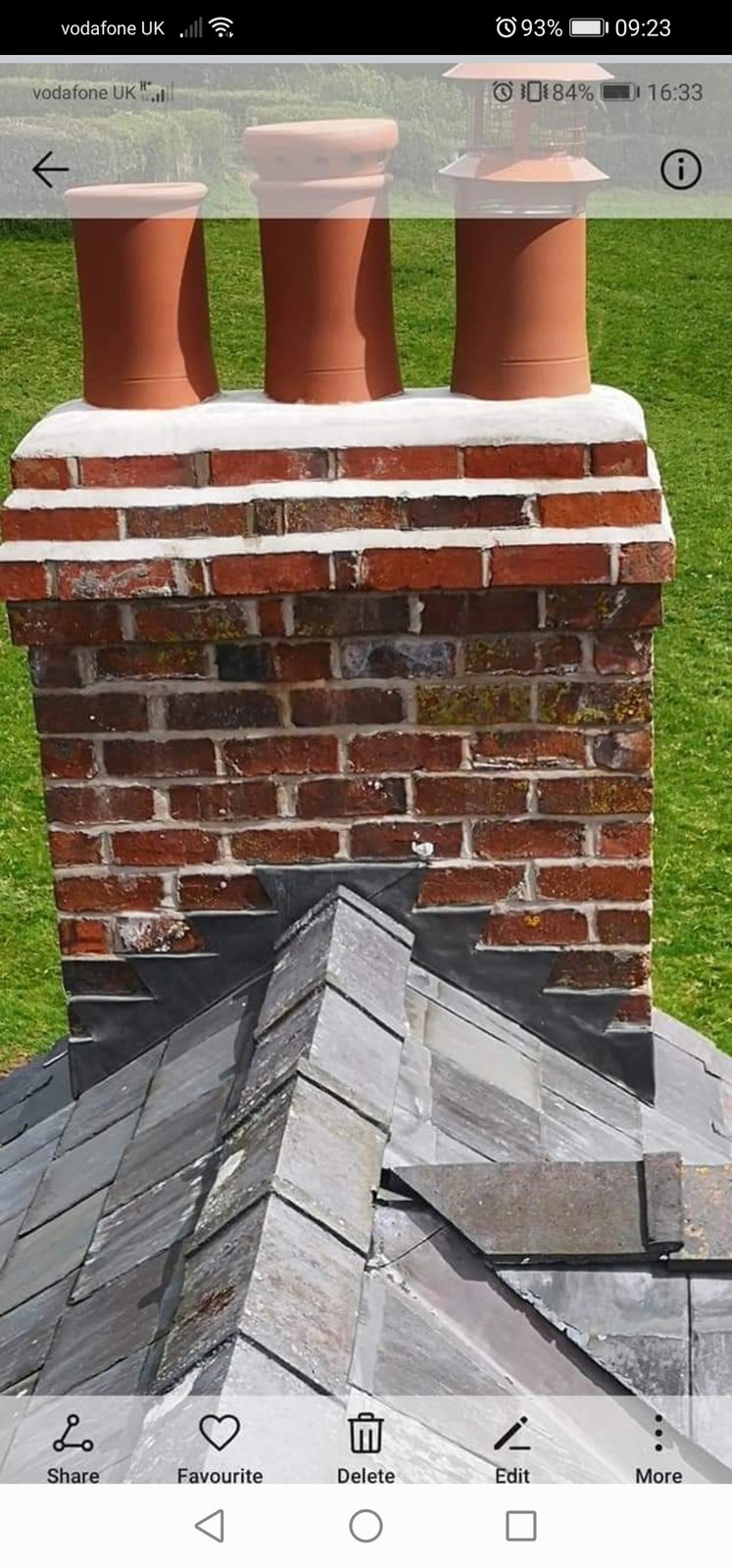

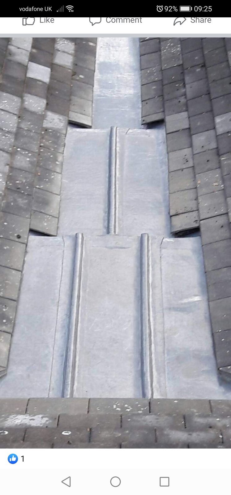

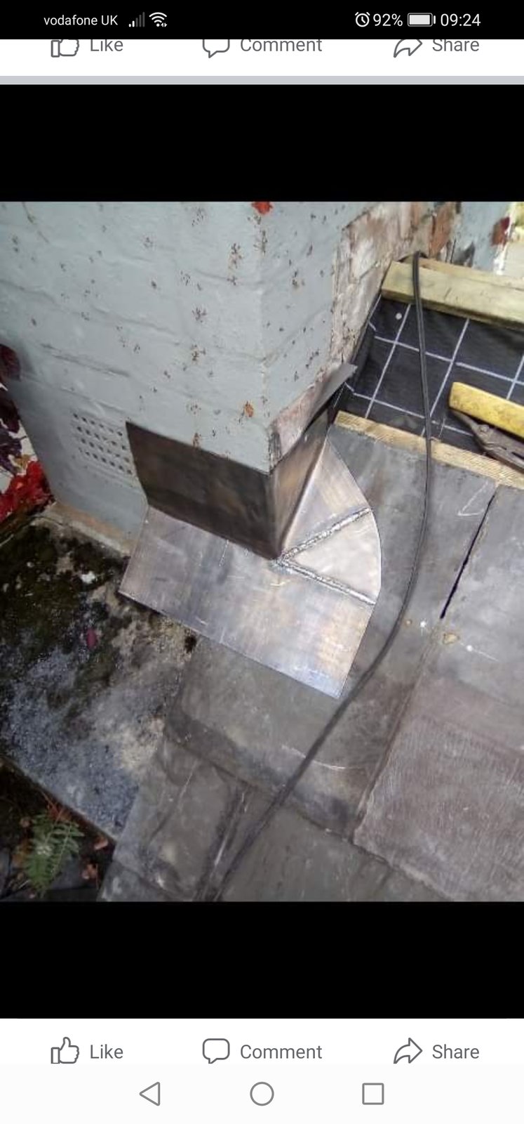

The reason most builders don't weld lead is that they don't have the tools or skill. It was only ever about 10 per cent of Plumbers who could lead weld. If you think that a Bossed and folded chimney tray is superior to a welded one.............................why did they bother welding them? To avoid stretching the lead, that's why
Don't tar all of us builders with the same brush!
