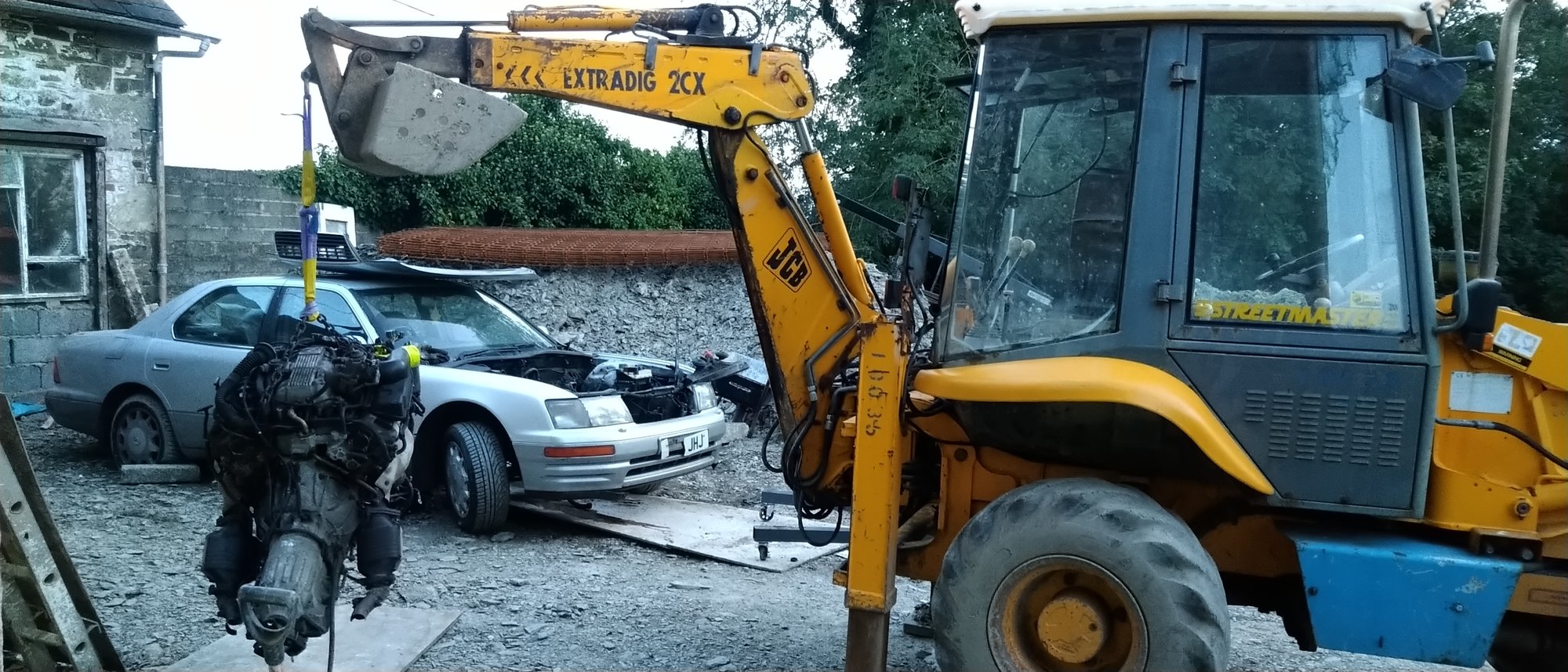

I got a 1UZFE and autobox out using the Clarke one. Ditched the handle and used my impact wrench to adjust it, though!
Still use mine with the mods I made - works easily and well.that sounds like a mod i need to do!! that handle is useless!

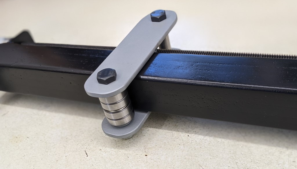

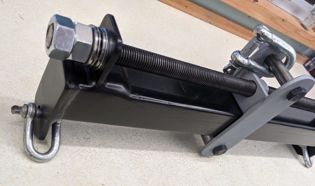

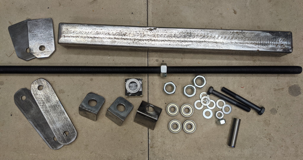

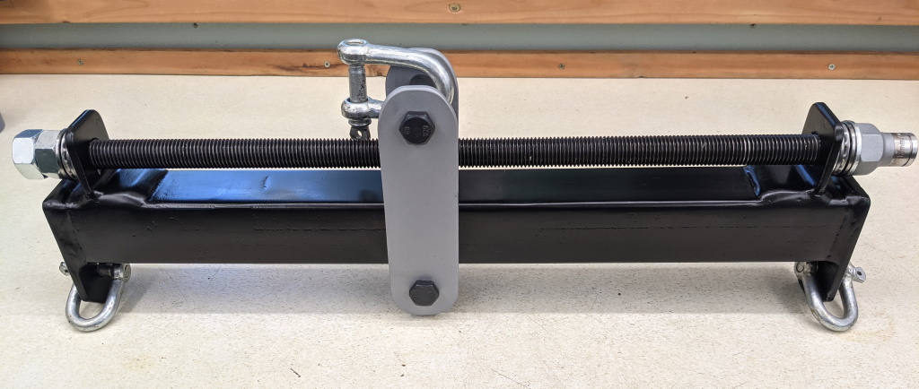

I really didn't want to make one. But ended up doing it anyway.
Despite having most of it in scrap, I reckon it still cost about the same as buying a cheap chinese one.
However, hopefully I ended up with something that works a little better.
Because the workshop is a jammed full disaster zone, I ended up having to build it outside on the ground, trying to MIG it up in the rain with a strong wind which was fun.
I suspect stick would have probably been a better choice, but I can't even see that machine. At least the MIG was almost accessible. That's my excuse anyway.

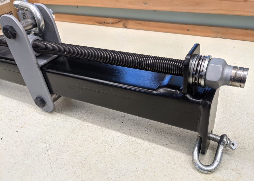

Box was a reused 50x50 gatepost and a bit scrappy, but all I had to hand. I'd have preferred thicker section, but this is still the same thickness as the engine crane boom. Bearings and thread I bought.

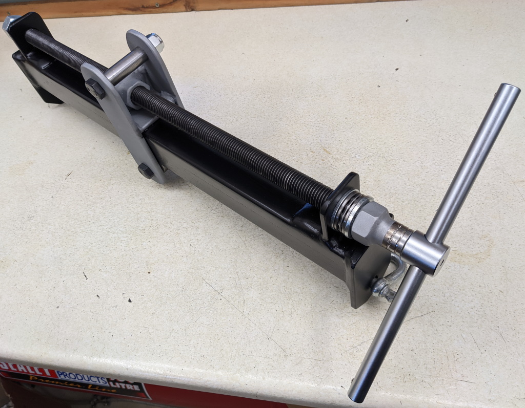

I used thrust washer/bearings at each end of the screw, and I found an old broken socket which I welded on so it turns nicely with a ratchet or T bar without any handles getting in the way. Or you can use still use a 30mm deep well socket on the captive nut.
The other end is just secured using double nuts so you can disassemble it or adjust the preload on the thrust washers.
I did a test before I painted it, and it didn't fall apart with an engine on it, so I'm calling that a win. SWL I guess about 500kg.
If I did it again I'd probably change the nut to some sort of floating design and come up with a better design for the shackle.

What threaded bar have you used there @MetalMonkey ?Those Epco cranes are nice bits of kit, but I just wouldn't have the room or the need to justify keeping one.

As for the load leveller, my usual preference is actually to remove the engine and box together with the subframe from underneath. I tend to find that easier than trying to lift the engine out.
However, on this particular vehicle the easiest way to do it is to take it out of the front. The bonnet has to come off, along with the bumper, headlamps, radiator, crash bar etc - the engine is then lifted slightly and slid out.
I removed the engine using chains, but it was already partly stripped.
The main reason I wanted one was to refit the engine fully built up - which includes a vast amount of very expensive or NLA plastic manifolds, pipes and fuel rails, all of which can get damaged if you try and lift it with just a chain.
The leveller acts as a spreader which allows you to clear anything fragile. The dealer workshop manual stipulates the use of lifting beam, the first time I've seen it actually specified.
In addition, being able to tweak the orientation will also be very handy as there is hardly any clearance either side, and the mounts are an "interesting" design which require a lot of jiggling about to get them fitted.
It adds around six inches to the height, but I could get most of that back by shortening the chain on the end of the boom. Not that I will need it as I don't need to lift it up to clear bumpers/wings etc.
If you were just rigging it with chain you would need to use long lengths to get them as vertical as possible for clearance anyway.
I suppose removing it was enough of a chore for me to appreciate the utility of having one for putting it back in.
I'm sure it’s possible to do it without, but I'm past the point where I enjoy struggling with cars thesedays. Anything that makes life easier is worthwhile.
I didn't really intend to faff about building one, but most of them are too short to clear everything. At least this way I was able to guarantee to avoid all the unobtanium plastic parts.
M20 10.9 threaded rod. Zoro supplied it pre-bent, but I managed to find a straightish sectionWhat threaded bar have you used there @MetalMonkey ?

Thanks MMM20 10.9 threaded rod. Zoro supplied it pre-bent, but I managed to find a straightish section
