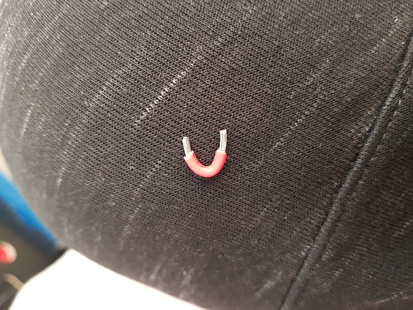

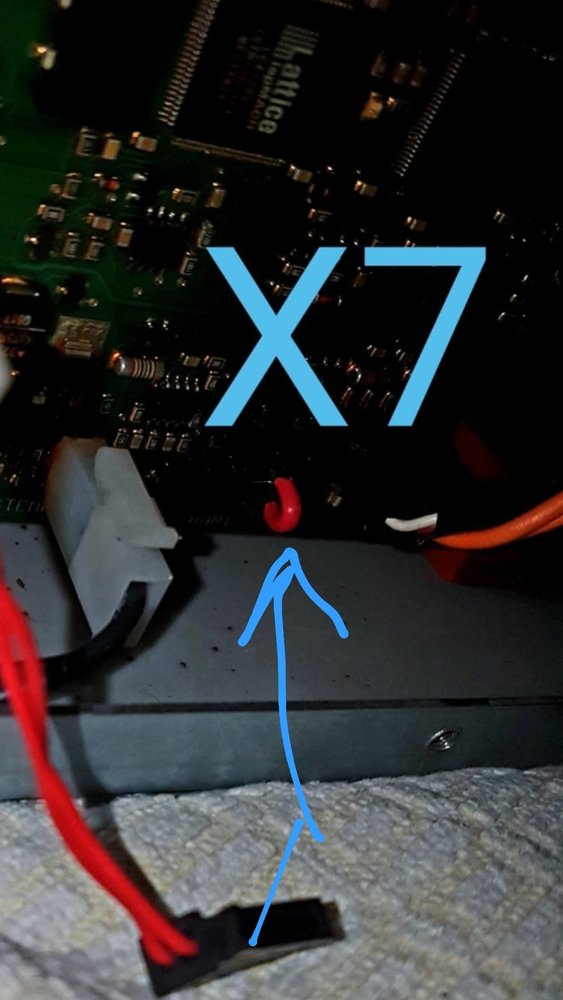

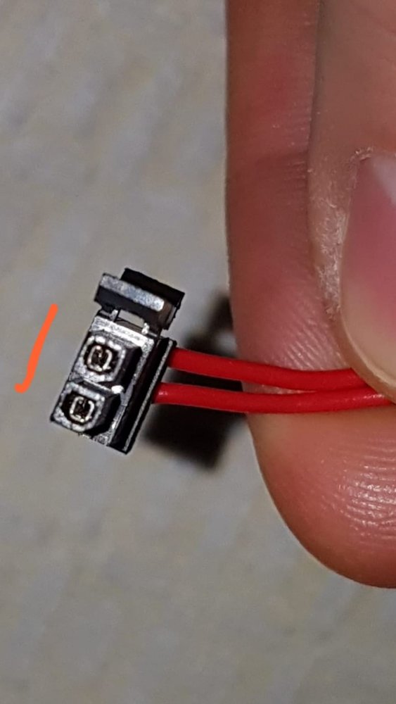

I reconnected the plug at X7 of the "Mapro" and as expected the fault E3 was back. Then I did the "Closed circuit test" with a small piece of cable between the X7 connectors. And the result of that was that the fault was gone.

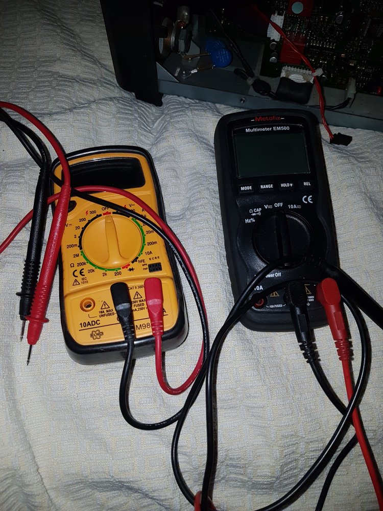

Also I measured the resistance at the plug that goes into the X7 socket with 2 Multimeters: 0 Ohm in both cases.
