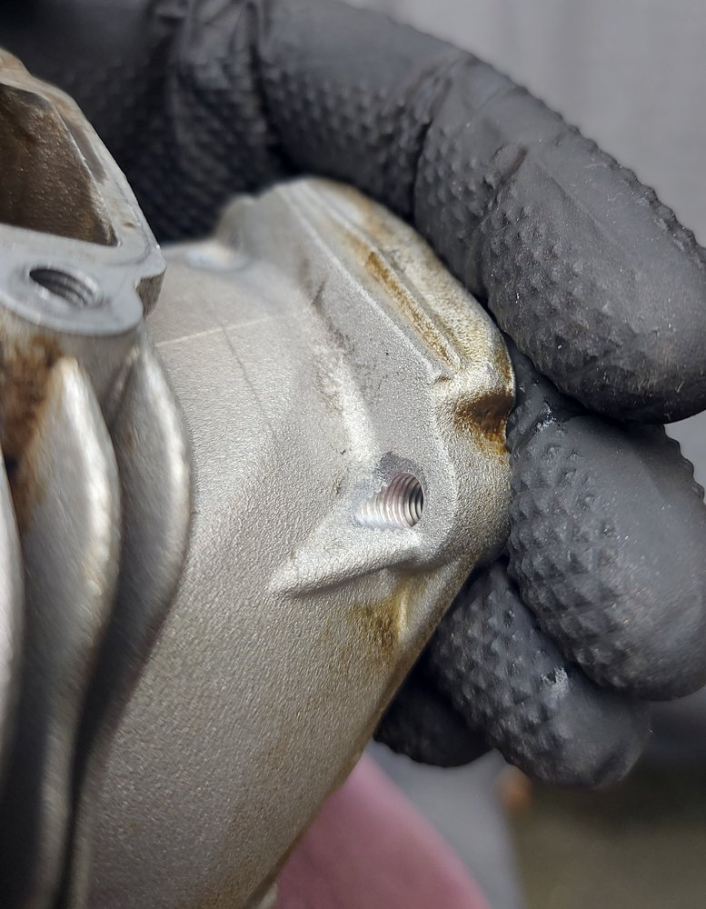

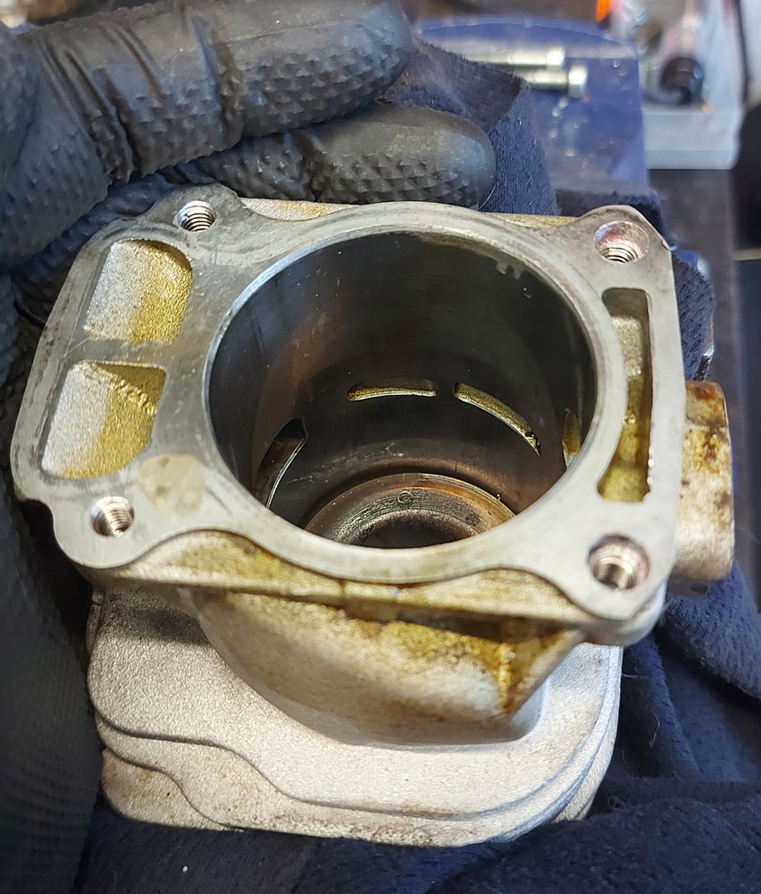

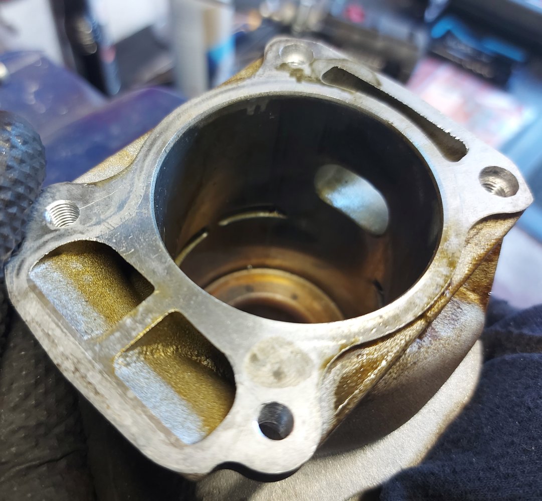

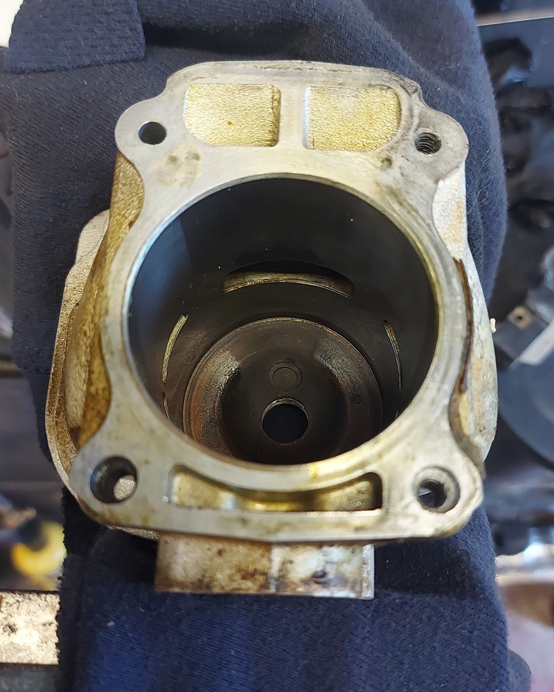

How about 1/4" BSW for that bit chunkier thread in the ali?
That would test my tap/drill/bolt collection out too much.
But I can see your thought process...
![Thumbup :thumbup: :thumbup:](/forum/data/assets/smilies/thumbup5.gif)
But I'm also in the just swap to M6 camp.
Then sounds like the inserts are the easiest way.Not so simple! In these later con saws the head bolts pass up through the saw body through narrow square holes within a plastic housing. About 5 inches deep. The bolt cap heads don't fit in m6 size.
Then an M6 thread would also require drilling out the aluminium engine housing to allow them to pass through same.
To me, in this instance that will cause permanent damage to the engine casings and if the heli coils don't work then I will buy a new aftermarket barrel which for the fuel injected saws is around £65.
Heathen! So you're the one who does things like that and cause problems for the next poor bloke 30 years later!

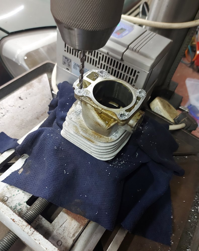

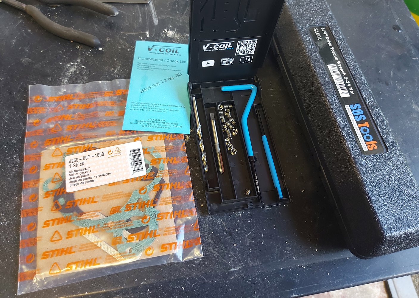

I was just about to post that, helicoils, then Loctite studs in with permanent stuff.Replace the bolts with studs, then you’re not ( occasionally?) having to remove the bolts from the alloy…
I've used EZ-lok inserts to repair manifold threads with good success, not keen on helicoils, I've encountered a lot that have just unscrewed when dismantled, or worked loose over time. Possibly not installed correctly, but the nice thing is you can drill up a size and still fit the ez lok style.
Looking at the size of the current bolts heads I’d think you could get nuts to sit where they do, with a slim socket to tighten them. Its worth comparing diameters.That gonna involve turning a set of four sleeve's up - to go thru the top - over the stud and put nuts where there is enough room - possible but not an easy/elegant solution.
Helicoils are only a problem when poorly fitted, apart from the most common not drilled and tapped square, not fitting the insert deep enough can cause problems, for an M5 head bolt in aluminium I would probably want 2 full threads showing above the intsert, especially important for something that will need to be removed and refitted in the future.
To keep the thread insert in place as best as possible for future bolt removal should it be required.I'm a little confused as to why thread lock is being used?
