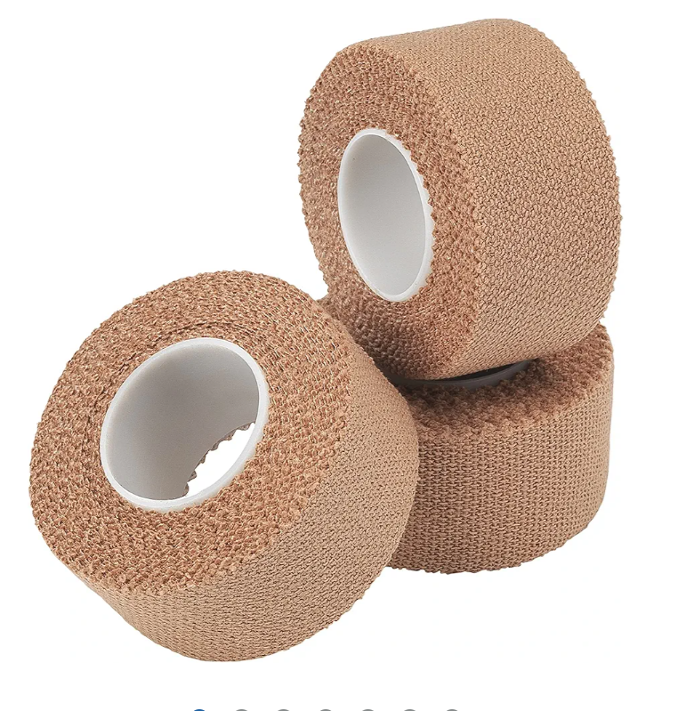

You will need some form of heated platen above the tape and a way of pressing both tape & belt on to an anvil till everything is cold . IIRC the melting point to achieve is around 86 oCI have bought some jointing tape from aliexpress, not tried it yet.
I will be using a brass plate drilled to take a rod iin my 35 watt soldering iron and using a reasonable quality infrared digital thermometer to locate the temperature ( I'll be keeping detailed records too )

Nothing as complicated as that for me. I will try a 20mm finger sander belt first, butt joint with a clothes iron as the heat source.You will need some form of heated platen above the tape and a way of pressing both tape & belt on to an anvil till everything is cold . IIRC the melting point to achieve is around 86 oC
