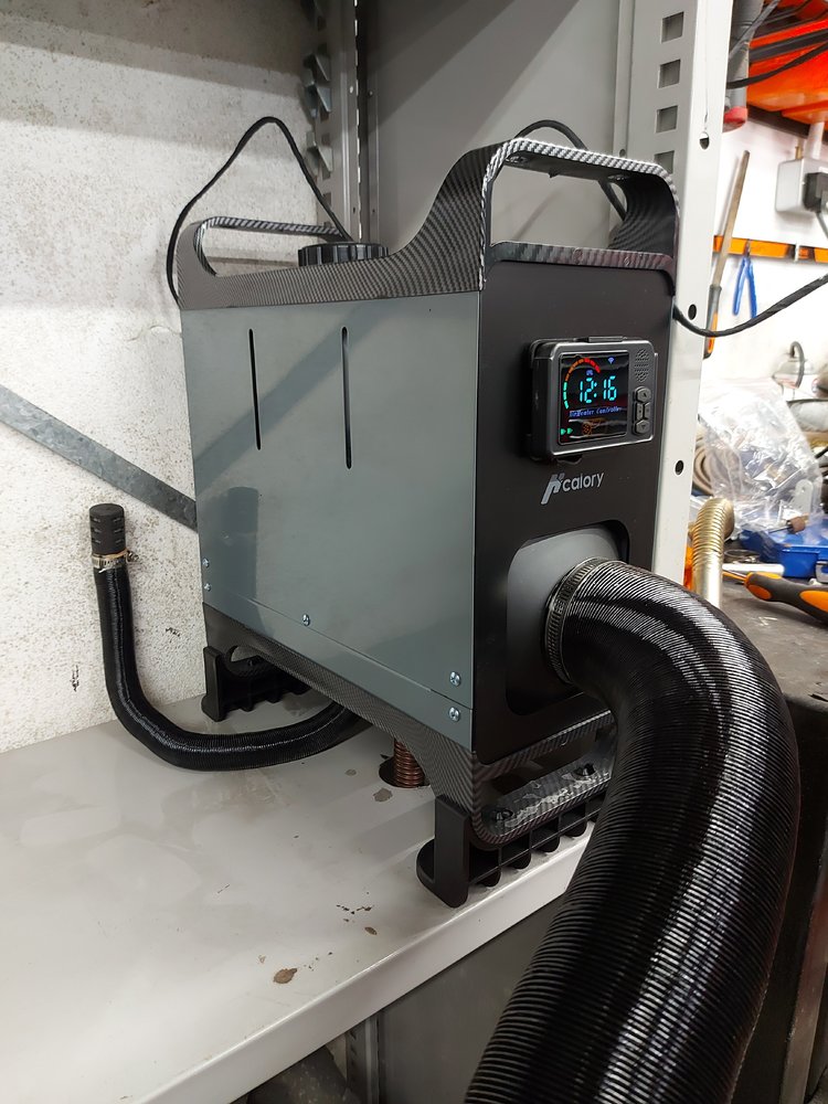

You need to draw cold air from outside for the combustion for a couple of reasons. First off cold air has more oxygen so is better for combustion and secondly as the exhaust must be vented outside there is no Net loss of air in the room. If you did draw the combustion air from in the room and exhaust to outside then you would create a small vacuum in the room that would suck air from outside through any gaps in the structure and get draughts.Drawing cold air in from outside not as bad as I thought.
I run 2 of these heaters flat out in winter. One recirculating the warm air. The other is outside ish and has just the one duct going inside for the outlet air. Not as bad as I was expecting. Not much difference in outlet temp.
If you are referring to the heated room air you should only draw that from in the room so that it can be recirculated and the temperature increased. If the air is drawn in from outside it needs more power to raise the temperature so the maximum temperature of the room will never rise above a certain (low) level. If possible the air input for the heater should be taken from the floor level by using a duct of some sort.
As for heat scavenging from the exhaust I extended my exhaust with 22mm copper pipe as it was the cheapest option which was a bit of a surprise. I then attached aluminium plates to it using 22mm copper clips and painted the lot with matt black heatproof paint. Over the 2.5m length I see a temperature drop of over 100 degrees before it exits the building so there must be a reasonable amount of heat given to the room.
I mounted my heater at high level to make this easier and have extended the outlet vents in two directions using plastic drainpipe. I fitted the 2m of heatproof tube that came with the heater before it gets to the plastic and I've only seen a little bit of distortion in the plastic after running the heater at full blast for a few hours for a test. At some point I will add a low level intake to draw the cold air from floor level but that is at the back of a long list of things to do.
My garage is 4.5m X 12m and it can get quite warm in there so I'm reasonably happy with the setup. I'll add a few photo's tomorrow
